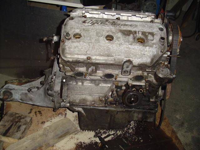

As I´ve mentioned in the old forum I´m in the middle of putting a 3.0QV engine from a 164 in my ´83 GTV6.
I´ve decided to use the Motronic instead of the stoneage L-jet, wich doesn´t make it easier! Still working on getting it conected. (Will greatfully take some advice here) :D
I´m also gonna use the 164QV runners and plenum, wich results in some modifications.
In this thread I will post some pictures of the work so far and fill it up as work goes on.

Well, this is a quick runthrough. On the second day after starting the 3.0 was in place.
There´s stilla lot of work to be done though. Had to take the head of last night to change the gear to the oil pump/distributor, since it´s faster spinning on the QV engine. Doesn´t make wonders with the timeing when the dizzy does 1,5 turms when the rest of the engine does one (1). :?

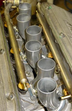

My 3.0L 12V is installed and running in my 85 GTV6. Here are a few photo's of the process. I made new intake runners, bored out the 2.5 plennum and made a new intake with K&N filter. I used the 3.0L injectors and installed Megasquirt.

New intake runners
New intake runners
