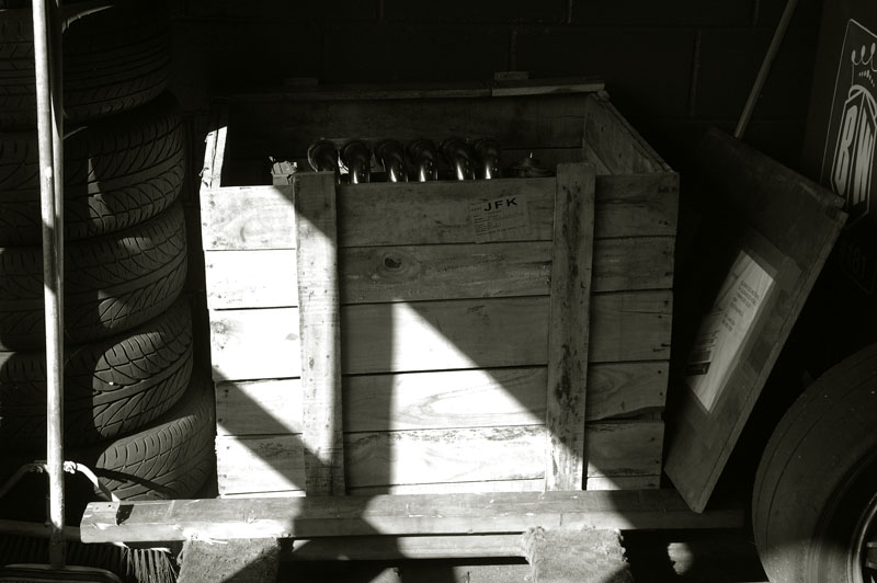

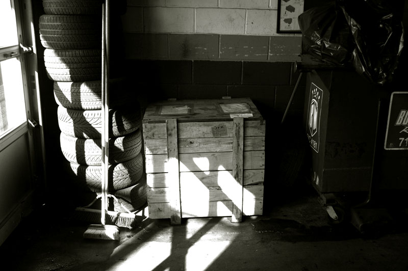

- We also received a mystery box from JJ
- crate_BW.jpg (107.64 KiB) Viewed 9303 times
- crate_open01.jpg (104.75 KiB) Viewed 9302 times

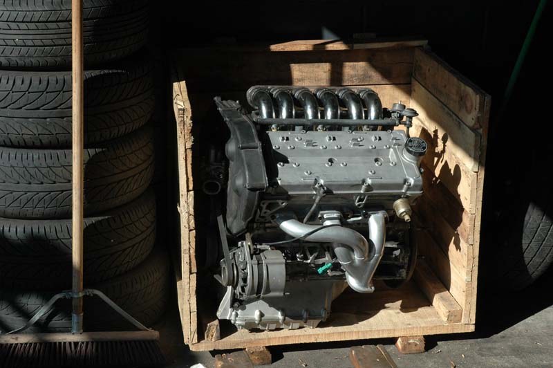

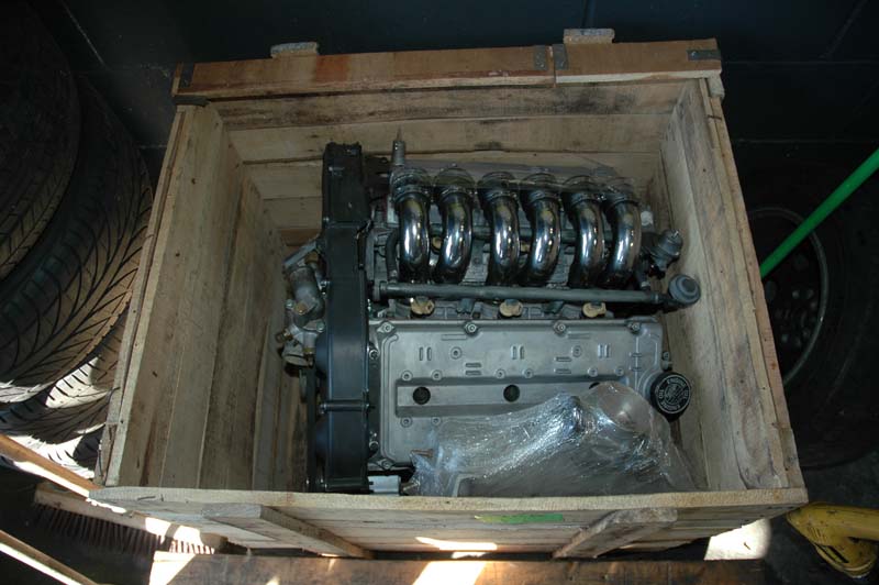

Nick, Pete, congrats on the motor - it's been fun working with you guys on it - glad that it got there OK...!
Even with the MAP sensor, you still require some remapping to compensate for local fuel... As far as the altitude; the GoTech includes an inherent "Altitude Correction Factor" setting that takes care of it.
Domingos and Dawie's settings on our 3.7s was a bit too aggressive. Joe Katic from GoTech was just here to help out with the Dyno session and to talk GoTech future... He did not have to make too much adjustment to the maps - just air/fuel ratio...
We did not even touch the timing maps when we made 300 plus at the wheels!!!
