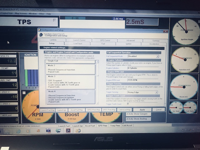

Re: Gotech Pro X
Firing order is all pre programmed. I’m not running can angle sensors either . I think you’re on throttle bodies your map will be different to mine . This will start your car
- 1337CBB9-52C4-4ADC-BE47-CBB91DAFEA09.jpeg (85.68 KiB) Viewed 5493 times
- 0C95135B-0ED3-4C85-8894-D6FCDDDD925D.jpeg (116.06 KiB) Viewed 5493 times
- 43E2FD05-677B-466B-92C3-893A122EFB8B.jpeg (122.58 KiB) Viewed 5493 times

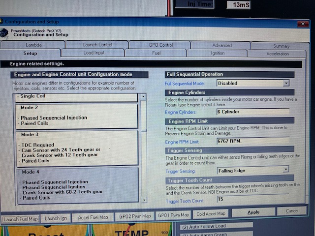

Re: Gotech Pro X

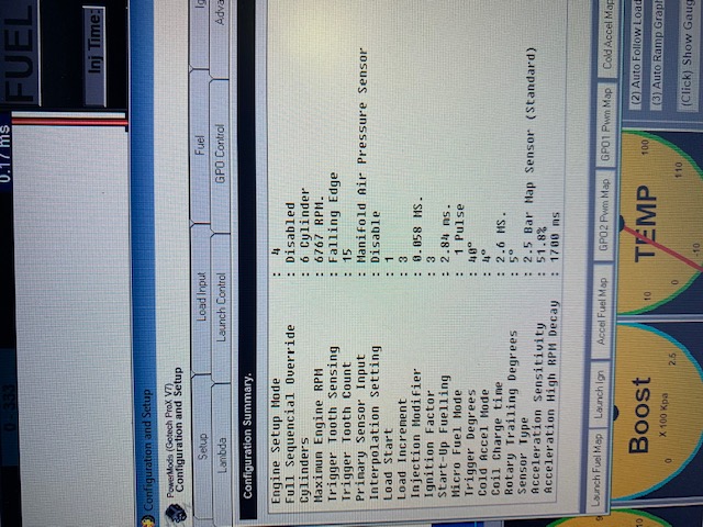

Hi Kevin,
These are my settings ,
My TPS is now 4.9
Can you see any of my settings that are inc and won't let my engine start?
My TPS is now 4.9
- IMG_E8026.jpg (100.82 KiB) Viewed 5489 times
- IMG_E8027.jpg (109.41 KiB) Viewed 5489 times
Re: Gotech Pro X
To change the setting is a bit hard , I need to Know which keys to press.

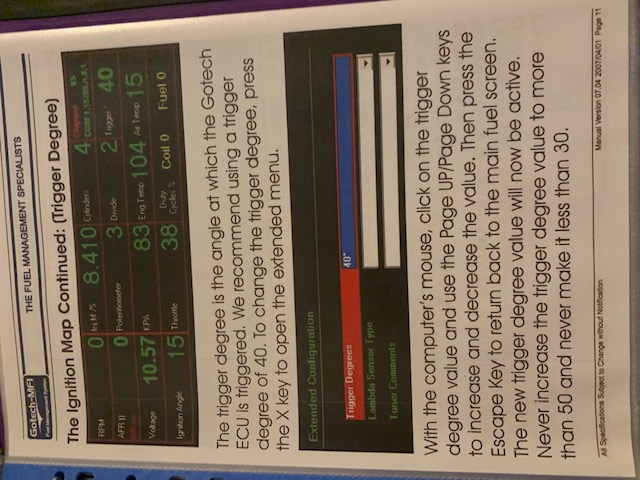

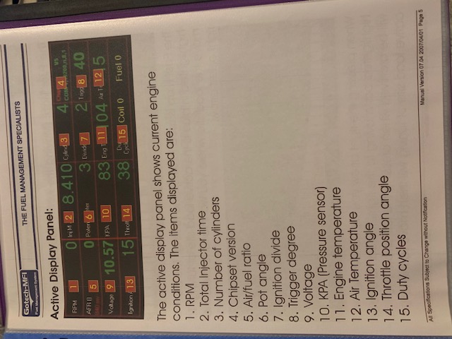

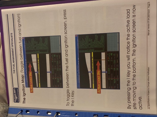

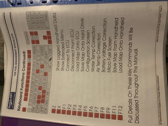

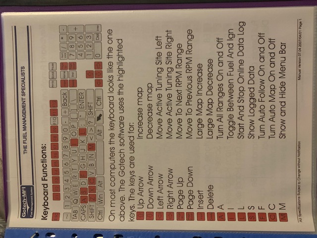

Pages 1-5
- 5BF8DAA9-091B-44D9-9CED-8A4B46B63BDF.jpeg (86.9 KiB) Viewed 5473 times
- E2E607D4-F1D9-4B4F-8F62-73BFF9F09C75.jpeg (83.1 KiB) Viewed 5473 times
- 7E4046C3-0A22-425E-A19F-6263F2907DAB.jpeg (98.47 KiB) Viewed 5473 times
- 30867E10-C3D3-432B-82C3-DFC51E73867A.jpeg (95.67 KiB) Viewed 5473 times
- 0F0DDA5D-9D7D-4460-9B49-46DCF074BF96.jpeg (103.55 KiB) Viewed 5473 times

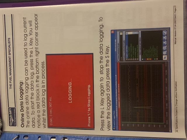

Pages 6-10
- 4795034D-3B92-4264-9D2D-20A4E82DDE8D.jpeg (103.21 KiB) Viewed 5473 times
- F99CD30D-E017-41FC-B990-CADA33FB7E1B.jpeg (95.34 KiB) Viewed 5473 times
- DF31AD18-D738-406A-84D2-9A2CCD7C5C0C.jpeg (100.45 KiB) Viewed 5473 times
- BCDD94BA-6874-4D4B-8464-BE2E0EF94F26.jpeg (81.01 KiB) Viewed 5473 times
- 7E890353-03CA-4748-8372-7C384D4FE9BE.jpeg (95.7 KiB) Viewed 5473 times

Hi Kevin,
Thank you for the manual its going to help. Fantastic
Would you have photos of your mapping for the fuel and ignition.EG refer photo attached
I have fuel at 55 PSI going to the injectors but when I crank the motor it seems the injectors are not spraying.
Electrical to the injectors are correct.
I think the programming mapping on the ECU is incorrect.

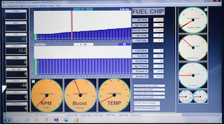

- Screen Shot 2022-12-28 at 8.05.27 am.png (125.96 KiB) Viewed 5447 times

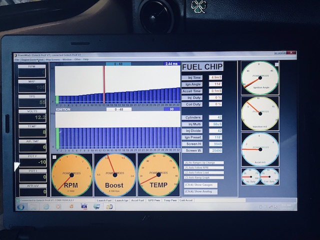

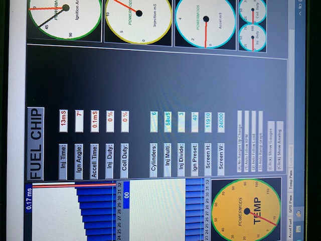

Re: Gotech Pro X
Hi Kevin.
Could you please show me your settings on your mapping graph on the fuel and ignition on your car ,
My snap shot shows 2.44MS and yours shows 0.17MS.
My engine is running so rich and its back firing at times.
I think my settings are too rich.
I cannot take the GTV to a dyno yet.
I just want to get the engine tune to an acceptable level so I can drive the car.
