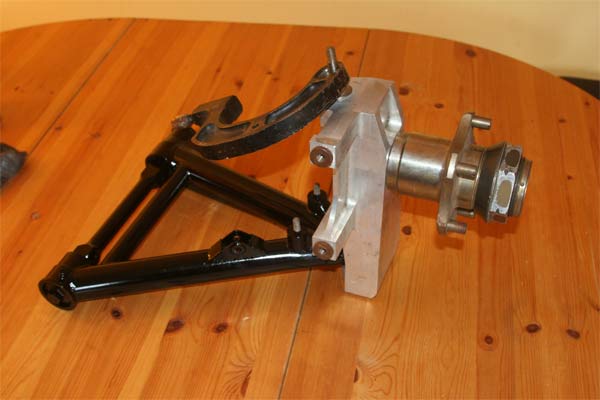

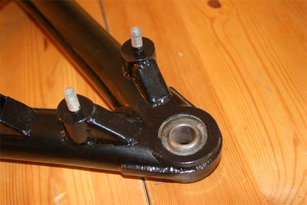

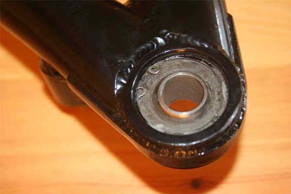

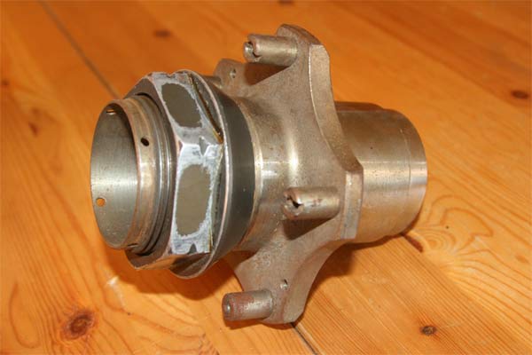

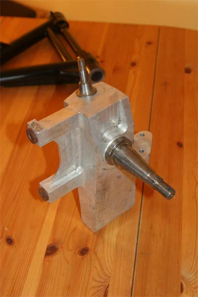

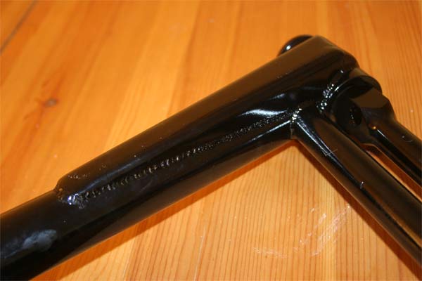

for your info
Autodelta 75 IMSA Evo Turbo front suspension parts from ex rouse gtv6 3.7
Andrew b
Andrew.b
Posts: 205
Post by Andrew.b »
more
Andrew b
