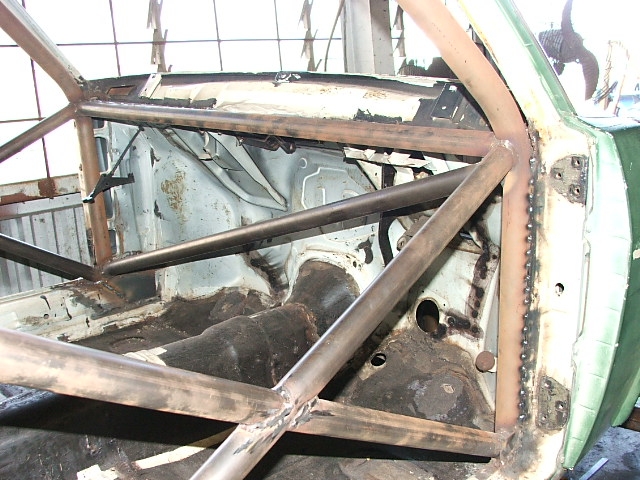

Check out the cage I am building for an Alfetta sedan for club sprints. Note the rear section that has relevance to your question. It is tied to the transaxle rear support.
The needs of the GTV would be the same as the chassis is the same.
The engine bay bracing is not shown. There is no continuation through the firewall to the front chassis as it is fully seam welded and combined with the engine bay bracing design, it is not necessary and would just be extra weight for no appreciable gain in my application.
Drivers Side View.jpg (209.97 KiB) Viewed 7307 times
Dashboard area with cross brace.jpg (206.9 KiB) Viewed 7304 times
Rear Shock Tower Bracing.jpg (200.97 KiB) Viewed 7307 times

Well I removed the trunk floor today (battery box and tire well up to the transaxle cross member) and as a result of some pretty bad rust I had to cut the rear shock mounts back to about a foot into the car... :cry:
My car is off to the sand blaster this coming week and after it is blasted I will start installing the auto power cage with some modifications. MD I like the way you tie in to those beefed up rear shock mount and the transaxle cross member. I am going to have to go one step further by running a tube from the shock mount intersection back to where the rear bumper used to mount. This will facilitate mounting on rotisserie for painting and also pull out point for the track.
I am still on the fence about cutting that section out that bridges the towers...
I would like to get that gas tank way in the cabin, but maybe over the rear axle is optimum.
