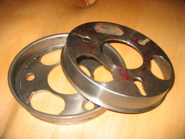

Barry, what do you think of this front coupling cage. Mainly for racing on high hp motors . Nothing new but I am going to make a few.
By the way this one has raced a full season on a 350hp motor. You can see the wear on the edges. I know of a lot of couplings disintergrating on the track causing major damage so at the worst case can any thing negative come from this.
