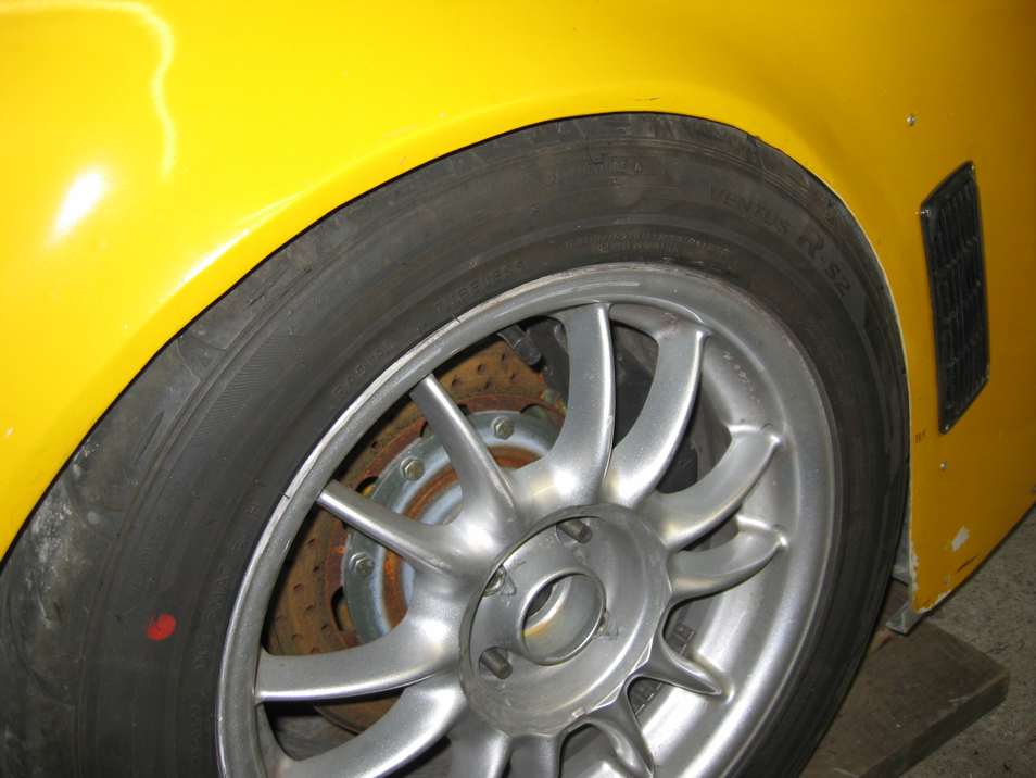

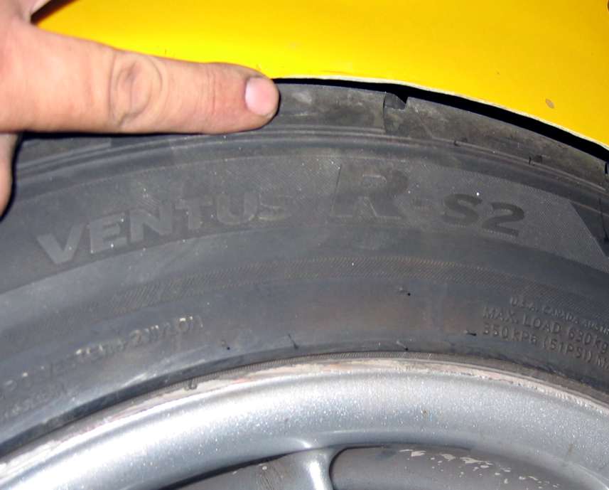

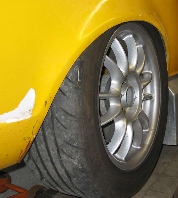

I think I maxed out the tires on the GTV with original wide body. The clearance is minimal as can be seen on the following pics.
Tire size is 225/50R16 all around.
ET is 25 in front and 16 rear.
Rear it would be possible to use wider tires at the cost of ET. Hence 245/45 should fit with ET26
Clearance RW 1.jpg (52.63 KiB) Viewed 11082 times

Micke,
I ran 225/50R16s with 35p offset 8" wide wheels on mine for a couple of days and nearly blew the front guards off it when I hit a bump. Admittedly this was on a road car which used road springs and shocks. Solid links or something near as stiff may have solved the problem or even roads without bumps (don't exist here !!)
I ended up using 215/45R16s instead.
Rears were never a problem.
