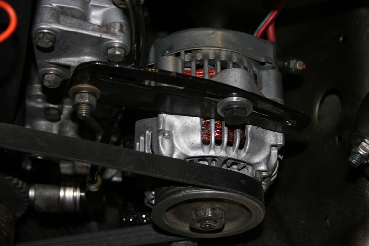

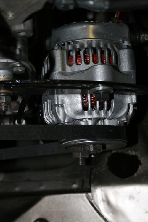

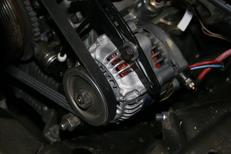

Long overdue update... Find below some pics of the 30 amp, 6 lbs Denso mini alternator and install I ended up using. Bought 2 brand new off Ebay for $50 each, off a Yamaha 3 cyl tractor application. I have run this setup at 2 events without issues, sufficient juice to run dual fuel pumps. :)
It came with a vee-belt pulley, but digging through the trash bin at an alternator shop and a visit to the local autoparts store for a proper length serpentine belt provided pulley and belt. Bracket is modified from a stock Milano mount.
yep, using a 40 amp version myself on my race car.
Nice conversion...Honda also makes some small light alternators

There is an extra 50grams of weight to be saved if you chop the excess off the ends of the mounting bracket! Also, cannot the pulley be made from aluminium? How about the bracket itself?
The Geo/Suzuki alternators can beb had for as little as $50AuD in working order. www.redlinegti.com - there are one or two there right now.
