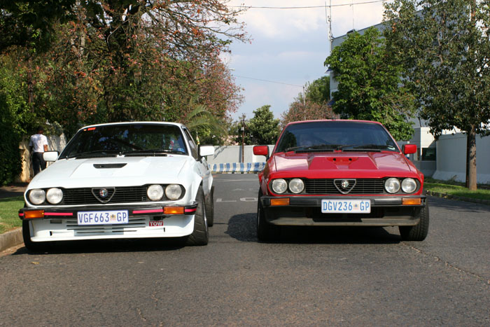

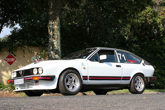

Got alignment done and went for a few laps around the neighbourhood. Konrad brought his 3.0l carbi along. All his car needs is to be lowered and its track ready as all the other prep has been completed. I have to put a sound clip of these cars or a video as they all sound great. Tracks must open soon !!
Got only 60mm under sump guard to ground which is 15mm away from aluminium square sump. Cant make these sumps any shallower as the oil pick ups are really deep on these 166 motors. Dont think the sump guard will do much but I am working on lighter stronger one as there is one chicane at our track which if you catch it wrong I will be minus one sump.

Happy New Year to you Kevin.Just had to compliment you on your race car,it's looking absolutely stunning.I see you have my all time favourite Compomotive mags now fitted to your baby. :D
Let me know when your first track outing takes place,as I would definatly want to see your car in action ?
Thanks Fernando. first race this season is 2nd Feb, The David Piper Challenge as Zwartkops. Its going to be chaos as there can be up to 45 entrants as I was told today. Just one big high speed traffic jam.
