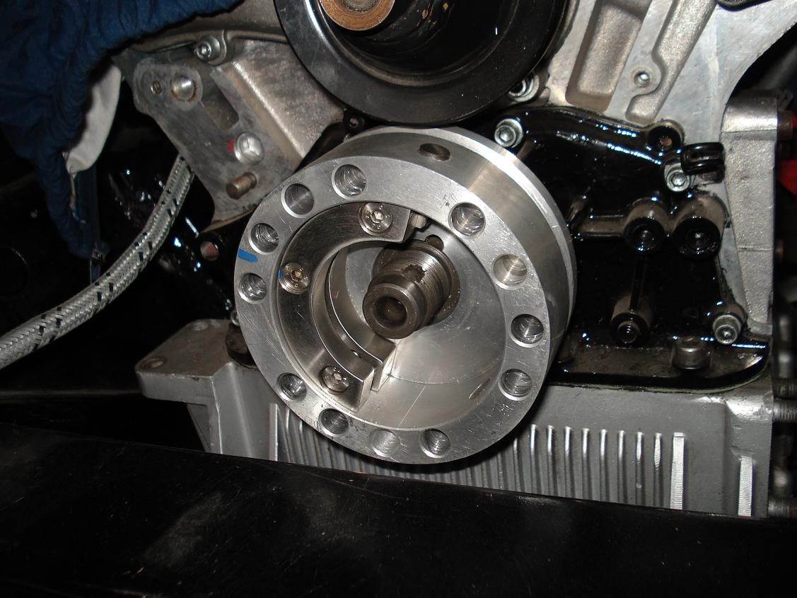

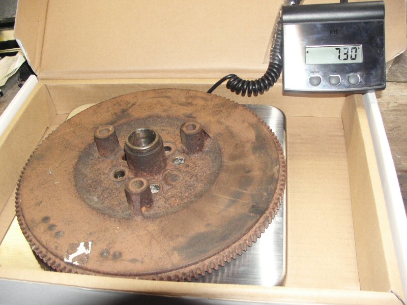

Here are a couple to get it started - flywheels.
I no longer have a standard V6 flywheel to compare to but the lightened one off my 2.5 came in at 7.3kg and if I remember right (it was 10+ years ago) I pulled nearly 5kg out of the standard one to get this.

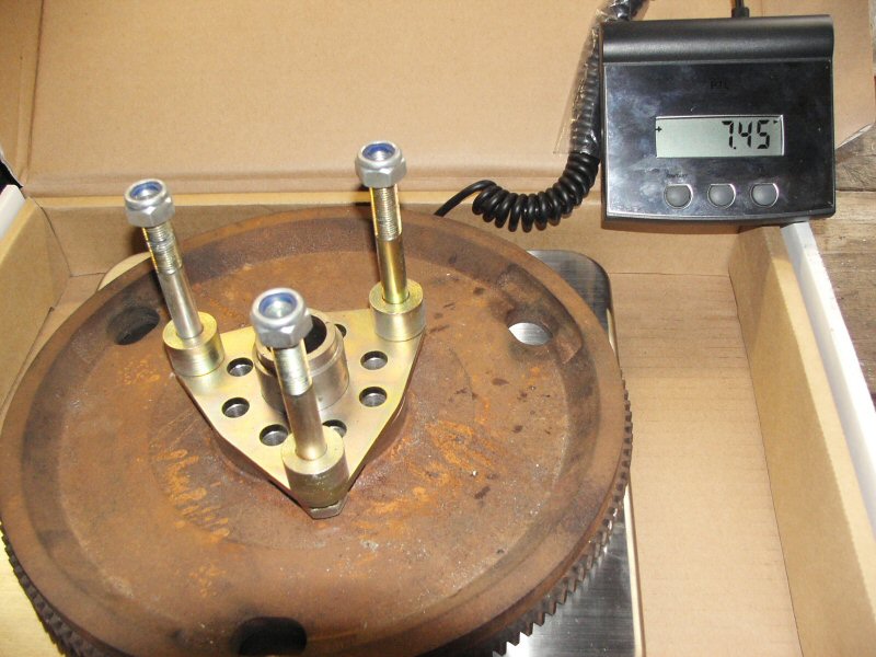

The 2nd flywheel is the "new" one from the 24v engine. It is an automatic flywheel with an adapter for the tailshaft - 7.45kg including tailshaft bolts.

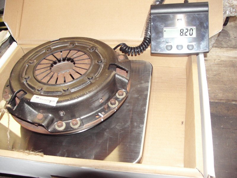

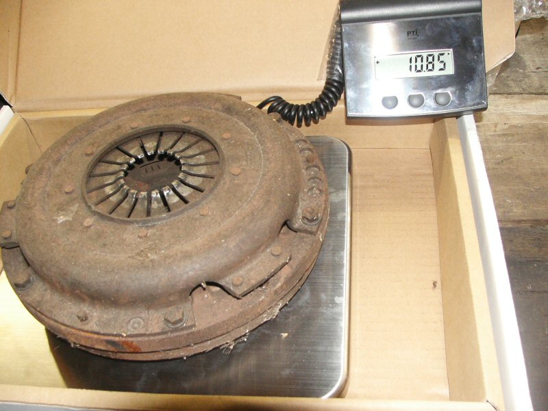

The standard 2.0 flywheel & clutch assembly that I was using on my 2.5 weighed in at 10.85kg while my lightened flywheel & custom clutch assembly is a little lighter at 8.2kg - all of it off the outside where it counts most.

Lightened flywheel & 8" solid centre clutch

3.0 24v auto flywheel with tailshaft adapter
08-01-04 006.jpg (96.68 KiB) Viewed 12408 times
Modified 2.5v6 flywheel - about 5kg lighter than standard
08-01-04 008.jpg (93.69 KiB) Viewed 12408 times

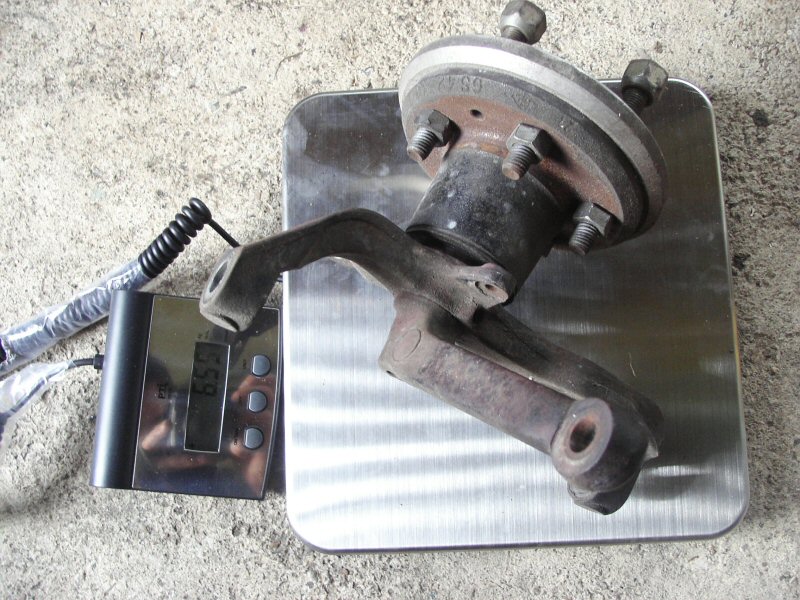

Front upright (spindle) and hub (standard) - 6.55kg

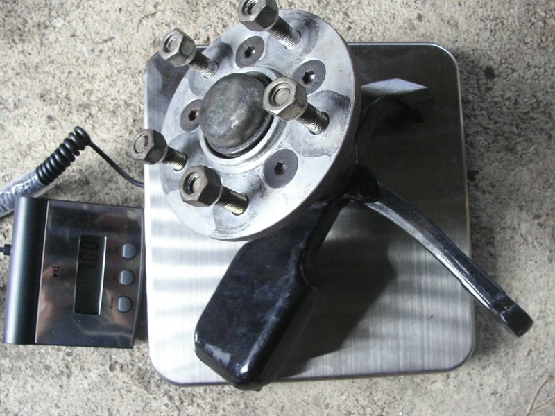

Front upright (spindle) and hub (extended / drop spindle) - 7.0kg

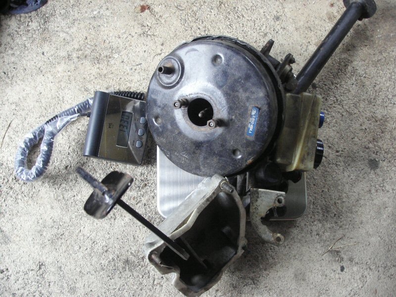

Pedal box assembly (RHD including cross rod,booster etc, no clutch pedal) - 13.3kg

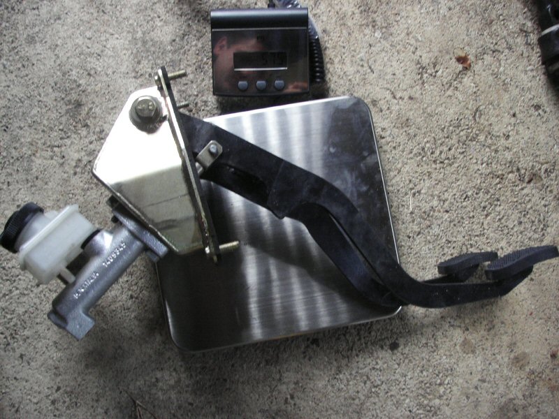

New pedal box (with dual brake masters and adjustable bias, no booster, clutch pedal from original assembly) - 5.75kg

New pedal box assembly
08-01-05 011.jpg (126.2 KiB) Viewed 12341 times
All of the old pedal box bits
08-01-05 012.jpg (146.92 KiB) Viewed 12342 times
Extended upright and hub
08-01-05 009.jpg (111.92 KiB) Viewed 12341 times
Standard upright and hub
08-01-05 008.jpg (138.18 KiB) Viewed 12344 times

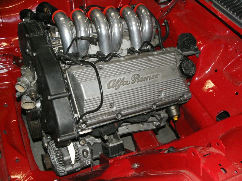

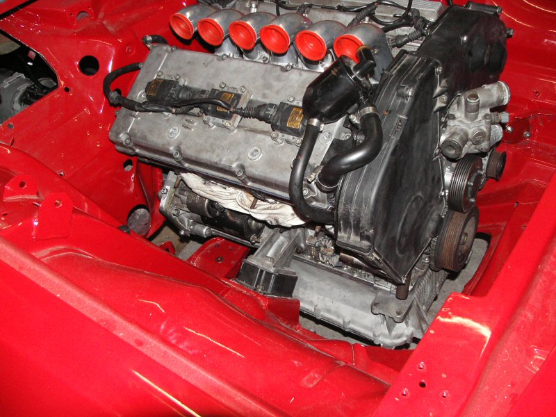

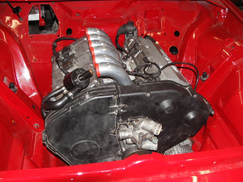

The heart - the 3.0 24v V6, complete with reduction starter. No plenum or exhaust manifolds - 182kg.
Now if I can only get better than 1kw per kg out of it :wink:

The 24v heart in its natural resting place
08-01-13 001.jpg (118.84 KiB) Viewed 12179 times

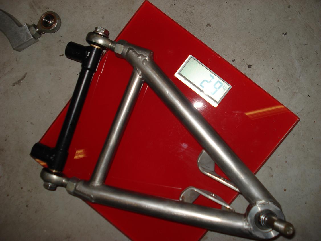

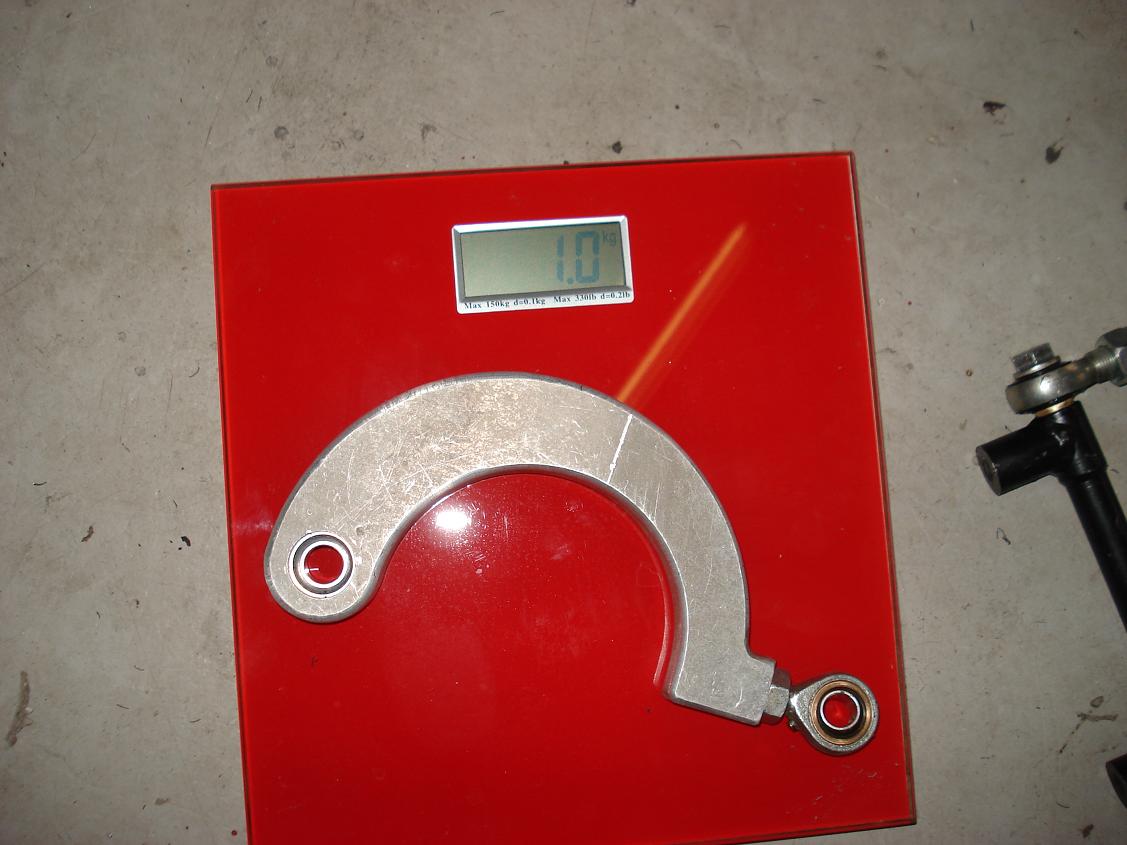

Some mass reduction on my car (12v):
Front flwheel w/ring gear: 3.5kg
Front pulley w/counterweights: 1.35kg
Pics show suspensionparts and front pulley..
Mass_reduction 001.jpg (101.65 KiB) Viewed 12158 times
Mass_reduction 002.jpg (100.16 KiB) Viewed 12161 times
Mass_reduction 003.jpg (139.94 KiB) Viewed 12159 times
