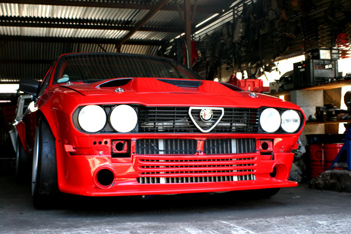

Race number two coming up next weekend. My car should be running shortly. Problem was broken valve spring. Anyway Dawie de Villiers junior will be driving the monstrous tt bigbore 24v with front mount gearbox. The bodywork has been restored perfectly with the legendry double vented bonnet off the origional TT that campaigned in the early ninetees. Few pics to follow. pics of engine will come at race day.
Rear wing

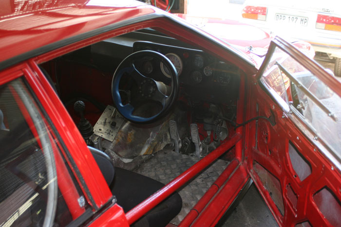

Interior will be cleaned up this week. Box up front. The engine in this car sits quite a bit further back than normal.

Put the car on a weight loss program by stripping out all sound deadening. Next will by using fiberglass doors,bumpers and bootlid. This will probably bring tha car back to standard weight with all the extra kgs i have added by using 305mm discs, 30mm antiroll, coilovers,24v motor, roll cage and fire extinguisher.

..this is my reply to a post you go over in one of Michael's about your air intake..
Hey Kevin, what are you doing with Grandma's vacuum cleaner hose under you bonnet man ?? :D :D
Of course you know what the answer is gonna be to your question before we even start. Got the same issue with my intake. Yes they work until a smooth wall bore comes along and that needs to be yesterday. The corrugations create drag and turbulence that we don't need.
If it is the diameter of a sewer main pipe, it doesn't matter what it is because of the huge cross section area ie 500mm radius or more. 8)
So give Grandma back her vacuum cleaner and get a smooth bore one like I gotta do . While you're at it, why not minimise your bends and remove the inner spot light and stick the intake there facing the front? Unless you plan to do some rally work in your local creek beds, water issues are irrelevant. Many local racers here do the same. In your situation this could be done using a light wall metal tube of 100 mm ID or so with a couple of flexible joiners where required. The metal tubing will not collapse or need and wire corrugations inside to support it. ( all of which is bad news.)

MD, What "vacuum hose", thats a standard issue extra ribbed South African condom. Yeah I just needed confirmation but I will start work on a new one out of mild steel.

Don't listen to MD, he must be high on something...
A 4" hose is restrictive? I know about the not-so-smooth-surface thing but come on...
I bet the weight of a 4" mild steel pipe is far worse for car performance then the restriction created in that hose. 8)
