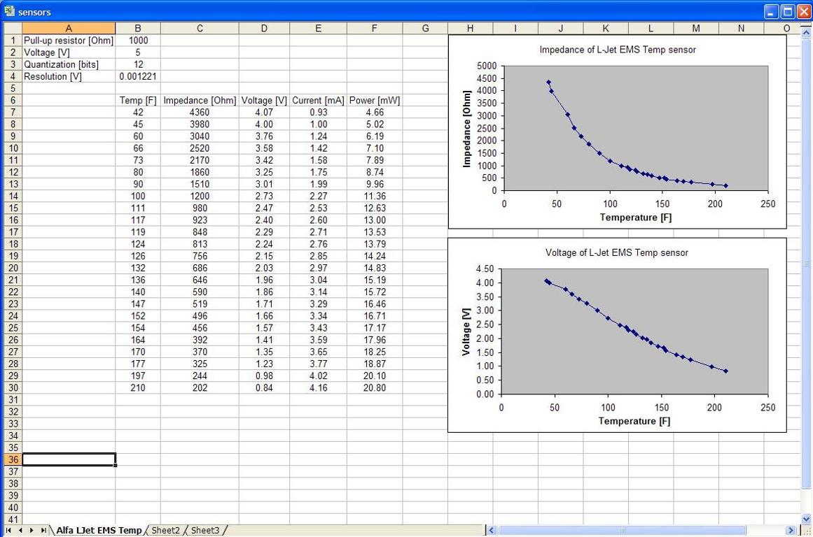

Tonight I measured some Alfa temp sensors I had laying around. I tried:
1. The stock sender for the temp gauge
2. The sender for the LJet EMS
Oddly, I couldn't get good impedance readings with 1 - they were all over the place. I will dig out another one tomorrow and try again - perhaps the one I first found is broken. With 2 I got good readings, and if configured with 5 V and a 1 kOhm pull-up resistor you get a nice linear relationship between temp and voltage - see pic for details.
During setup of DL1/DASH2 you simply enter the (temp, voltage) measurement points and it figures out the curve-fitting.
I used my tire pyrometer for temp measurements, so it should be accurate. However, the temp sensors take a little time for the impedance to settle.
It would be nice to use 1 since it is already there (serving the old dash gauge) and available. The sensor 2 would have to be fitted in the port currently occupied by 1 (since the existing 2 is used by the EMS) - unfortunately 1 and 2 are not the same thread size or pitch.
Not sure how to (conveniently) measure the oil pressure gauge...
- LJetTemp.JPG (139.43 KiB) Viewed 9508 times

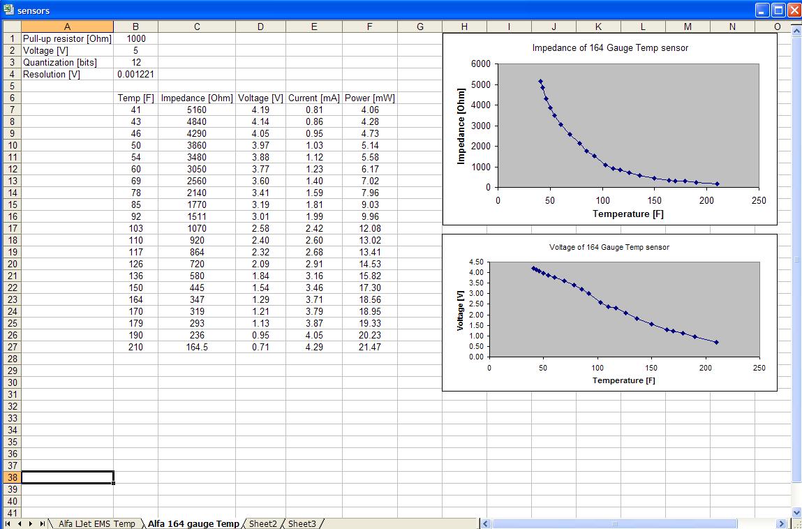

I suspect the Milano/75 gauge sender (1 above) was defect. I dug out a 164 gauge sender, which looks identical to the Milano/75 gauge sender, and it seems to work fine. It fits in the Milano/75 temp gauge sender port, and hence is easy to use. Find below the measurements.
- 164GaugeTemp.JPG (143.17 KiB) Viewed 9440 times
Good Job!
