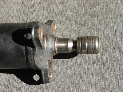

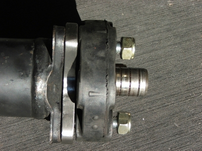

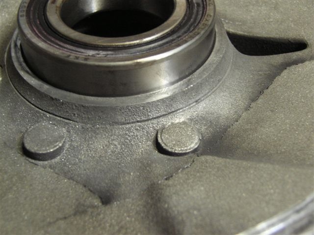

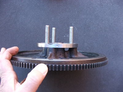

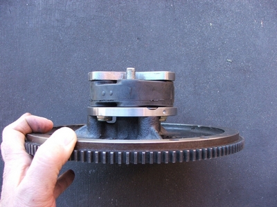

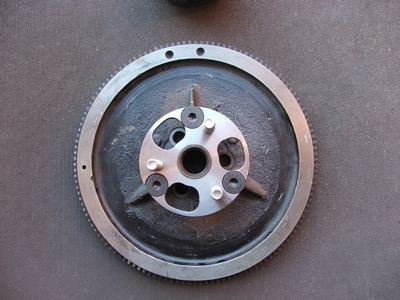

Yes I do have some pics of the front conversion. I hope you can figure out the sequence of assembly from the pics. Basically it requires a change of PCD because the Alfa bolts do not line up to the new donut. The second problem is that the bolts sizes are larger for the new coupling so you have two choices. Either make sleeves to convert from 10>12mm or use bigger bolts.
I used bigger bolts .
Notice that the shaft still centres on the original centre locator bearing however it is a completly new shaft and the Alfa end has been grafted onto it. It is necessary to weld onto the driveshaft, the converter plate. The photo does not show welds. Care must be taken to avoid distortion (hence alignments after).
In hindsight, instead of making conversion PCD plates, it would be better to simply make a complete new flywheel out of billet steel, shrink the starter ring onto it and have the correct PCD's on the new flywheel to fit the new donut. You would still have to do a conversion on the driveshaft itself as well of course.
Presently my current shaft uses this at the front followed by two universal joints. This is about to receive its final and third modification to eliminate the rear universal and covert it to a similar type of donut as is in the front. This is not necessary but I just want to take a precaution against any further stresses on the clutch housing from alignment and vibration issues which are almost impossible to eliminate altogether. Putting the front one on made a huge difference to quieten down the noise from the transmission during idle . The final mod should complete the picture in our driveshaft development.
The only other improvement I can see is a change to a CV joint in the middle instead of a universal one in my set up which may yet be done if needed.
Finally, if you wanted the ultimate, go the the composite one piece shaft and BMW donuts at both ends.

- Flywheel PCD Conversion 1.jpg (119.52 KiB) Viewed 14263 times

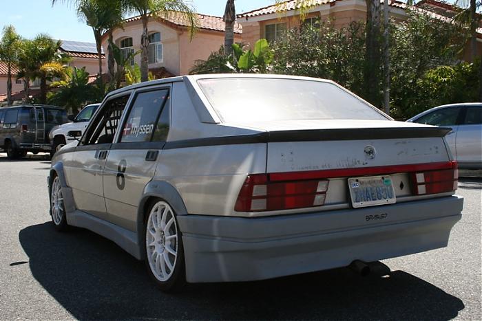

Hmm, that description fits my race car pretty well, although I have not had any problems - pic attached. I will check the float. How much negative camber do you have at the rear?MD wrote:..and so we learned another valuable lesson which Iam sharing with you. If you are going to lower you car to the shithouse and give it bags of negative camber and minimal suspension travel, please ensure you have the shafts machined shorter so they have some end float. Between 5-10mm will do it.
I know Mats runs a lot on his Alfatta GT - I'm guessing more than -4 degrees. I have about -4 degrees on mine, and I believe it is too much. Very, very hard on tires. Braking suffers too due to little straight-line traction and with some tires it has gotten extremely squirmy (requiring significant steering correction) during hard braking, using one hand while down-shifting. I'm going to do another Dedion with about -2.5 degrees - just have to find the time...

Re: MD's Racer-The Flying Brick
Jes,
Your car looks like it has more camber in the back. So the front must be around -2? Maybe it's just the photos? My car has -3 Front and -0.5 rear.
