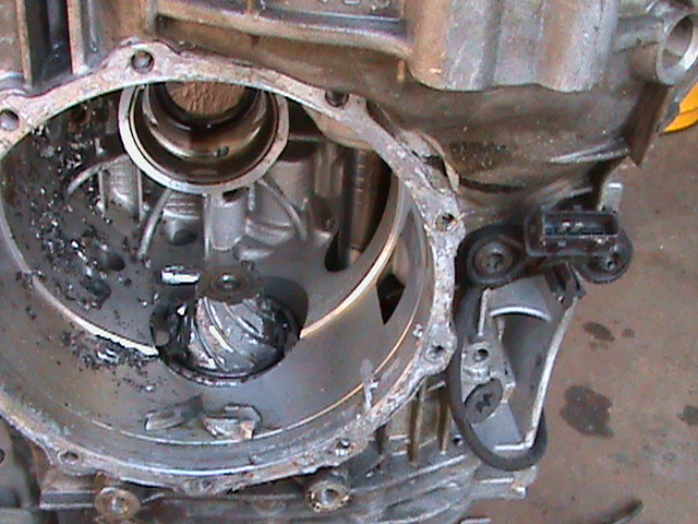

This is what happens when you test launch control on the 155 tt mid mount with full slicks. Glad to see it happens on other boxes other than Alfa ones. Then again there were 300kw on wheels. Every week more adjustments are made on this car but will probabaly take another year to get right.
- shredded cpinoin.JPG (140.45 KiB) Viewed 11352 times
- SydneyJules
- Posts: 619
- Location: Sydney
Re: Ferrari inspired GTV6 challenge
SNAP!!!
(I've got the power!)
Nice work- stripped the splines off it nicely!

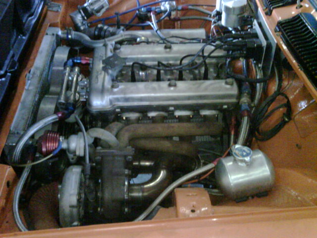

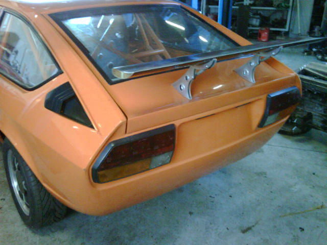

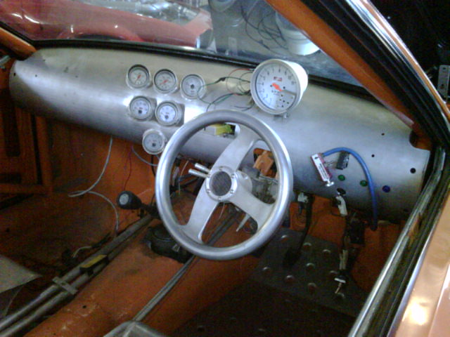

If MAD MAX was to made in Italy I think this is the car that would have been used.
Not quite finished but has everything a serious racer has but with some few extra ordinary features . It has a 105 series box upfront to handle its crazy power.
I must also be going mad as I think its pretty cool. Not saying that i would go to Mass in it.
Check it out.
Check it out.
- IMG01140-20100529-1101.jpg (60.93 KiB) Viewed 10512 times
- IMG01143-20100529-1103.jpg (56.17 KiB) Viewed 10508 times
- IMG01144-20100529-1104.jpg (62.23 KiB) Viewed 10515 times
- IMG01145-20100529-1104.jpg (65.64 KiB) Viewed 10505 times

105 series box? Will that handle much power?
I always thought that was just as weak as a transaxle gearbox...
What's the expected hp/Nm number on this turboed jem?
- Posts: 494
The weakness is the 116 series Diff - the 105 gearboxes seem to be holding up ok behind some fairly stout turbo 4cyls...Giuliettaevo2 wrote:105 series box? Will that handle much power?I always thought that was just as weak as a transaxle gearbox...
