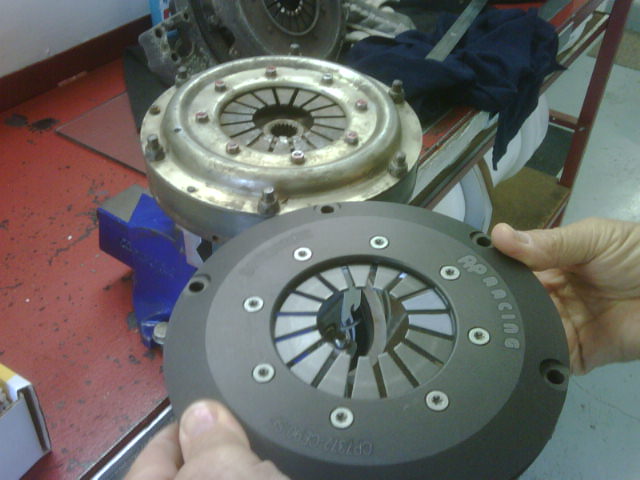

New clutch I am making up . Starting to macjine a flywheel. Just checking diameters here.

The 928 is not out the window yet as I want to give the origional box another go with a much lighter clutch unit to reduce innertia (rotating). This should have a direct impact in the longevity of the crown/pinion. I have now the correct oil, temp is good so with the lightweight unit it should work. Tolerances (backlash) is perfect. A friend of mine was the mechanic for julian 75 3.7 that won the british club champs a few years ago and remembered only one pinion failure. The 75 long ratio unit was used with a 1;1 fifth thus it had the biggest pinion of all the transaxles made.

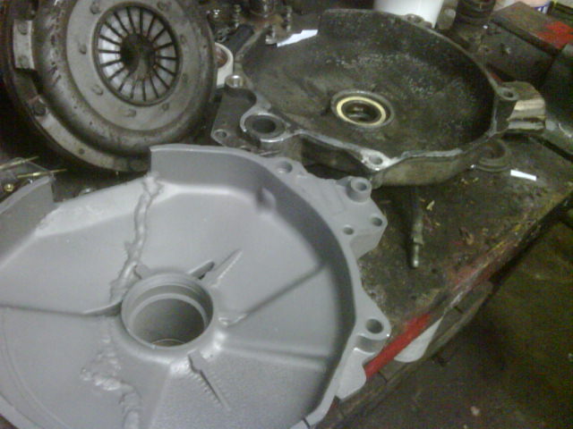

Back to clutch. When all you race chaps are replacing the double gtv6 standard pull clutch to race type push clutch DO you use the same clutch housing with hole cut for master cylinder or go back to the 2.0l housing. The 2.0l housing has a circlip to hold bearings in while gtv6 has two lock nuts which is much stronger. (ignore welds inhousing)
Ideas anyone ?
Ideas anyone ?
