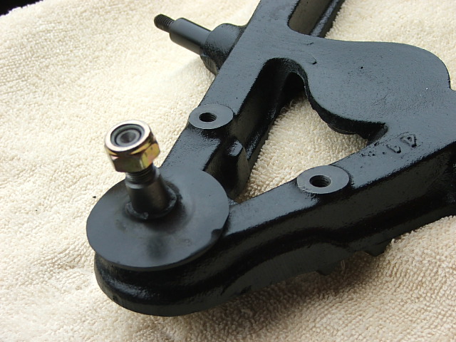

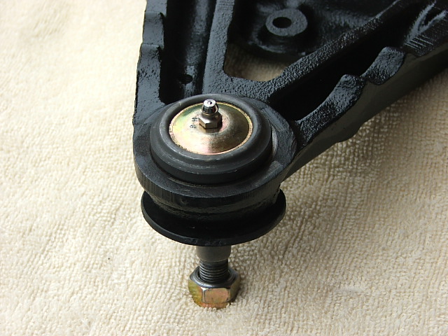

Hi Ben,
Yes the Brick has this modification. See photos. It reqires a special ball joint made for this purpose and a remachining of the arm to fit it. Once done, you will need 16" rims otherwise the wheel will /may foul the ball joint.
This topic has been discussed at length before on this Forum. Please do a search.
This conversion is for a RACING ONLY.
Please, nobody do this for your street car.
- Dust Cover to Ball Joint.JPG (116.32 KiB) Viewed 5279 times
- Ball Joint Pressed into LCA under tension.JPG (117.42 KiB) Viewed 5280 times
- LCA Machined out to take BJ.JPG (114.38 KiB) Viewed 5280 times

MD thanks for the pics. i have looked through almost all the threads on the subject but as yet have not seen these pics. are they on somewhere.
what is the ball joint from. i have been looking at honda ones but what you have used look like they fit well.
my only problem is i run 15" wheels.
how much had to be machined out of the LCA? is there much concern for compromising the strength of it.
my car is a dedicated circuit car and will never be used on the road.
thanks for the input... much appreciated.
ben

Re: Front suspension- Upside down Balljoint
Nice work Emm Dee
How much material did you (guys) have to remove from the LCA to get the job done?
Have you spotted http://www.alfaholics.com/racing_and_co ... 59_117.php ? Except they use a spherical bearing and custom machined mount (obviously for the 105s) to get the job done, along with bump steer correction (as per your suggestion)
I think the ball joint is from a Gemini. Dont know which one.
No problems with residual strength. 2 years of use, no problems.
16" wheels a must.

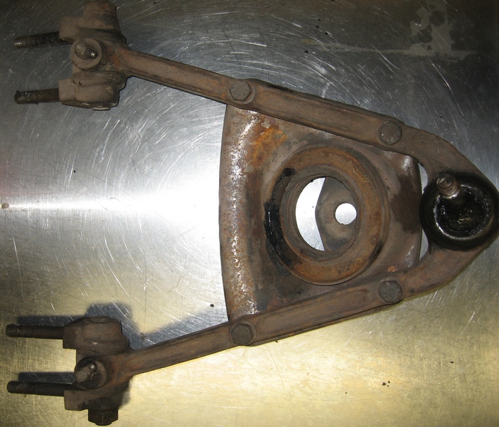

This has all been done before of course. See photo of 101 series Giulias in the sixties had these types of LCA's.
- 1 Alfa 101 series LCA with upside down ball joint.jpg (211.42 KiB) Viewed 5252 times
