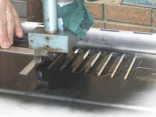

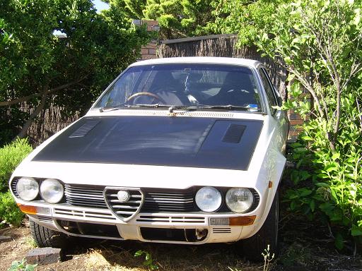

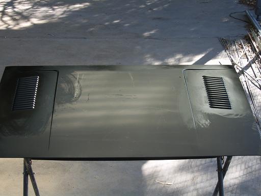

now some of the turbodelta bonnet my dad and i made 8)
20 years ago he made this louver press, and has since been punching louvers in hot rod and custom bikes and cars. mainly bonnets but sometimes body pannels aswel. after seeing the turbodelta bonnet we thought we should copy it because it looks good, is unique and lets hot air out :)
the original louvers are spaced closer together and smaller, but we dont have a tool that size so this one will do. because the tool is a bit bigger the lovers cover more area, this was just a test, the next bonnet will have less louvers to make it closer to original 8)

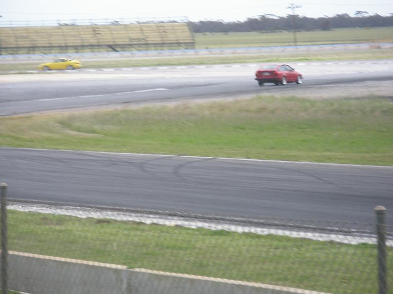

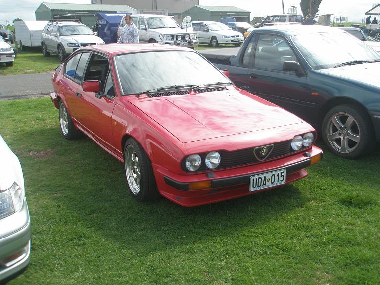

a few more pictures, this time of my 83 GTV,
this car has gtv6 interior, simmons fr16 wheels, konis all round, lowerd/stiffer springs in the rear, volvo 4pot calipers and rotors, the motor has cams, ported head, hi-compression, extractors, stainless exhaust.
i drove it at mallala our local track in south australia, it was my first time driving around the track so only took it easy and practiced my lines :D

That louvre press is great! Can I send you a bonnet?
Regards, Andrew.

thanks! you sure can send me a bonnet, i have done 2 for other people so far. your on the alfa vic forum arnt you? just pm you details on there and we can arange it!

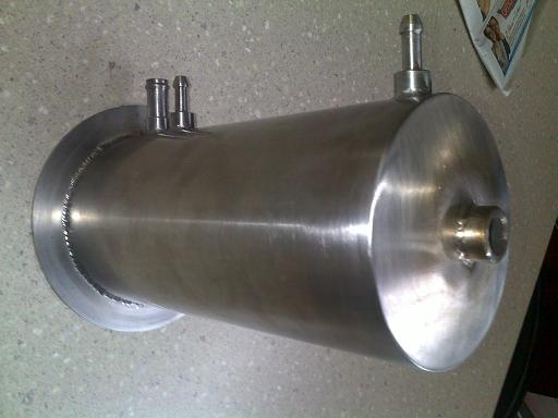

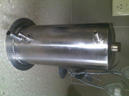

thought id show a picture of the stainless steel surge tank / swirl pot i made,
its made from large diameter tubbing, with 2 end caps with, a base and a top which is pressed to form a dome. and the barbs were turned on the lathe, then all welded together. then the welds were lineshed around the top to smoth it off, im pretty happy with the result. it should hold about 1.5 liters.
the next thing i will make is a oil catch can and an inlet plenum similar to 'mats'design. man i love stainless 8)

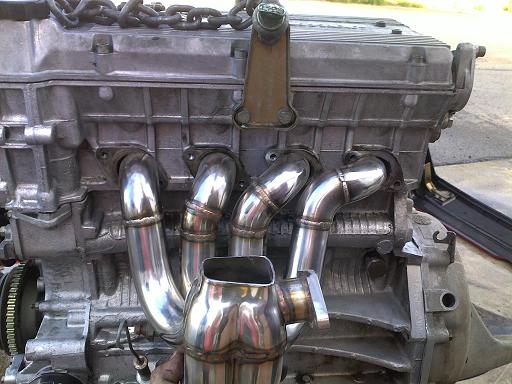

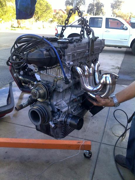

a picture of the stainless manifold, fits a treat, ill just need a twinspak exhaust flange drawing! so i can get a flange laser cut and weld it up! please, someone out there must have a drawing, or cad drawing that they could scan and send to me?
the sensor on the side of the block, that is just above the oil dip stick, whats it for?
