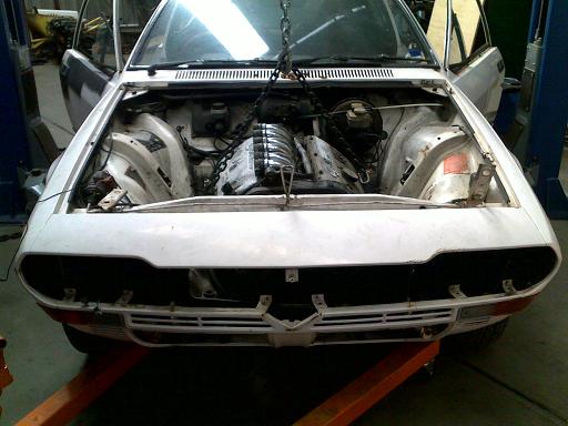

finally some more progress,
the car has been stripped down a fair bit,
engine out, gearbox out, interior out, grille, lights, trim ect. has all been taken off.
next step is to remove the sound deadening :(
any tips on doing so? im going to try a heat gun with chisel and hammer any other options?
i through the 3.0 v6 in just to see how it fits, would be good for torque but too heavy for my car, will save it for my daily driver 8)
... and the TS in, just dummy fitting it to check that manifold and turbo will clear shock tower ect. and have a look at the option of fitting a 3" exhaust down between the firewall and steering rack, i assume this has been done before?
cheers, brad

BradGTV wrote: next step is to remove the sound deadening :(
Nice project!
If you haven't already removed the sound deadening, don't heat it. Use dry ice. Heat makes it very difficult to remove. Freeze it and chip it out.
Good luck!
~Chris
Current: '88 Milano Platinum, '74 Spider
Past: '76 Alfetta GT race car, '74 GTV 2000, '87 Milano Gold, '78 Sports Sedan, '78 Alfetta GT
Re: Turbocharged 79' GTV - Track Car Build
Brad
Placement of the exhaust pipe between the rack the firewall is achievable. Fitted a 62mm od pipe there myself before. The area may need a bit of "massaging" on the firewall with a 5 lb hammer to make some room if necessary.
Key other consideration will be heat shielding the rack so don't overlook that.
Chris,
Obviously you haven't read previous threads on this. Dry ice is NOT the technique. It's cumbersome, slow and dangerous.
Brad, buy a $20 heat gun from Bunnings and $2 paint scrapper. By far the simplest and best method. Be sure to wear some leather gloves in case the heat moves accidentally towards your hands. Best done outside for dispersal of fumes. Dont heat it so it burns .Only enough so that it is soft and pliable. Scape off. Collect all of it in a bucket. Weigh it all at the end to see the amount of weight savings you have made.
Cheers, MD

MD wrote:Brad
On a RHD car? On a LHD car it will cause sweaty feet, on a turbo car very much so... :wink:
MD wrote: Chris,
Cheers, MD
Room temp is the way! Just break the corners on the chisel so it won't damage the primer and hammer away. The stuff comes off very easily (without fumes!) in small pieces, leaves just a little bit left that can be wiped off with some solvent.
Mats,
Brad's car is RHD. The Swedes should never have changed over!! :D
Let's agree to disagree about removal of deadening material.
We actually had LHD cars even before switching to driving on the right. Interesting overtaking procedures I presume... :shock:
