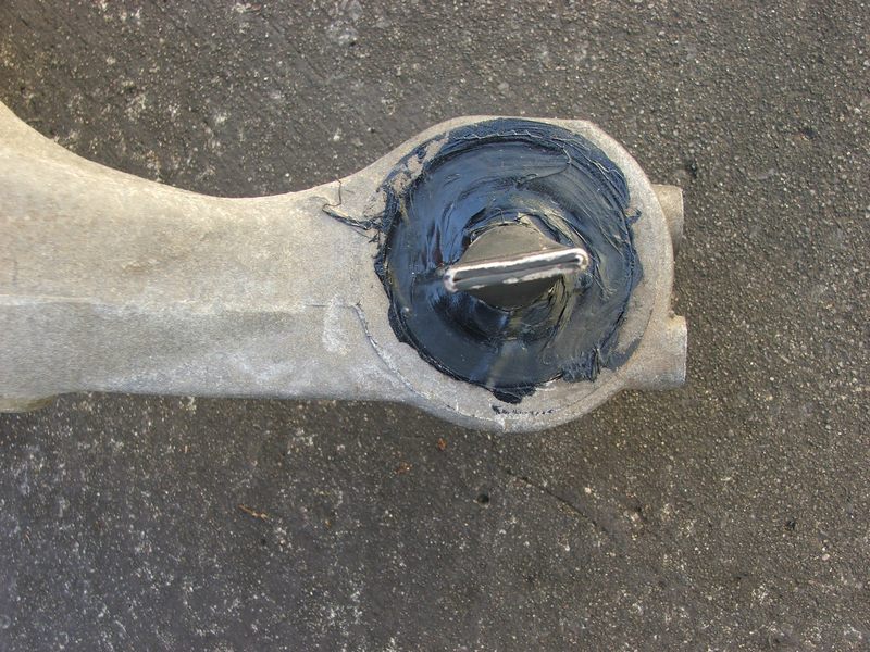

Why remove it at all?
Clean it down with white spirits to remove all oil contaminats.
Inject some polyurethane sealant in the voids and be sure the metal stay is centralised.
Allow to set before use.
Makes for a better mount than original for a race car.
You can do all this in the car and just remove the exhaust for access.

Md the old mount is not symmetrical and I already had it packed with urethane from last year so it had to come out.

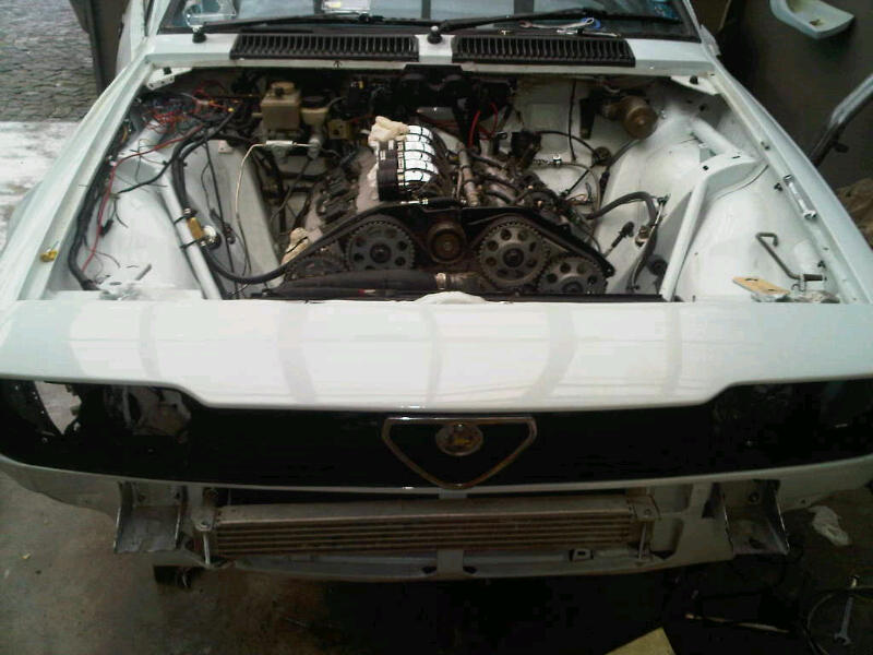

Well , still plodding along trying to get car ready for a race coming upat end of month.

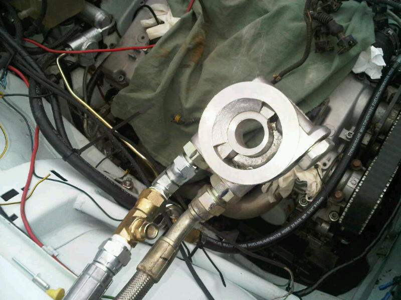

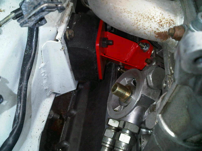

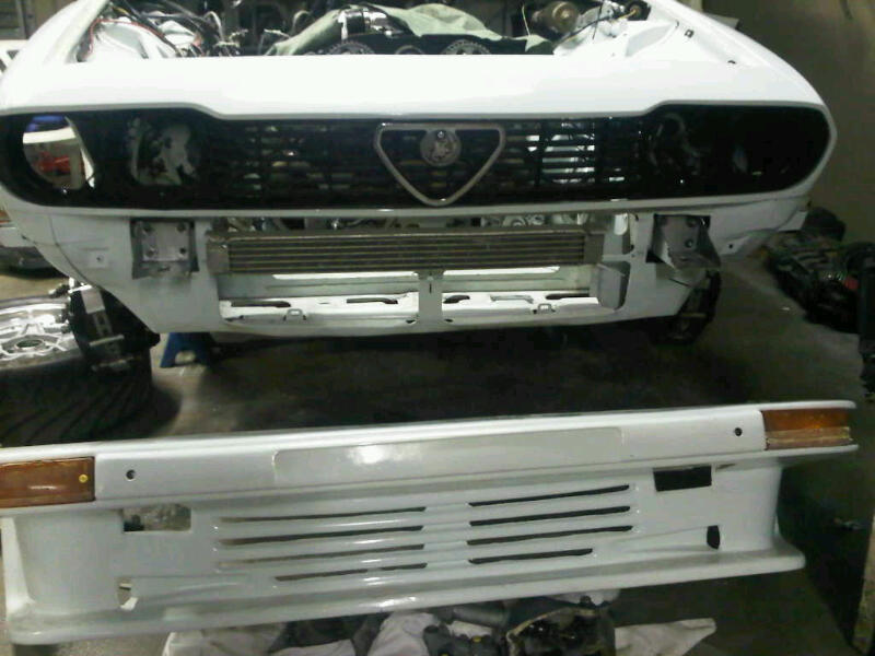

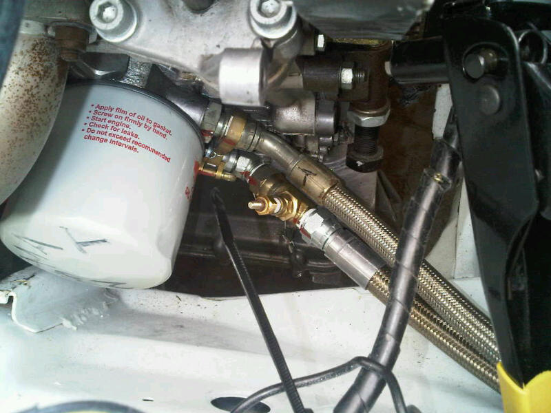

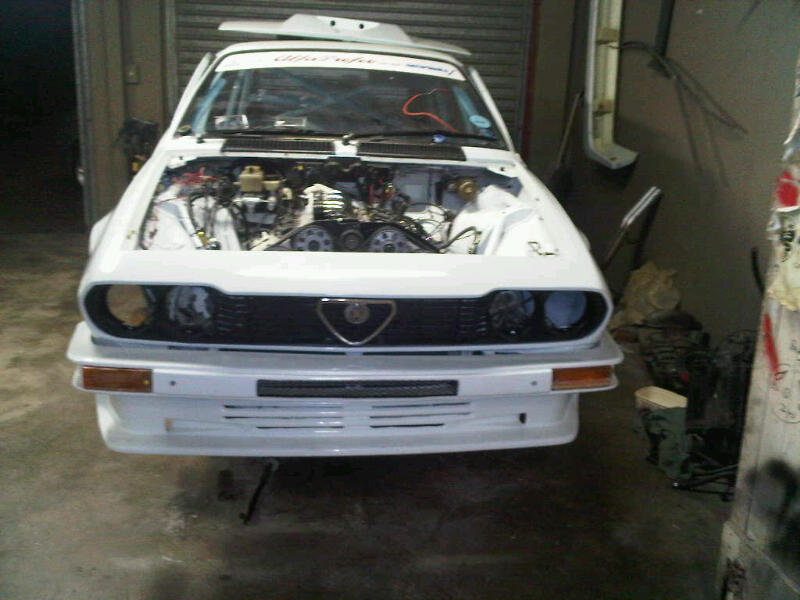

Some pics of my oil cooler which I have mounted in front which fit perfectly into my bumper/spoiler combo unit. Also put in temp probe on return line.

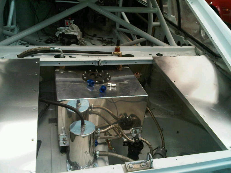

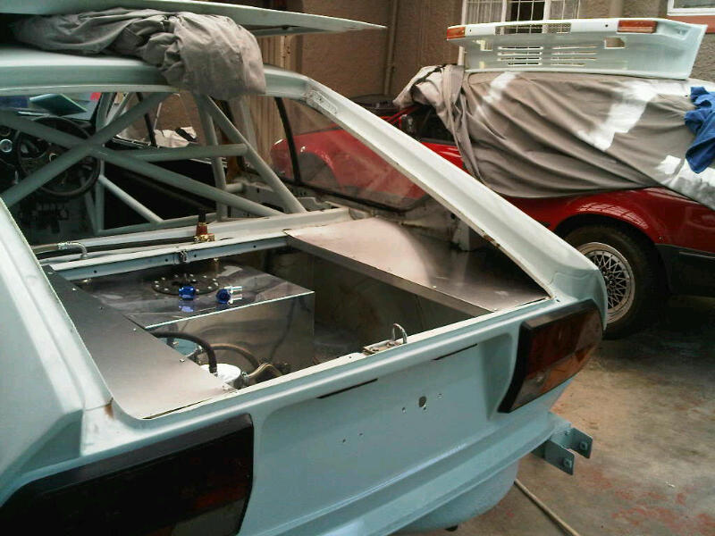

Its quite a mission to enclose boot section of gtv for FIA rules. My plan is to enclose noth sides with aluminium then use polycarbonate sheeting with a circular lid to full tank. Reason using polycarbonate is to be able to see if any leaks or problems.
Front ucombo unit on with airduct to oil cooler. I will run my number plate over this when I drive to track.

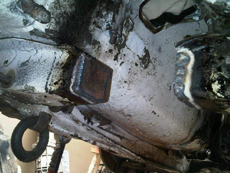

Decided to cut the center section out in tunnel to make it easier when removing prop. I then use a nother section which bolt back with four bolts. Pic of template which i will weld up with mild steel .

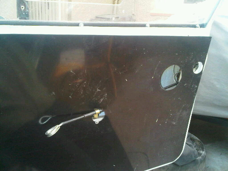

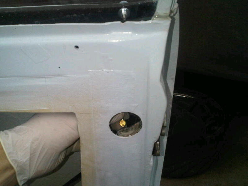

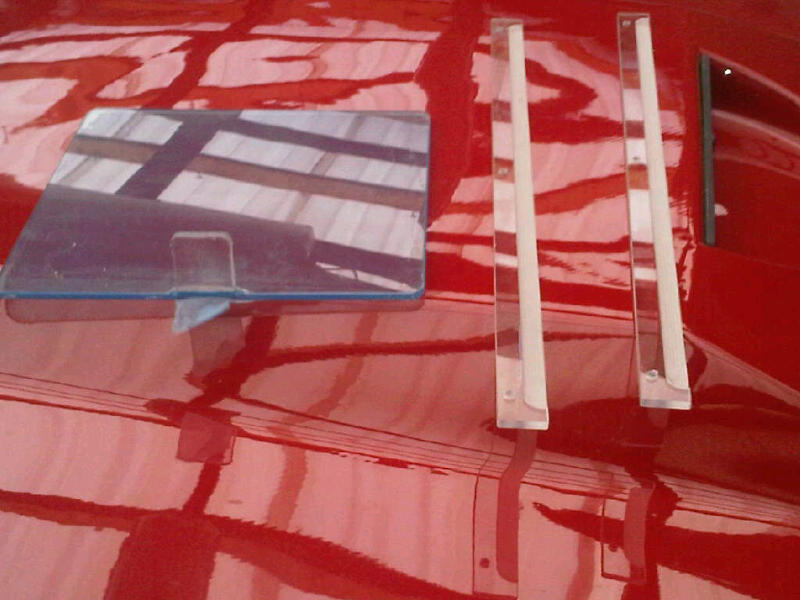

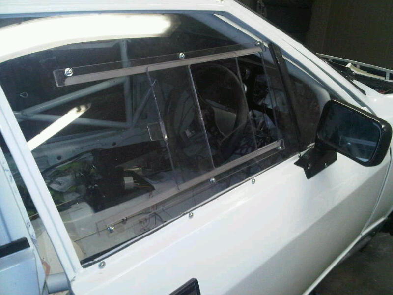

Some more pics of progress . Used cables to open doors as its only way with fiberglass doors. no place to put handle anyway . Also made a sliding window by milling two flat pieces of polycarbonate . You got to space with washes so it does not scratch to much. See pics
Window pics

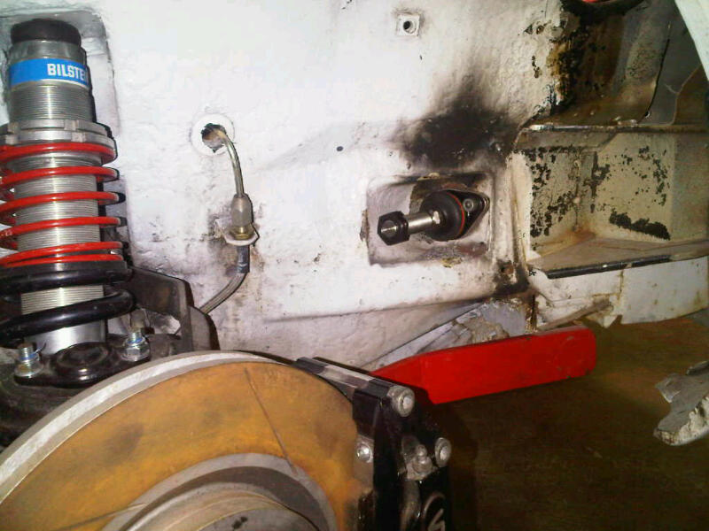

I made some spacers for castor arm but still had had beat the bodywork to get it to fit. As mentioned I did grind of ears to get a bettter shape.

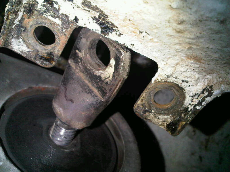

Thanks to this forum(Brian ) for advising how to put bush back in but had to laugh. So I froze the bush to -2 deg in freezer whole nigh then got my heatgun and heated up up bellhousing to 60 degrees. I then put the bush in with 'huge ' clearance but was so taken back that while admiring this ,the rapid warming of bush was faster than me pushing bush 100 % percent into position so its in 98% which i will live with.

Pic of bellhousing bush . I moulded a threaded tube into 65 shor hardness rubber with two adjustables ears .
