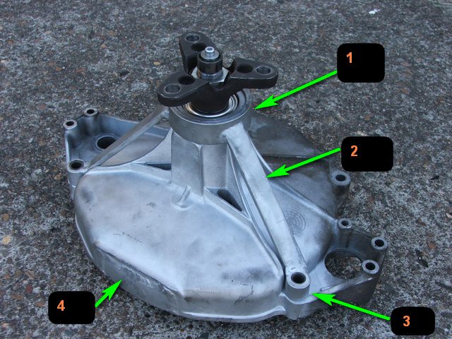

The clutch housing brace, spider, stiffening or whatever you want to call it is made like this:
The alloy housing around the input shaft bearing is first first machined down a little to make sure the casting is perfectly round.
This is followed by "shrink" fitting a steel ring around this machined part. The shrink fit is important so that it is a very tight fit.
Next the bracing parts are welded onto the steel ring.
HOWEVER>
Before the welds are made, the brace "stand offs" are positioned into place and the usual bolts that clamp the housing to the gearbox are installed and fully tightened up to keep the stand offs in the correct position once they are welded as the welds will naturally "pull" components around otherwise.
Housing Vent Gap
The second part of this housing stiffening involves the installation of a piece of aluminium into the housing vent cut out. This will restore the full circle perimeter stiffness of the housing. Be sure that during the welding, the housing is fully clamped all round to a solid and straight base to prevent warping during the weld.
You can drill a few 8mm holes in this plate to restore some breathing but the residial cut out in the gearbox side will suffice anyway.
So to summarise.
Install ring.
Bolt up stand offs.
Place bracings in place and weld up.
Weld in housing vent plate.
NOTE : Due to the extra combined thickness of the stand offs,clutch housing and gearbox members, you will need longer bolts to clamp it all together

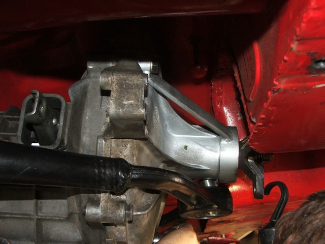

The minimum braces would be two but you can fit up to four (see below).The two brace version lives on in the Flying Brick. Never broke a housing since.

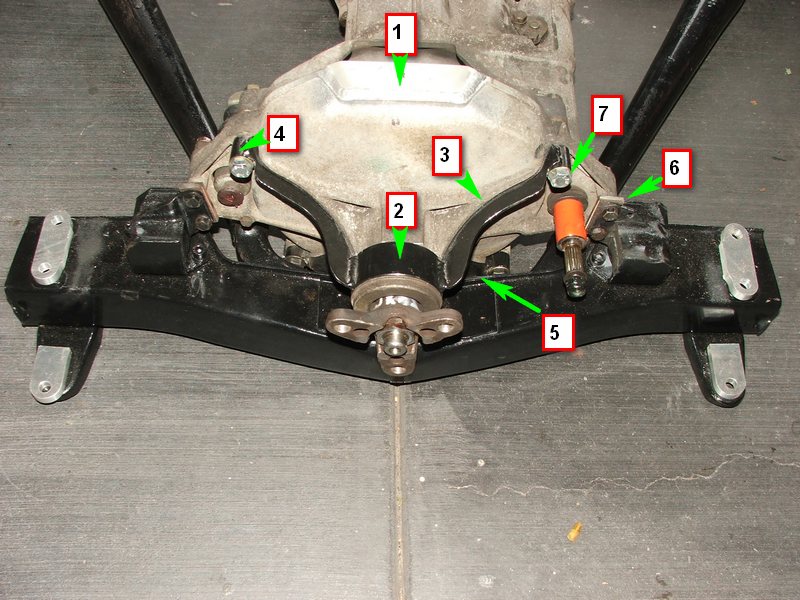

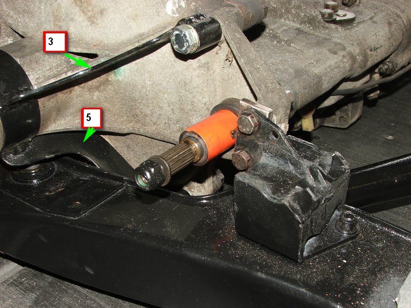

PART 2 , Revised Version
The first two photos show a curved 4 brace version that gets around the crossmember issues and is inherently stronger. This is now the version on the Cab.
The key to numbers in the photo.
1> Stiffening plate
2> Securing ring
3> Curved bracing web
4> Fixing extensions
5> Lower web
6> 4mm packer
7> Longer bolts

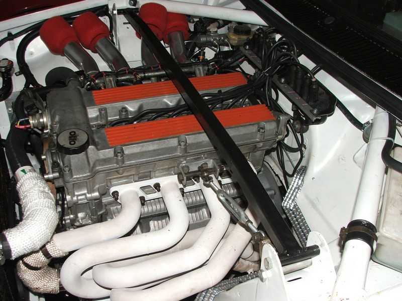

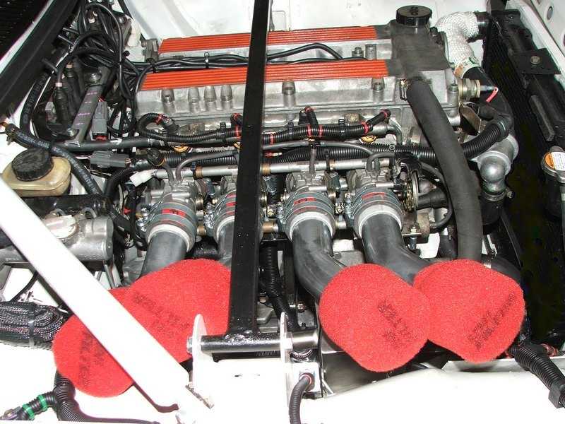

Some further evolutions of the cab:-
Initially running with 48mm throttle bodies tuned for bottem end torque.The TB's came from a Hayabusa motor cycle. Headers worked well and easy to install.
- 20 Engine exhaust side.jpg (67.3 KiB) Viewed 12431 times
- 17 Engine intake side.jpg (78.5 KiB) Viewed 12431 times
