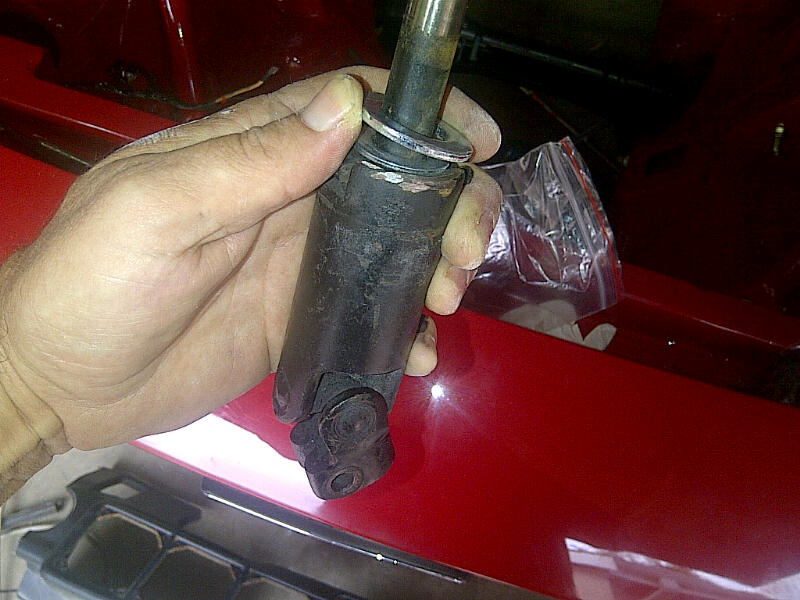

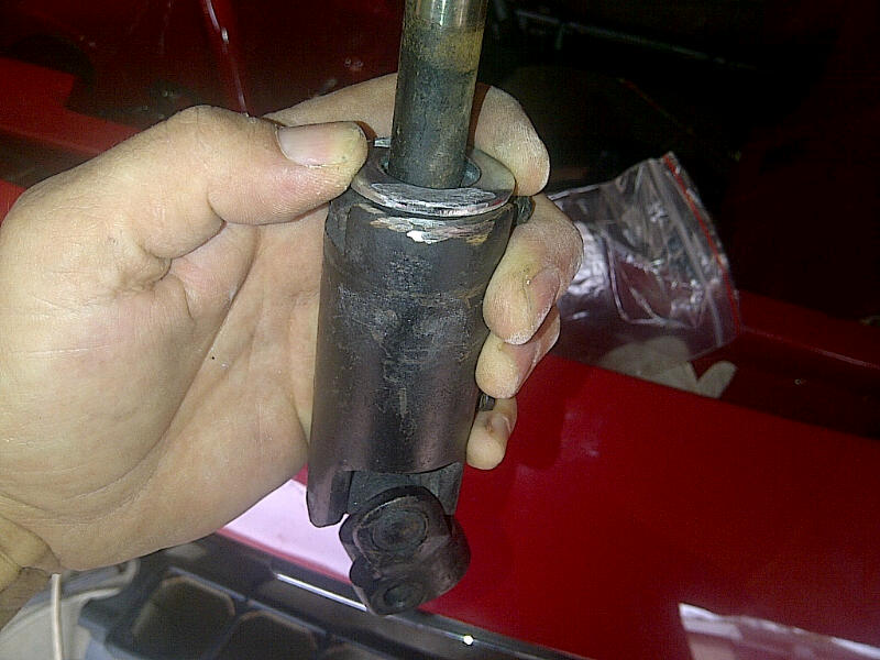

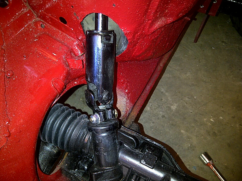

The steering bush got some treatment to prevent the rubber pulling out which has happend to me before . Took one galv washer , ground the galv off and got a pro to spot weld it in two points . Note you can only do one spot weld at a time and must hold unit ( i was about to shaft then bush and neither sounded good - so unit :oops: ) with damp cloth to keep temps to minimum . `Dont want to upset rubber bond inside.

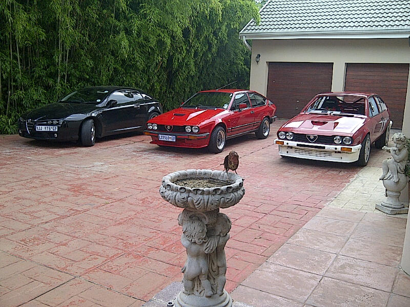

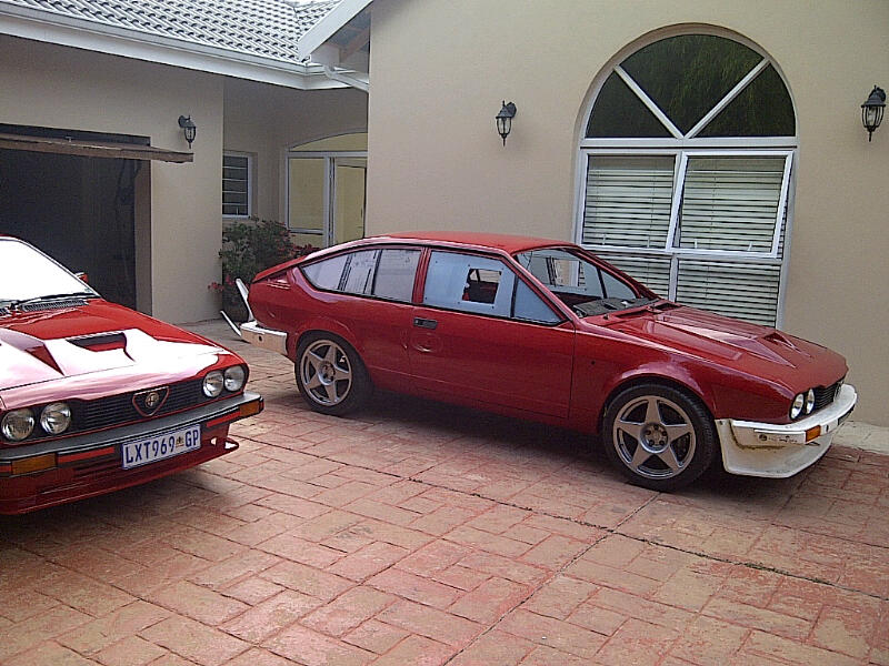

Took the project2 car out today for some pics in the drive next to my carb GTV and my wifes Brera . The GTV brings style to the Brera :D
Project car will go back to be painted this week with bumpers. Im thinking of doing bumpers in red with insert trim in black . There will be no striping down doors or any other trim on the car , except for rear vents and mirrors. The search is on for mirrors.

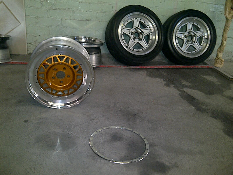

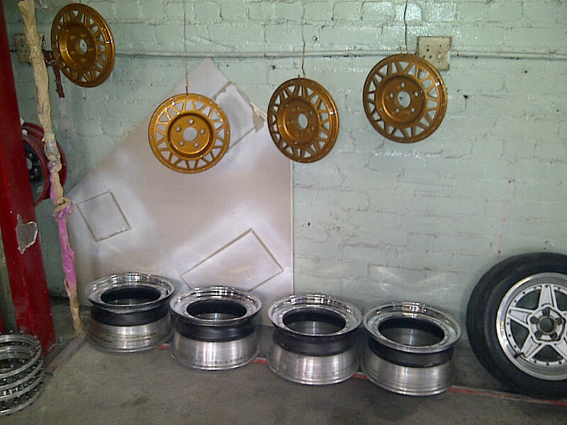

The 17'' compomotives are only used for road while i will use 15'' for track which i prefer for handling .

Some pics of update on wheels, New Clutch, and Wheel arches

New Wheels 2
New Wheels 2
kevin 18 wheel2.JPG (101.77 KiB) Viewed 11799 times
New Wheels 1
New Wheels 1
kevin 13 wheels.JPG (91.64 KiB) Viewed 11799 times

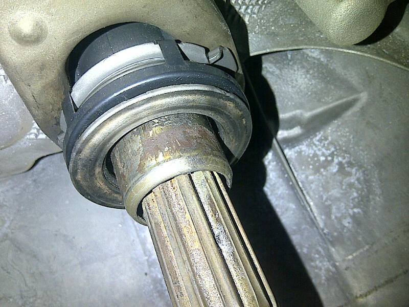

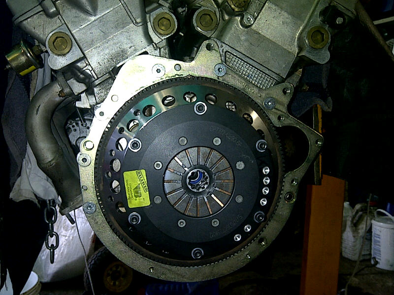

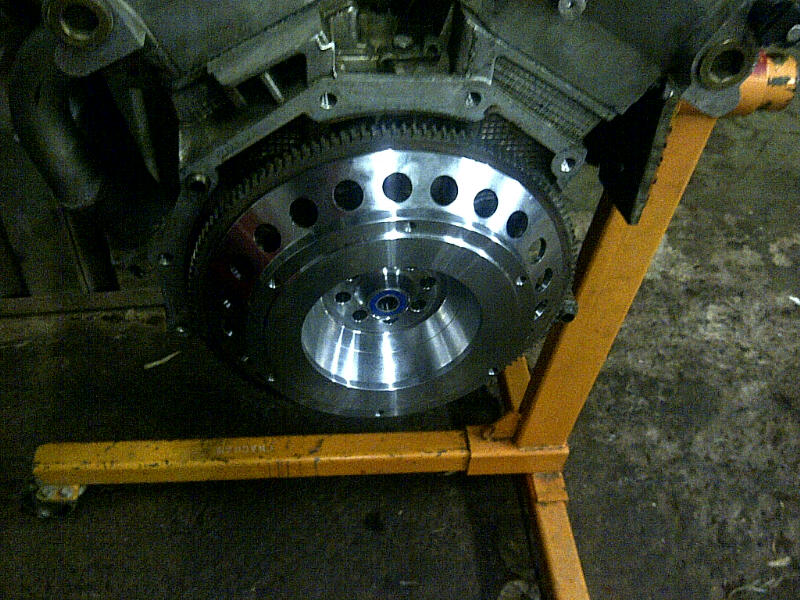

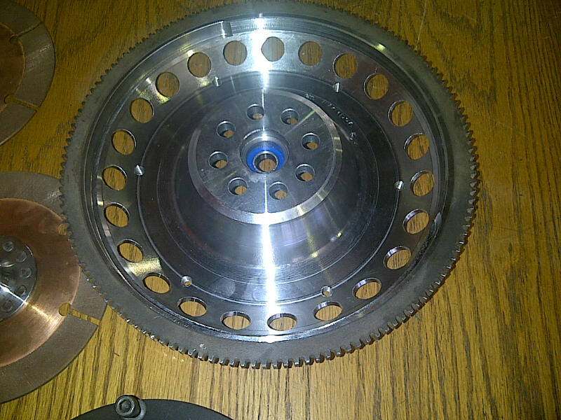

Thanks Giuseppe postings pics as all my stuff is on water to uk . I am still here for very short while while I try finish car and wrap up . Took absolute ages to get this clutch right but jury is still out on thrust bearing as I converted a flat face to round face which you need for these clutch fingers .

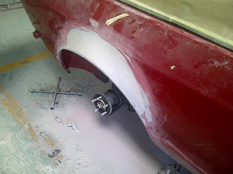

BTW, are the rear arches widened? I plan to put 1" H&R spacers with extended wheel bolts. what was done to the arch? Cut small slots perpendicular to the radius of the arch and pull it then re-weld the slots? I need to do that. The 75 have impossibly small wheel arches. The track is also incredibly narrow compared to things like the E36. I have 17X8 ET30 wheels and am planning on fitting 235/40/17 Nitto NT01 tires on the car.

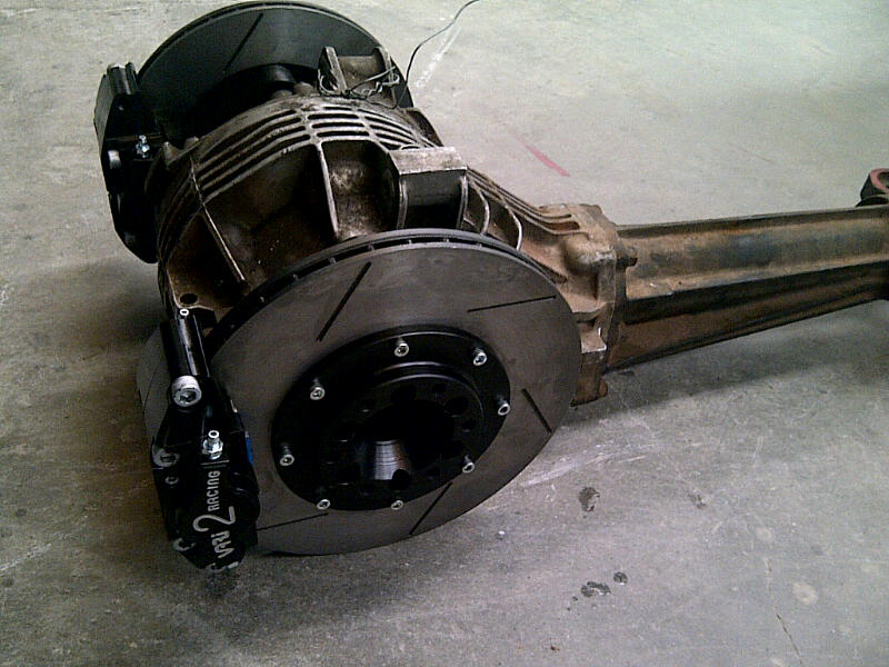

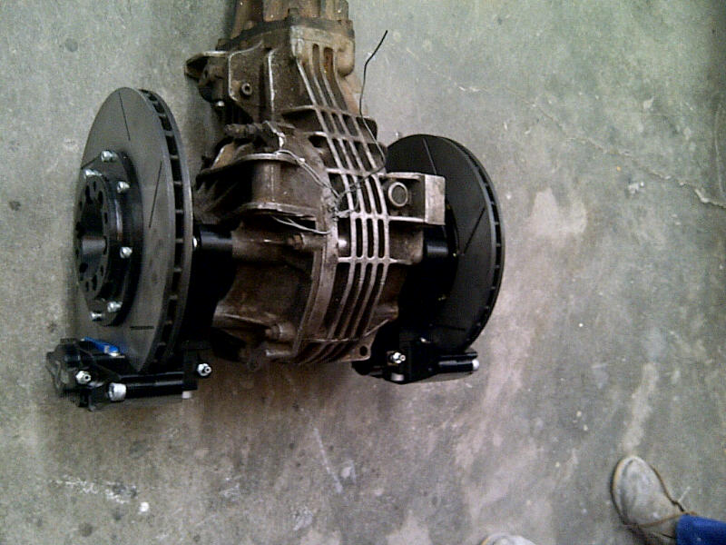

Right - a further update and pics ..

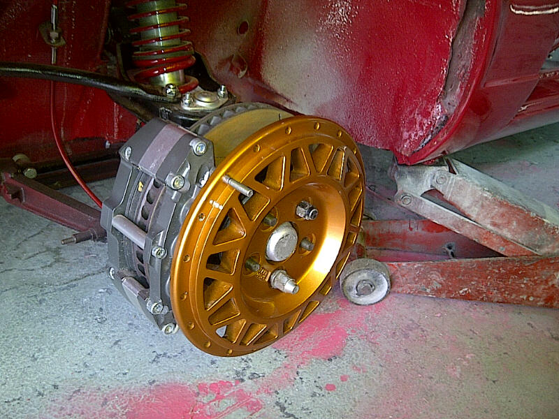

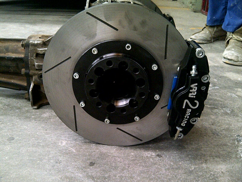

Firstly = Rear Inboard Brakes
brakes 3
brakes 3
Brakes 2
Brakes 2
inboard Brakes
inboard Brakes

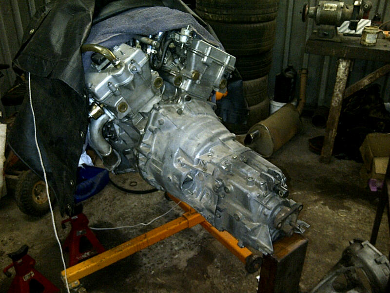

Some more Pics, as project nears completion
AND BOX FITS PERFECTLY
Kevin 31 Box fits.jpg (99.94 KiB) Viewed 11719 times
Thrust Bearing
Thrust Bearing
Kevin 32 Thrust bearing.jpg (107.53 KiB) Viewed 11719 times

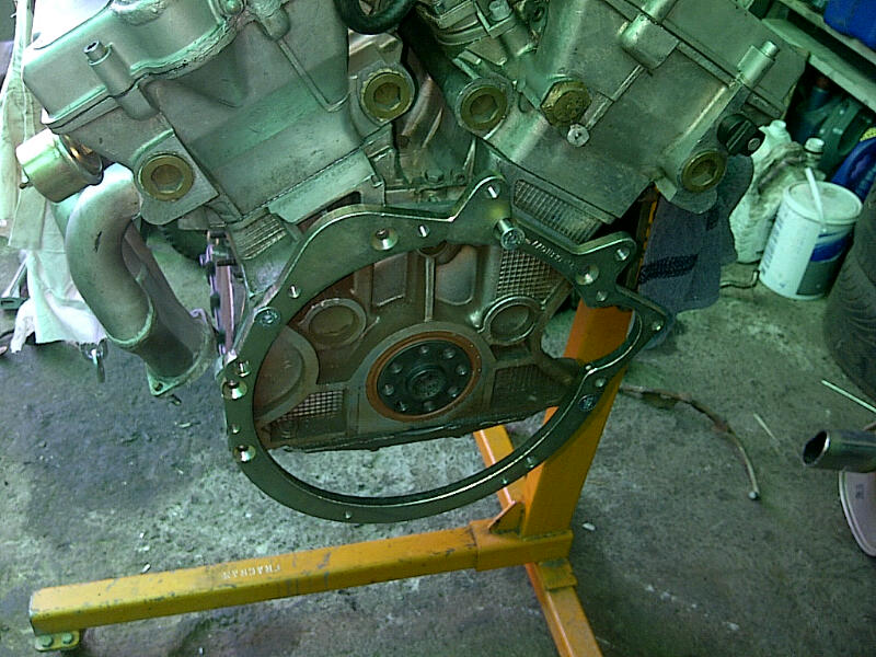

New hole required for Starter Motor
Kevin 33 Hole for starter.jpg (107.02 KiB) Viewed 11719 times
Clutch Fitted to Motor
Kevin 34 Clutch.jpg (102.5 KiB) Viewed 11719 times

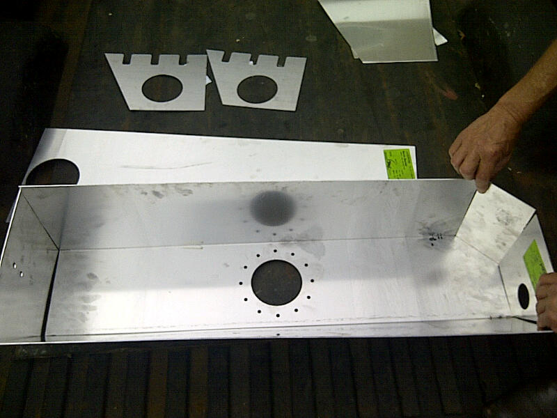

Seems as if I missed a pic... here is the petrol tank being built up

75evo , cutting small slots to widen and then welding will work as that what was on the 155 . I only needed 20mm so could still rolled it out with tyre on . The lip inside must be filled with silicone otherwise it fills up with dirt and rusts .

Regarding the tank , it will get a surge tank inside where the return will run into . The surge tank will also protrude 70mm under . I have made three compartments with baffle plates and hole just big enough to pack " sponge" in . The tank will hold 36litres and falls 40mm to the surge bottle . It also tapers in two directions as can be seen in pic.
Basically I am trying to copy my old set up but all combined in one tank . It's such a win when your mate owns a laser cutting factory and is Italian . So he makes time for my strange drawings to be captured , corrected . Wait until you see the floor mats made out of 2mm alumin with anti slip holes cut in and the Alfa GtV 6 logo :D
