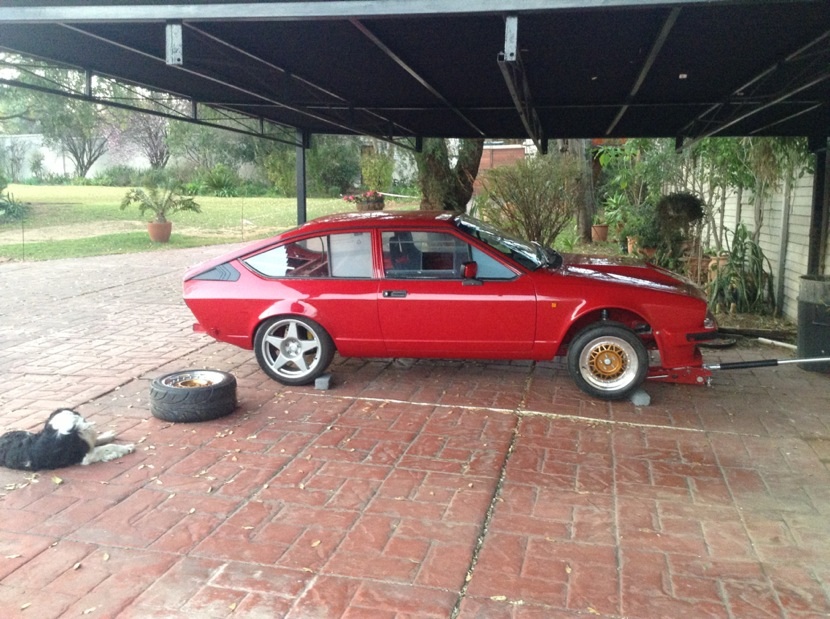

Trying to keep mess to a minimum between the two cars. Previous page shows at least their was some good sunlight for a mid winters day to work on the cars.

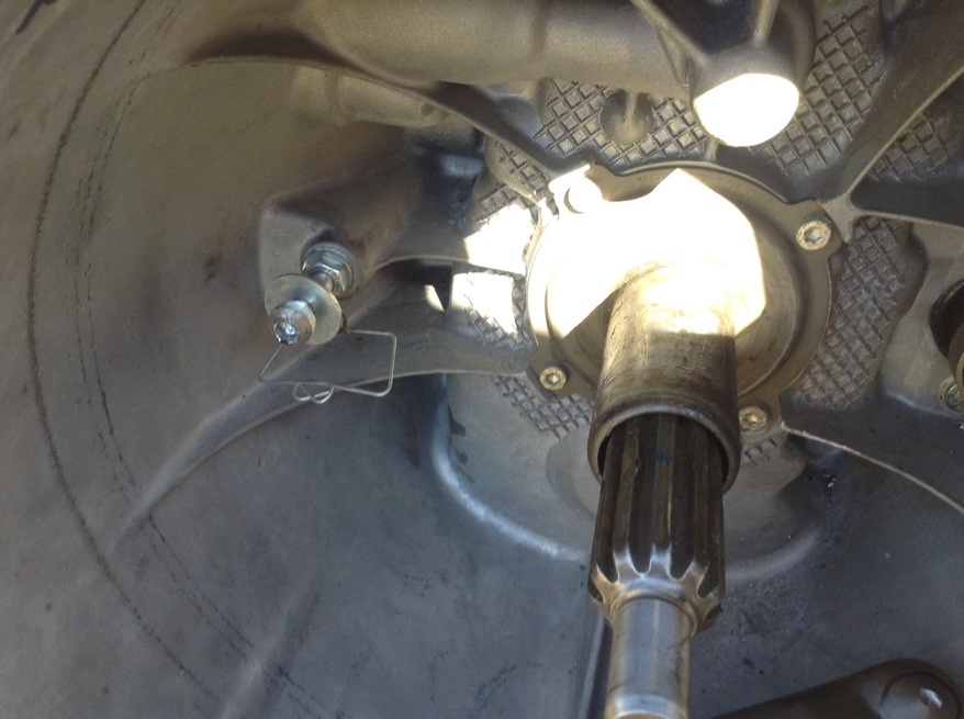

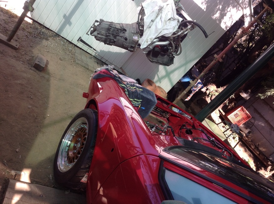

Made and extension to pivot in clutch housing . Extended by 20 mm and then reduced clutch pin by 10mm and now it works perfectly . Finally got engine back in this afternoon started about 9am this morn . Realised its actually quicker to put the front mount box in with sliding prop .

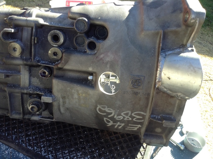

Made an inspection hole with a rubber grommet to fit .

Already to go back in .

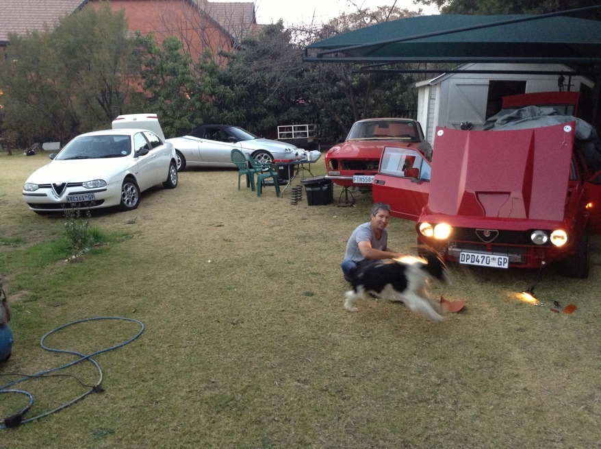

Hey , should have come around today . Been doings some nice burnouts ha ha . Spent most of day doing wiring but still got a short somewhere in the indicators wires - aaaargghh .
I got caught in a road block yesterday on R55 . Now their are no electrics on the car but they were more interested in trying o fine my dad who was driving the 156 in front of me because he left his licence at home . Any way they let him go and I tried desperately to make smooth pull off without leaving black stripes with this clutch and extremely light flywheel . .

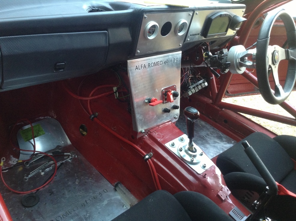

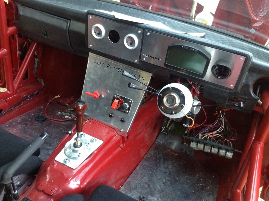

Finally got all electrics working , apart from one headlight but that's simple . At least there are no shorts . There was an alarm in the car previously which was removed and the wires were never taped up properly .
Dash is all in . Put spare gauges in even though all is the Dash 2 display . The smaller holes on dash is for indicators,headlights, etc so at least I can pass MOT .
All the extra bits have weighed in 4kg . Re bled the clutch today through the 50mm diameter hole inside of the tunnel . Makes life so easy . Don't have to jack car up .

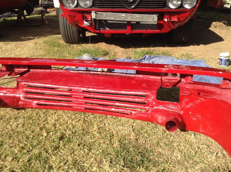

Just finished off front bumper with air ducts in for brakes .

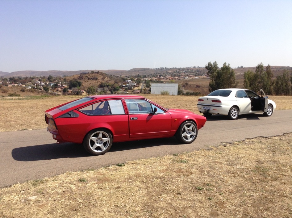

Completed front spoiler , now starting rear bumper . Clutch still not bedded in yet , not sure if it will . Still either on or off .
Took the road tyres off and put the semis on today . Now I need to lower it some more to 13cm under front jacking point .
