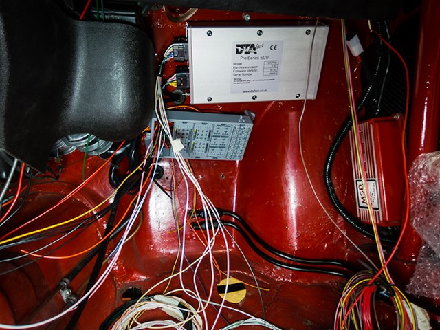

Re: Alfetta GTV Turbo - Race Car update. 85% done.
Some cool work going on here!
Some questions for you:
What is the grey box under the ECU?
Are you using the 60-2 crank angle sensor and a reset trigger in your distributor to allow you to run your injectors in full sequential mode?
And how much do you think the whole car will weigh when completed?
- ECU-install01.jpg (149.85 KiB) Viewed 15325 times
Thanks.
The grey box is a modular fusebox system, holds all the fuses and relays. Extremely nice to have a 100% customizable home for the electrical system.
I will use the 60-2 pulley setup but no home signal, batch fire injectors are fine by me. I have heard about gains when running sequential and controlling injection fire angle but that has been high strung N/A engines. Simplicity rules.
I hope the car weigh in at around 950 but maybe more, turbo, intercooler, big brakes, huge wheels and so on. Fingers crossed.
