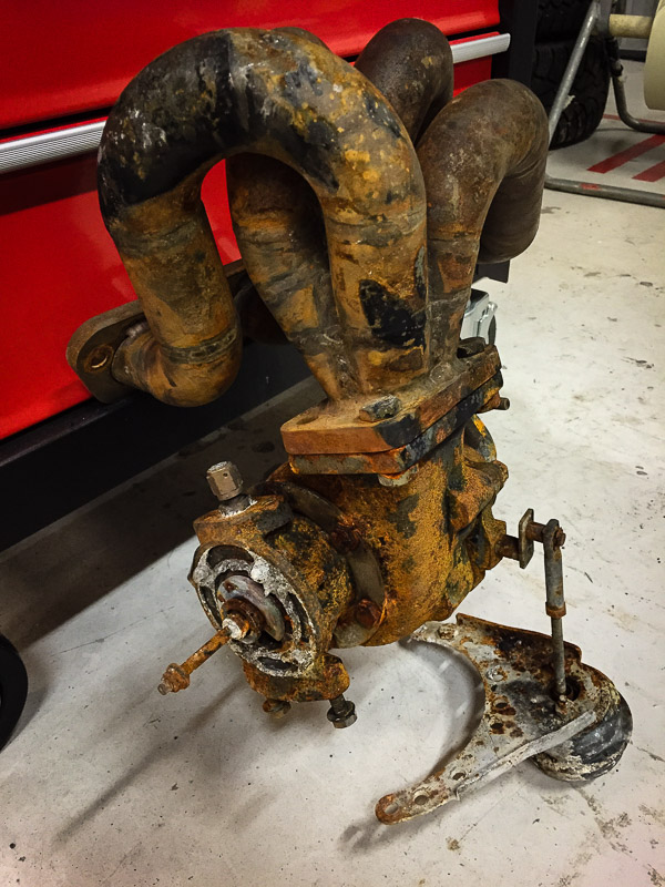

Ok, so if you haven't heard already my whole workshop and everything in it was destroyed in a HUGE fire Dec 1 last year. Everything, and I mean EVERYTHING in there was destroyed except for one thing, my Turbo manifold.
A friends Lotus Elise was just gone, literally nothing left.
So there won't be any updates here again I'm afraid. Too bad I never got to start the engine and try the new everything on the car but that's life I guess. Still got my health and family so I'm pretty ok.
Still haven't decided wheter to keep the manifold in it's current state as a memento/conversation piece or to polish it up and sell it to finance some other parts.
Here is what it looks like now:
- It'll buff out...
- Manifold.jpg (193.82 KiB) Viewed 17857 times
