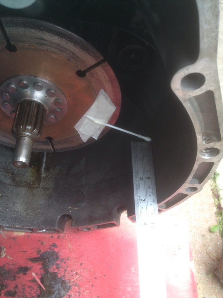

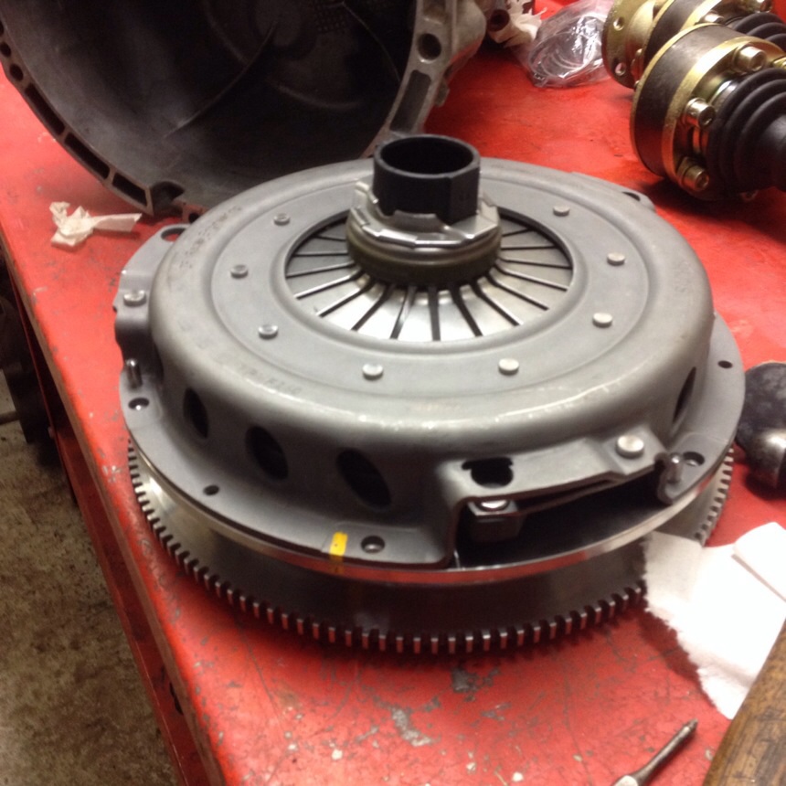

Finally got around to getting another clutch made that will make car more street usable . Was bit of an effort pulling box out in the drive especially with a turn in the weather did not make it fun . Once clutch was out I made a home made dial gauge to measure max distance the proposed E34 M5 unit could be pushed back into the box .

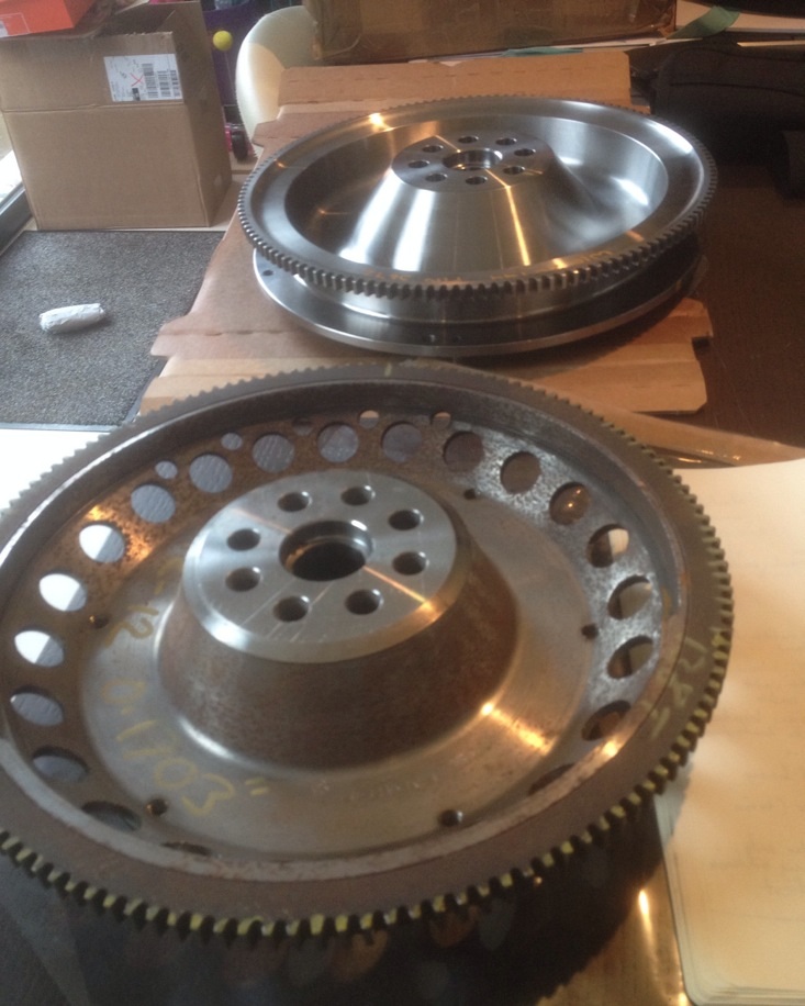

I sent all the dimensions from this pic off to TTV racing who made a new flywheel for me in one piece . Flywheel weighs in at 5.6 kg . From here I took to flywheel to have the inbalance copied from my original . Luckily their is a chap who specialises in this type of balancing here in Uk at Basset Down Balancing . Some pics of two flywheels together .

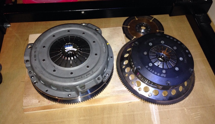

Small progress but making sure it's perfect with regards to the clutch fork pivoting . So had to measure exactly where thrust bearing would be sitting then set up fork just slightly off 90 degrees . Also needed to check clutch slave pin can extend 22mm in its starting position and does not run out of travel . Manufacture of this clutch recommends between 8-11 mm travel of thrust bearing thus giving 22mm on ends . Total travel of slave pin is actually 48mm . Once in car and system is bled I will put stopper in under pedal after working out where clutch disengages . Some pics just showing clearance with out any mods on the inside of gearbox and adjusatble pivot pin which hopefully will not need to reset .
All this is nothing new as I had to do this with the small AP unit first time around .

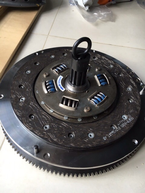

Been waiting for my clutch alignment tool to arrive as my home made socket type had little to much play . So finally it did arrive this brilliant nylon alignment tool . It's absolutely perfect . Had to import it from states but it was only few dollars . If I was in SA I would have just cut up one of my scrap bmw boxes for the input shaft ... But I'm not there . Pics attached .

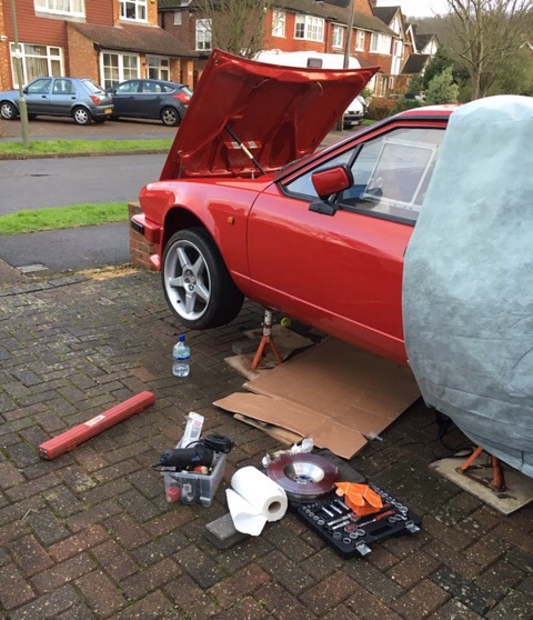

So waited for temperature to rise from a low -6 degrees and rain to stop , borrowed a torque wrench for flywheel bolts and realised the torque wrench is 100mm to long or the car is 100mm to low . ( jack way past it's jacking height ) Had to laugh :D so work will continue after I go buy a correct torque wrench for driveway jobs :oops:
Torque wrench in red box on floor next to car .

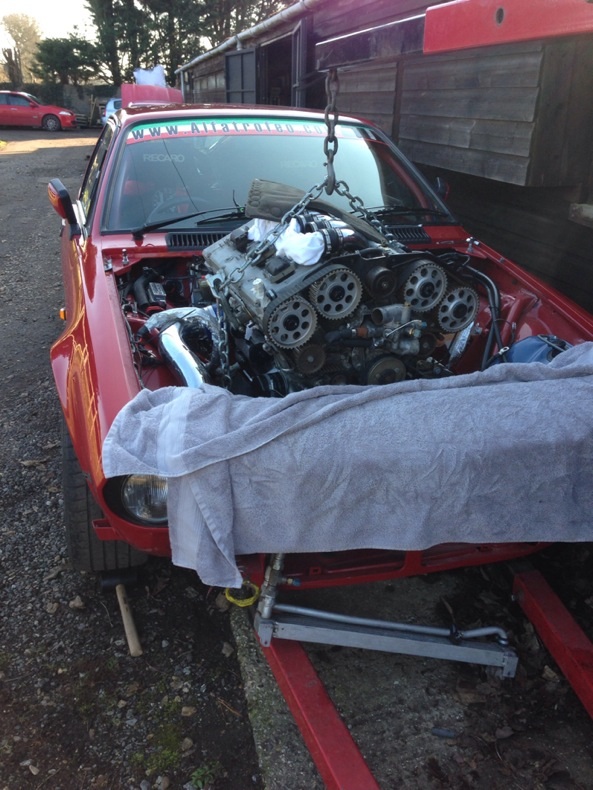

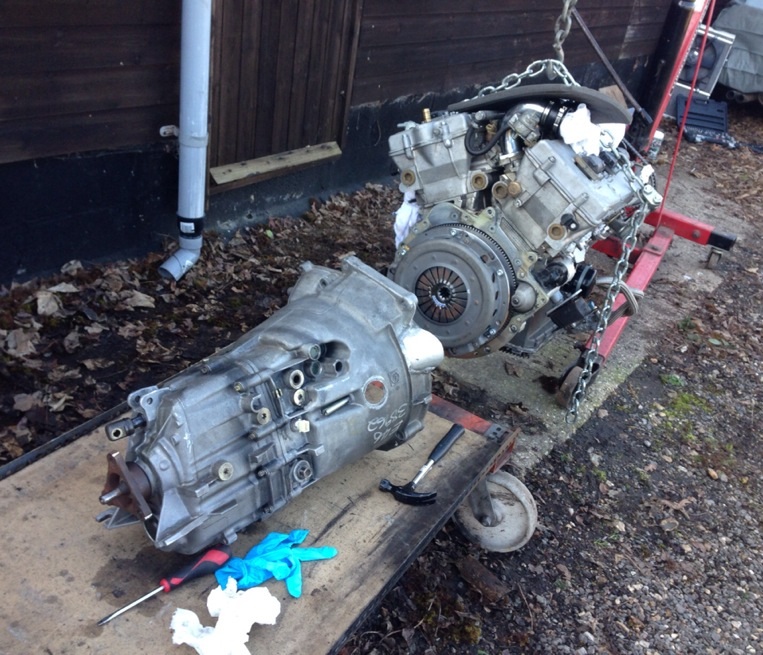

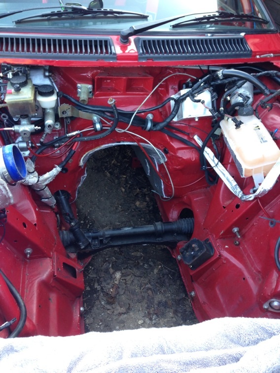

The weather has finally got a bit warmer ( a mighty 8 degrees) and the rain has stopped for a week so it was good opportunity to pull engine out and attach gearbox . It's actually much easier to do this than put box in from underneath . Also I could see perfectly the new clutch and fork position through the viewing hole I made on the side of the gearbox . Took three hours it's to of us to take engine out and put engine back in with gearbox attached . Next weekend work will continue . Some pics of new unit on engine .

Cheers thanks , gotta make a plan . Got it all bolted together about half hour ago before it started to drizzle which is forecast for entire weekend . Clutch works beautifully and much more user friendly ( obviously) than the tiny race Ap unit . Pretty happy about that . Will have to do some videos some time . Next mods are on gear linkage and throw are already in pipe line . Had to cross over to dark side and read up what they do on the BMW forum . Good thing is huge improvements can be made by buying gear lever from the MZ4 which has the ball much higher up ie more throw .
