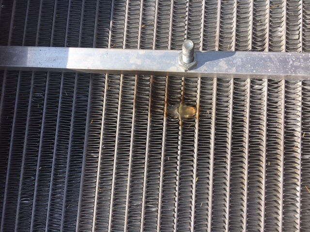

Devcon is great stuff and I have used it in many applications. However my choice here would be to weld it as per video. There is not better repair than that. I would not trust Devcon in the long run for this job. Last thing you need on the track is having coolant problems.

Thanks MD .. I will go with your advice and get it welded . My mate with the black 75 showed me a link on FB and have no idea where it was when I recognised the Cab ! Such striking colours hard to miss !

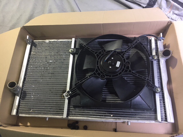

MD , I decided to take the radiator a radiator specialist and they gave me two choices , either fresh new core ( which was crazy priced) or they use an epoxy which is applied when the effected area has been heated right up . There is no warranty on this option but it held 15psi no problem. I have got a new radiator in mind but will have to wait for next years budget

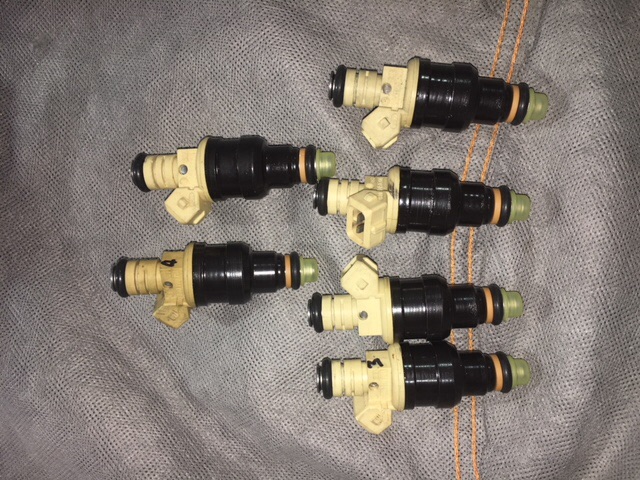

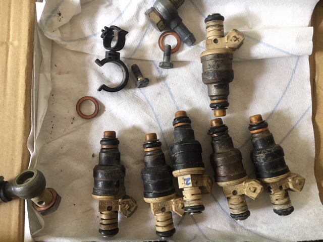

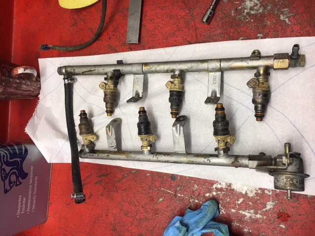

The injectors were last serviced ten years go so thought I would send them in for full service to Mr Injector UK . Apart from the three usual checks they replace filter, caps and O rings .

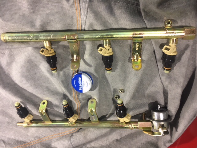

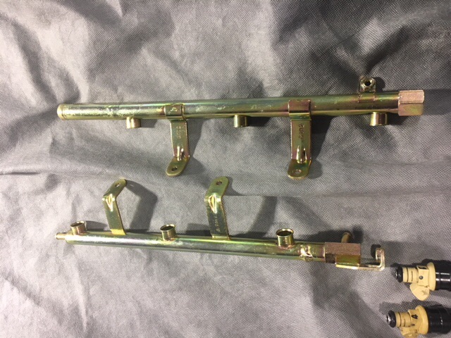

The fuel rails were sent to our electro platers as they were looking tatty .

Good thing I had injectors tested as no 5 was only injecting half the cc , no 4 had leak and number 2 spray pattern was not consistent . Got them all back and they look like new !
Also got the fuel rails back ... Looking very bling

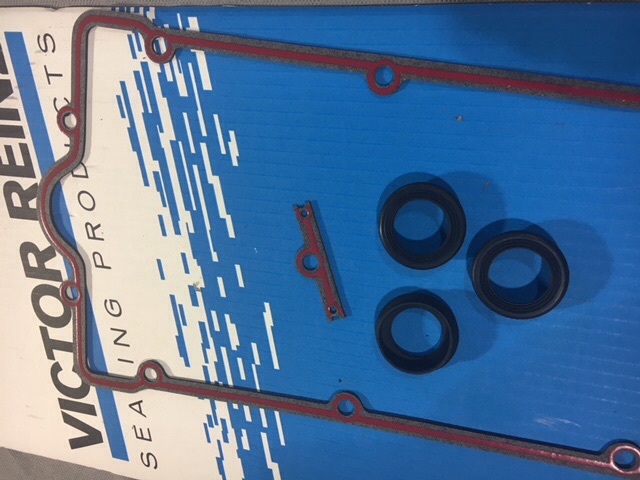

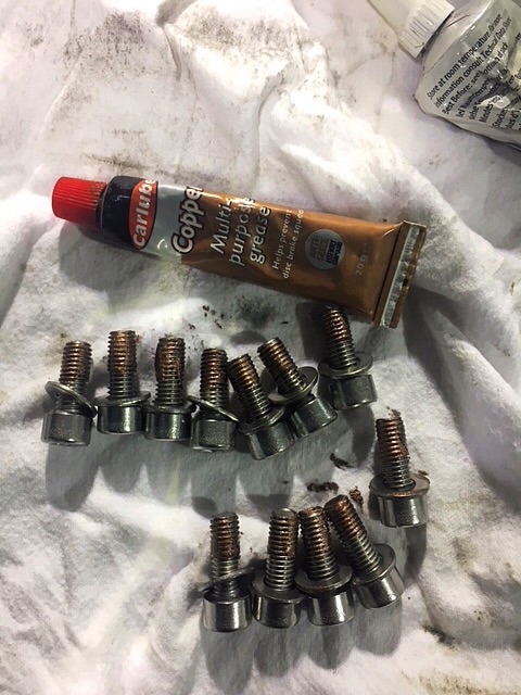

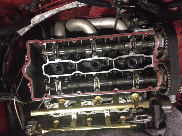

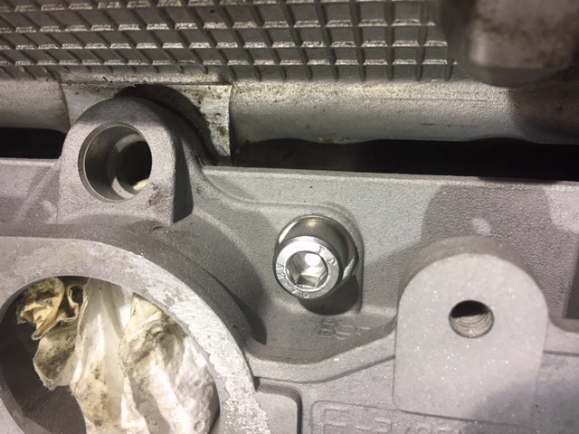

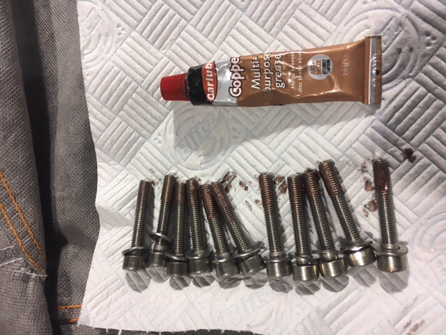

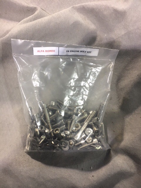

I had quite a few cam cover bolts ( 7mm) with rounded edges which needed replacing . I found this link on another forum for complete set for the cam area ( top of engine ) . Very impressed with this kit .

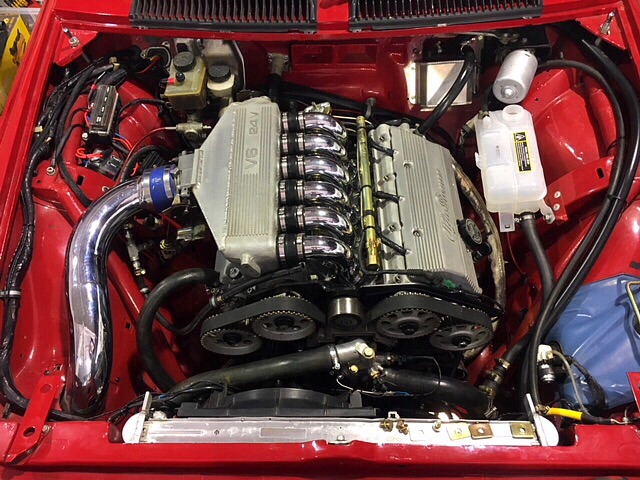

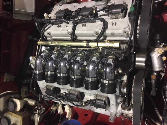

Used some Autosol on the intake runners and fitted those with new gaskets .

Glad you liked the kit. its pretty comprehensive. Me and toxic put it together on the alfa forum and got stig fasteners to add it too their site.
Maxiboy .. I never knew that . It's an excellent kit and you can see that some one knew their stuff when putting it together . Well done !

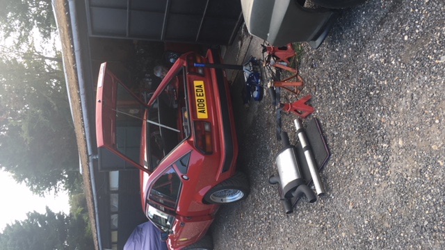

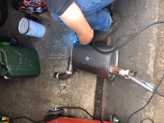

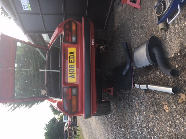

Last Goodwood trackday car was to noisy with the side exit even with three boxes it failed . So realised side exit will always be to noisy so that's when I fitted the Ansa box ( rear silencer ) which I found a bit to stifling and it was not a free flow . As we know we can send the car in and get a super professional job or we can continue keep the costs down and the fun up and do it in the workshop . So bought a few bends from Jetex and used a rear box I brought back in my luggage from SA made by powerflow. It's ia straight through box with a curve inside. But for those Motorsport dsiplay days I have also just a straight through pipe which sounds magic !

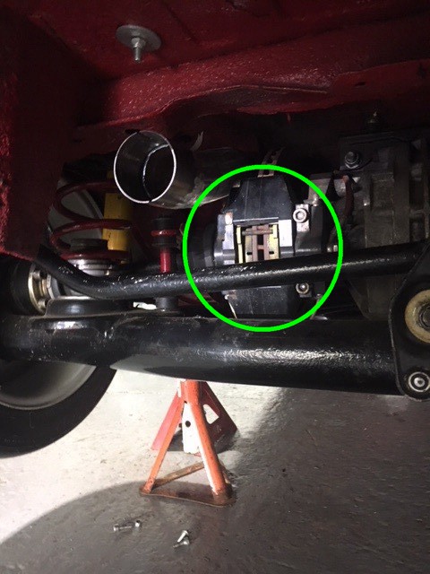

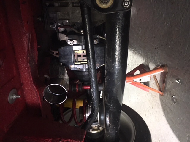

Kev,
What is that rear caliper?
