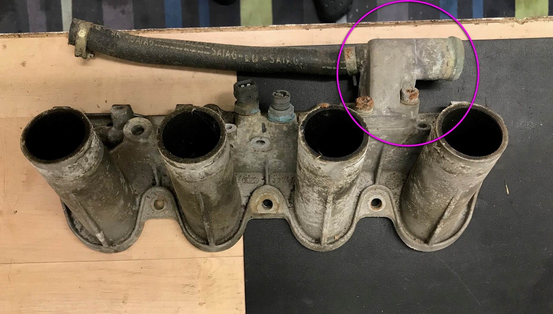

So let the games begin and right up I need some help.
So I can make up a foreign intake manifold on my intended engine, I need some parts from an Alfa 75 turbo series manifold.
Specifically the coolant gooseneck connection in the photo. The rest of the parts I can probably source one way or another but that coolant connection is a must.
IS THERE ANYBODY IN THE WHOLE ALFA WORLD OUT THERE ABLE TO SELL ME ONE ???
- Manifold 2c.JPG (248.24 KiB) Viewed 2831 times

Moving on. Decided to reverse engineer the coolant coupling. Got a mate with a CNC machine who will make it for me from billet.
I have finally cleared all the backlog of servicing the family vehicles as well as buying and selling some cars so now I can return to this project.
Got my headers made and have started to design a racking configuration for the supercharger. I find this stage both challenging and very satisfying when you finally get the set up right. Always looks deceptively simple in the end but anything else in practice. Nearly there.

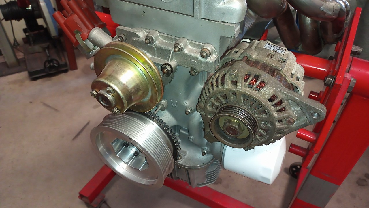

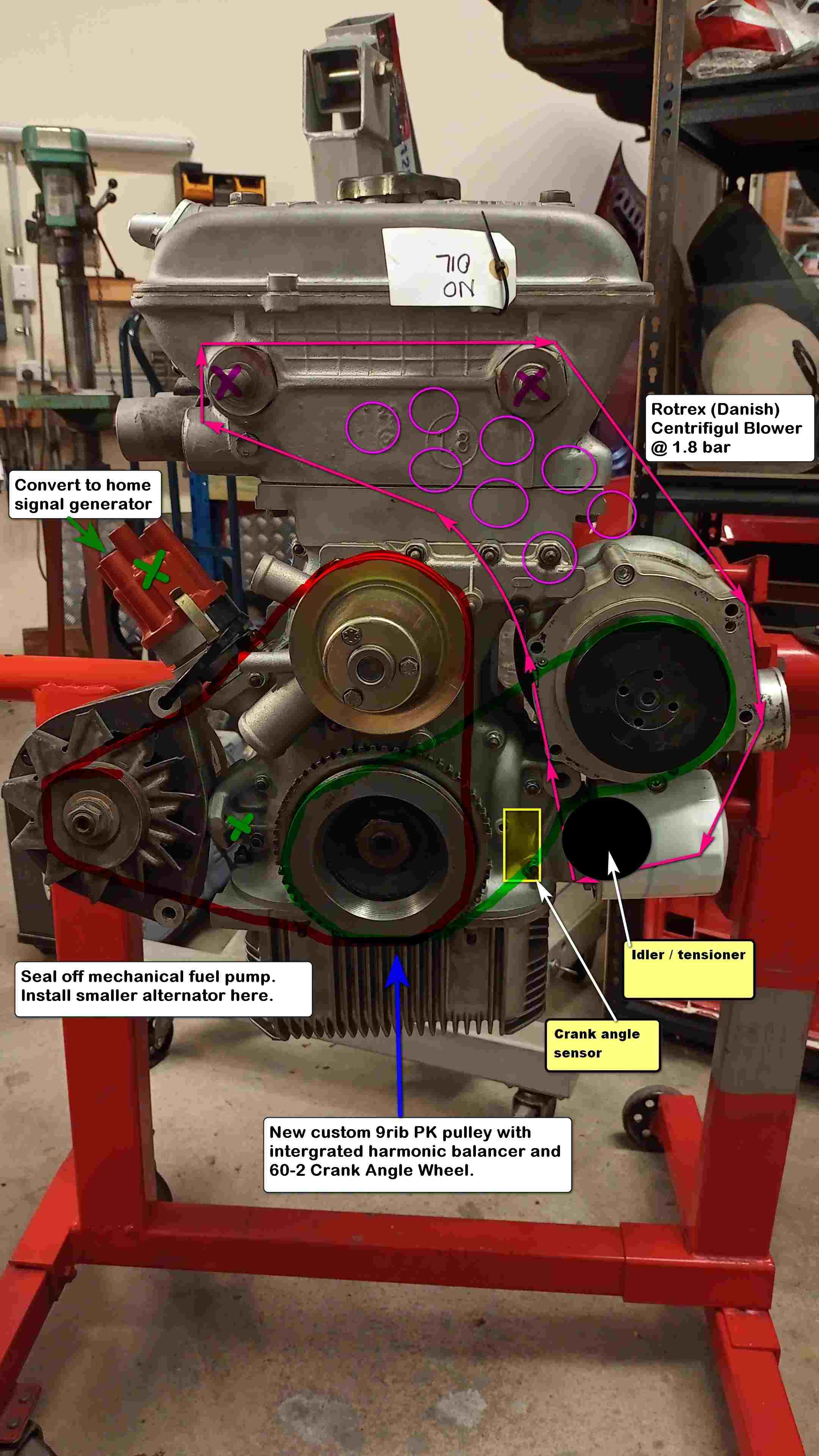

The engine is progressing. It's fully assembled now. Here as some visual updates.
Goodness me the world has changed in such a short time !
So let's talk Alfas.
- Blower fouling.jpg (246.85 KiB) Viewed 2580 times
- Potential Blower Alternator Positions.jpg (248.34 KiB) Viewed 2580 times
- Headers in progress.jpg (238.66 KiB) Viewed 2580 times
- Installed Manifold.jpg (245.08 KiB) Viewed 2580 times

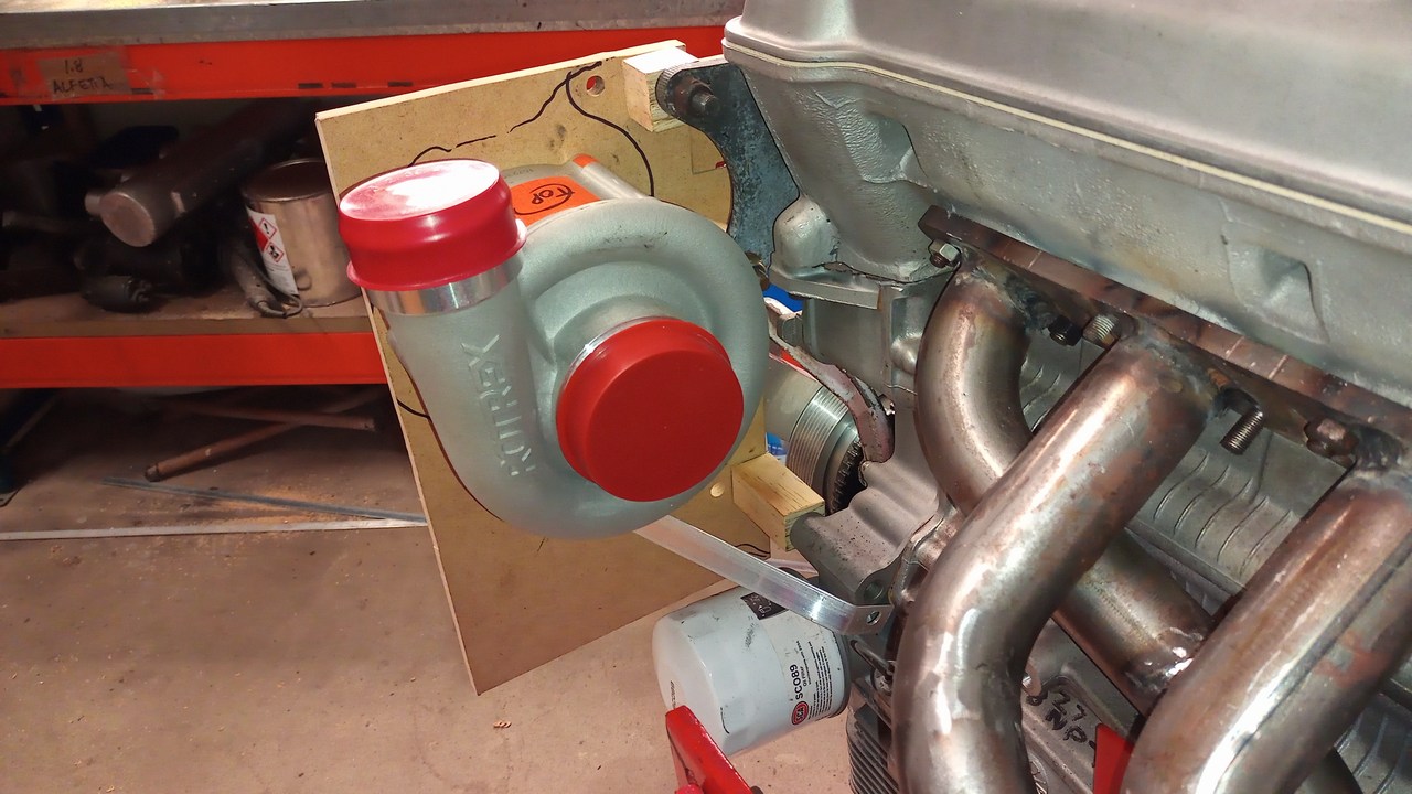

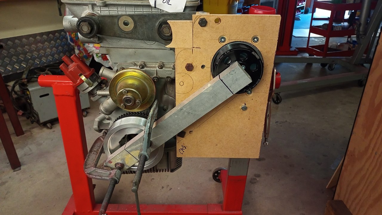

Slow porgress for many reasons. Working around a bunch of other cars and doing my 75 when I get a chance. Waiting on machine shops to get my custom stuff made these days takes an eternity.
Here's a couple of frames indicating a tiny amount of progress.
- Raised blower location.jpg (230.91 KiB) Viewed 2150 times
- New pulley is in.jpg (239.69 KiB) Viewed 2150 times
- One possibiity.jpg (239.62 KiB) Viewed 2150 times
- Experimental positionings 1.jpg (243.62 KiB) Viewed 2150 times

Looking good!! Supercharger setup is looking good……But from the photos, the exhaust header angle doesn’t look to be in compliance with the holy book by the Greek pope.
Re: "Patches" MD's Final Racing Project
That's because I use a unique formula to make the calculation . That formula is as follows:-
The angle of the dangle, is proportional to the throb of the knob, the heat of the meat and equal the sag of the bag to get the scoop of the droop. To keep it rust free you must apply knacker lacquer which adds luster to the cluster and glamour to the hammer (finish)
When the equation is right you just know you have a great header.
I am not able to make comment on the Pope's extractor.
These examples are a work in progress and may not eventually work out to be exactly as shown. The reason being that I prefer to have the discharge outlet to point downwards so as to orientate towards the inter cooler that will have the piping around the lower sections of the engine bay. However to do that fouls the position of the alternator which means that the alternator should ideally be located on the intake side of the engine. That presents a mounting challenge but I have done it before and it is actually better for it as there is less heat from the exhaust headers. I also prefer that position for the SC and I have it there on the current Alfetta racer. It just means a lot more noodling and plumbing to make it happen.
