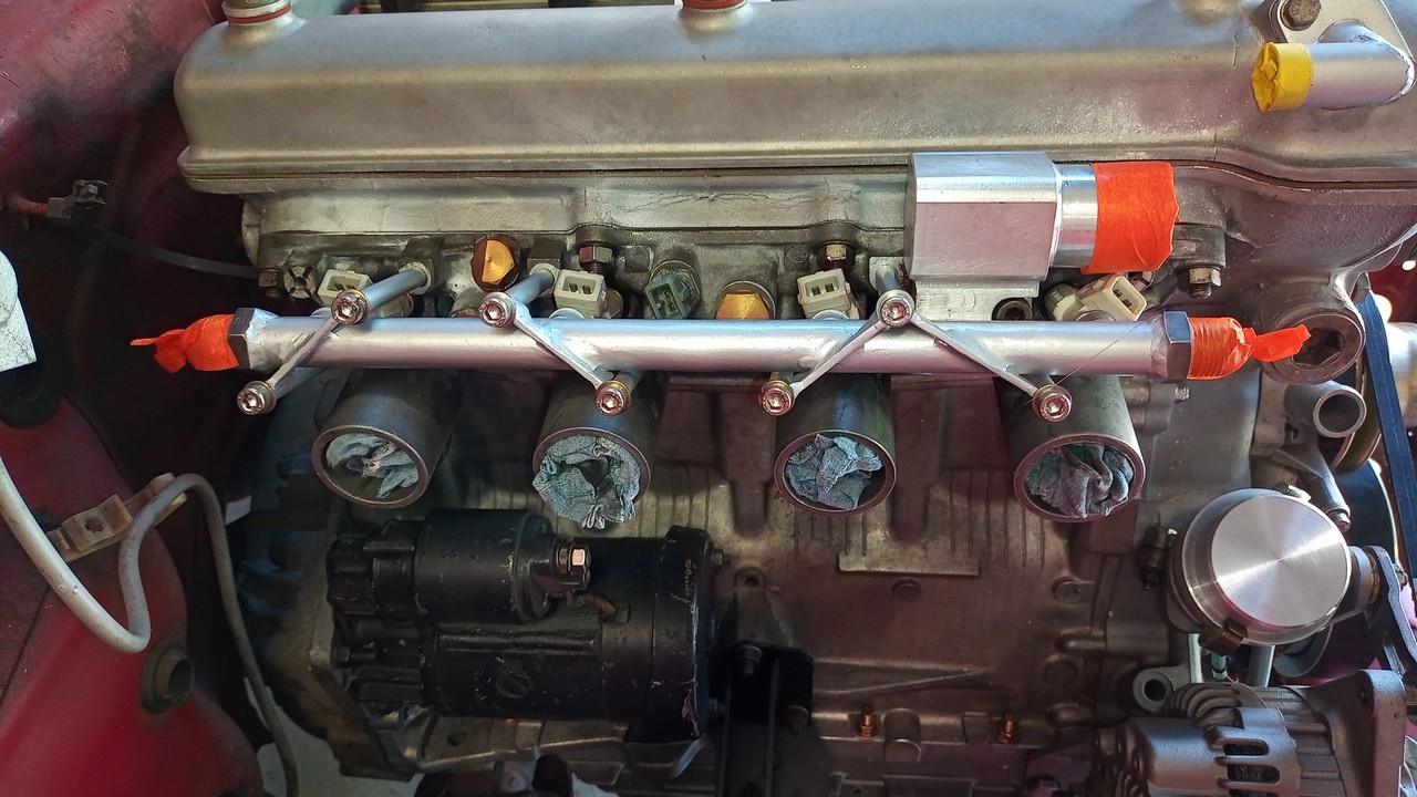

Intercoolers, hmmm. Been thinking of water to air but expense is holding me back somewhat. Truth is, I am undecided and need to dwell on it longer.
As you can see from the photos, making some quiet progress. Of course I am expecting industry delays over the Christmas holiday break.
I am amazed at the amount of room left around the engine bay. The headers are a little tight near the firewall but not going to be problem.
I am waiting on the arrival of a throttle body to weld onto my plenum so that will be the next thing to add to the engine bay. In the meantime I am trying to plan my wiring loom reticulation. Always fun to work with the electric spaghetti.

Aah Md , I see progress ! Thanks for sharing the pics of the supercharge set up . This will put some seeds of thought in my empty pip at lunch time .
