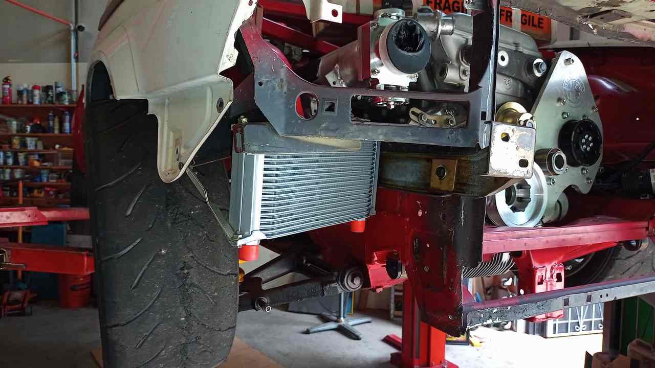

Some structural updates. The photos should be self explanatory. Any questions, fire away...
- Giulietta Radiator.jpg (117.05 KiB) Viewed 4204 times
- Resevoirs.jpg (104.44 KiB) Viewed 4204 times
- Coil over front end bracing.jpg (117.79 KiB) Viewed 4204 times
- SC oil tank.jpg (91.54 KiB) Viewed 4204 times

A few more..
- Filter & Cooler.jpg (131.29 KiB) Viewed 4204 times
- Engine oil cooler.jpg (114.8 KiB) Viewed 4204 times
- Intake plenum and throttle body.jpg (107.12 KiB) Viewed 4204 times
- Plenum and revised fuel rail.jpg (103 KiB) Viewed 4204 times

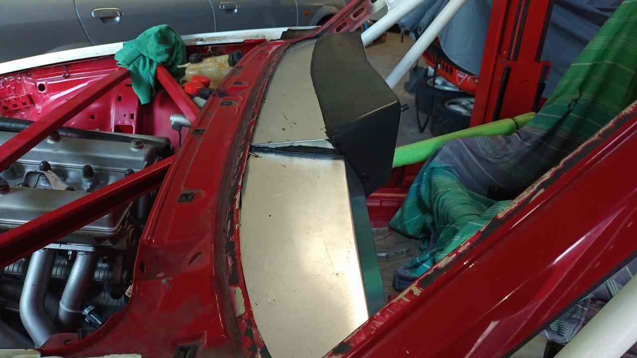

The Dashboard. A work in progress awaiting instrumentation panel cut-outs.
- IMG_20240322_093040_377.jpg (91.87 KiB) Viewed 4203 times
- IMG_20240322_093059_802.jpg (103.01 KiB) Viewed 4203 times
- IMG_20240322_093122_125.jpg (94.69 KiB) Viewed 4203 times

Sure you got enough braces on clutch . Your spider version is working well on all my mates cars . I even laser cut the whole set up for simplicity .

Regarding the bulkhead opening, it is not intended that it remains open like all the other firewall holes all over the place, they will all be sealed off prior to commissioning the vehicle. I am just showing work in progress rather that work totally completed.
