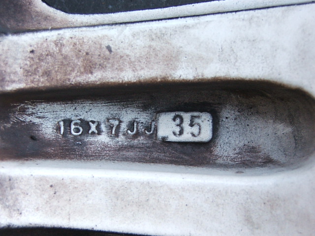

Duk -nobody recommends this for a street car, period. PM Daniel to do a conversion of your uprights instead. You will need 16" rims for clearance.

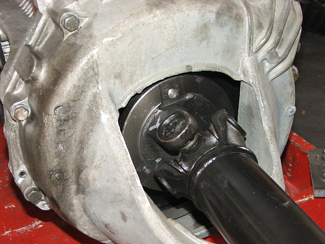

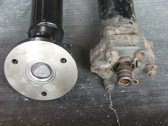

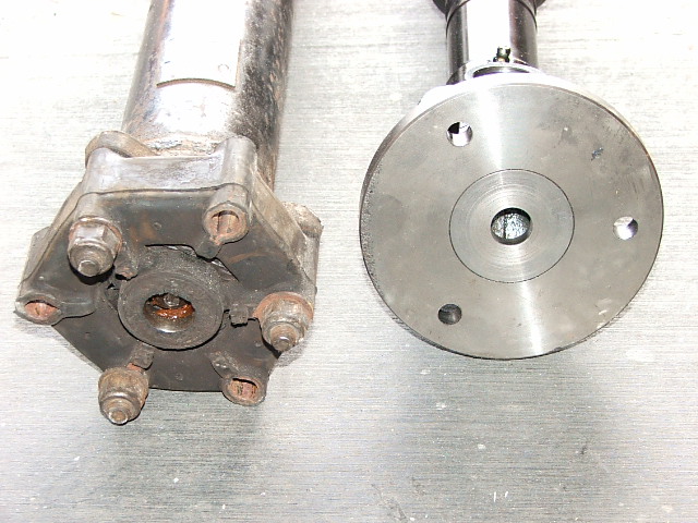

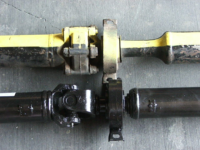

While we were discussing drive shafts in Kevin's topic set, I said I would post my driveline set up here. Well, here are some photos of the existing driveshaft for purposes of discussion.
I want to emphasise that it will be modified further to dampen away the hammering noises it generates at idle revs as I have previously said.
When I finish and test the revised version, I will post that too. This will be a provision for a rubber coupling to the front section probably from a BMW or Mercedes Benz.
Meantime, these photos should give you some food for thought. One of the great things is the slip joint at the rear section. This allows removal of the shaft without having to drop the crossmember supporting the gearbox. It also allows the positioning of the engine and the transmission in their general fit location without having to fuss over their exact location because the donuts maybe stressed . This is because the shaft is adjustable for length. It really does make a big difference to ease servicing.
The mounting is straight forward and the best thing about it, IT'S TOUGH . No more shredded donuts on burnouts-a few broken axles maybe or gears but no donuts to worry about. It is also cost effective to make coming out cheaper than a fully rebuilt original Alfa shaft.

Something is lost in the translation mate as I cannot clearly understand your question.
You need to understand (if you don't already)that a slip joint is not a CV. It is a joint which can extend or reduce the length of the shaft.
As for where to use CV's, I have seen them mounted behind the flywheel as well as used in the centre with equal success.
As I said before, I suggest you wait to see my final modification ..
I know my english may not be as good, and I do clearly understand what the difference is between a slip joint and a CV joint.MD wrote:Something is lost in the translation mate as I cannot clearly understand your question.
What I was asking, and I do apologize for not being clear enough (english is not my first language), is if there was any specific advantage of using a CV joint in any part of the drive shaft instead of a slip joint, as an example, use a slip joint on the gearbox side, one in the middle and a CV joint up front, my question is if there's any advantage or difference of using a combination of the two types of joints or it's just per consumer's taste.
CV= Constant Velocity. You can have a greater angle in the joint without it creating a pulsating rotation. They will also have a much lower plunge force then the slip yoke in a cardan joint, doesn't matter a lot in our case but it can create severe imbalance issues in an installation where the parts move around a lot.
