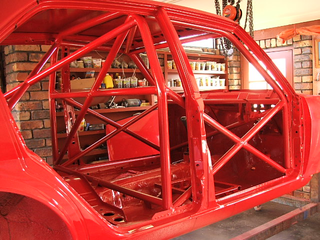

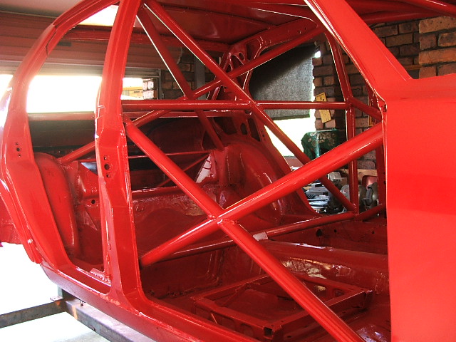

Here's and update on the cage..

MD: How tall are you? Do you actually fit in front of that main hoop? I wouldn't. Besides that it looks fantastic! :)
Edit: MD, Just noted that you do not have any pipes going straight back/down from the main hoop. That would never be accepted here and would not be able to race, also you would need the same going back/up from the bottom ov the main hoop and back.

We seem to have evolved two topics here which is bit naughty so I'll sneek this in 'cause I know it's just you and me lookin' at this.. :D
Unless I am not clear on what you said or you are not clear on what you see, there are two cross brace bars coming from the top of the main hoop and going down to the rear and fixed to the damper turrets. (see photo) I believe this is what you mean?
The bars you suggest from the base of the hoop going back are a possibility but a careful look at it suggest that the bottom sill section and the rear wheel arch combine to create the same triangulation and so the the addition of and extra member here will be a duplication of strength and just not called for. That's my story and I'll smack anyone over the head with 2kg schnitzel who doesnt agree with me.. :D :D

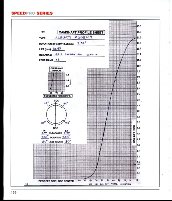

The cam suggested to me by two very competent guys in the game for my TS race engine was the Alquati 308/47. (Please see a picture that I stole out of JK book)(just trying to promote it as a useful reference JK).
As for the torque range, well it's never going to be a street machine, but to spread the torque as much as possible, you need to make the intake runners as long as practically possible and tune the exhaust system to the rev range you think you want the torque spread over...and don't say 6000 rpm !!! :D ( I know you are too smart for that, anyhow) Remember it's not a turbo so a big ID on the exhaust may work well between 9500 and 10,000rpm but it's not where you want to be. Small ID is good. If you can manage a range of 3000 rpm, that's workable. Once again, short primaries, small and peaky torque. Longer primaries, broader (and less) torque. Everything is a compromise..

MD wrote:Matts

@MD, off topic but can't leave it :D
That's my story and I'll smack anyone over the head with 2kg schnitzel who doesn't agree with me..
Ok, start smacking....
The body doesn't have a straight line there, so for force distribution not ideal.
So I wouldn't call it triangulated! But you created a virtual rotation point with the 2 upper crossing beam. One beam from the fi left bottom main hoop to a shock tower on the right would fix that.
What he said.
Also, I tend to agree with the FIA rules on cage design and discard anything that is designed with american racing in mind (jumps down in crouching tiger stance :lol: ), FIA rules are based on experience as well as engineering and works very well.
