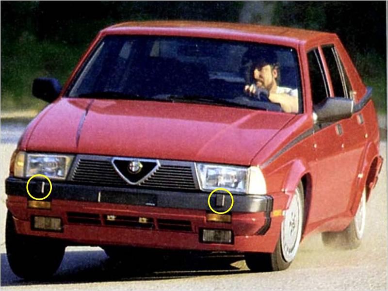

I think the stock suspension is not bad, I mean these cars are WAY more predictable than an E30 325is..you have to be on top of your game if you decide to lift off when cornering hard. But, as soon as you get to the limit in a 116 car, this picture happens:
As you can see, the rear tires are held up straight but what about the fronts? Also, when the body rolls as much as it does, the center of gracity shifts where you don't want it: onto the already overworked tires, which reduces the available grip. Another side effect of roll is that the front end geometry gets messed up, as you can already see in the picture. Basically, for racing, you want as little roll as possible.
