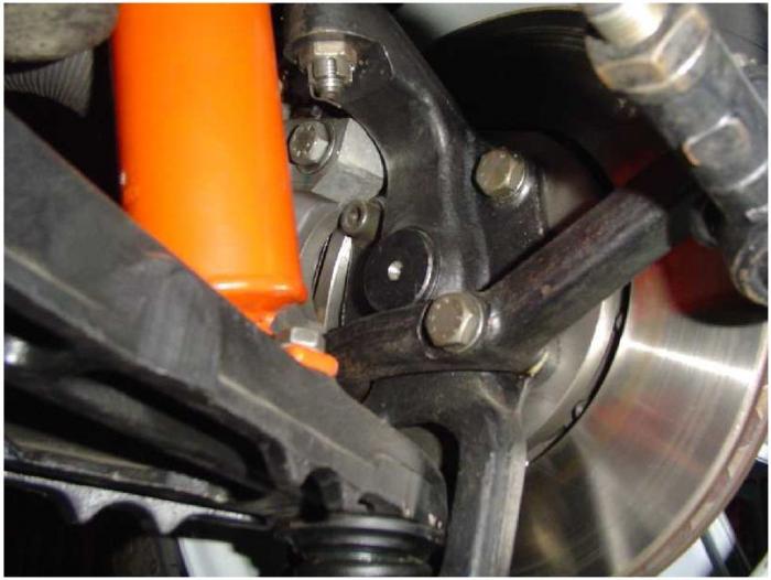

Found something you might like regarding your steering arm dilemma.

looks like a cast part right?
- Posts: 494
It's a 105 series front upright - they have bolt on steering arms, come in 2 different lengths and 3 different caliper patterns!

nicee, looks like it's a bolt on upgrade! do you know if these uprights are any taller than the std 116 ones?

from what I remember the lower ball joint of the 105 front is the same dimension as transaxle.
The 105, 1300 have a same bolt pattern for brake calipers as 116 with vented discs.
Many 105 guys search for these uprights to mount the aluminum brembo's.
And when going partly to 105 parts..... check the
alfaholics site expensive but nice looking stuff...
roll center / bump steer nicely changed....

So, this morning I took some quick and dirty measurements of my 2l 105 front uprights, and Daniel sent me a cad model he'd created of the 116 upright, so by comparing them the upright heights are about the same give or take 5mm, but the 105 stub axle is closer to the bottom BJ by about 1/2".. however with a flipped bottom balljoint this might give enough room to run smaller wheels than is traditionally done with the flipped BJ (and infact the pic showing the Alfaholics stuff is inside a 15" wheel). The big thing is that by eye-balling, flipping the steering arms side to side so a) they run downhill to the tie-rod and
b) the tie rod end is below the steering arm, it looks like it's getting close to the desired steering arm position, maybe even too low, which means you could lower the steering rack, and hence engine
