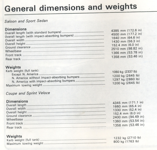

Guys,
I must admit I have only made reference to my Haynes Manual for this info and I hope it is correct because it makes some interesting claims.
For instance, the humble sedan with 4 doors and all weighs 172 kg less than the coupe with full tank of fuel. 1060 vs 1232 kg. Sorry to contradict you Micke.
The second bonus is that it has a wider front track by 6mm and is longer in the wheelbase by 110mm to provide a sweeter ride and less twitch on the limit than the coupe.
..food for thought? The flying brick is definitely my choice.
Apologies for the crappy reproduction
Haynes Manual Specs1.jpg (196.55 KiB) Viewed 10488 times
Difference in track is because the rims have different ET, the same can be seen on the different 75 models too.
I firmly believe that the 1060kg figure is not correct, that must be a typo.
However, I'm also convinced that the 75 body is lighter then the GTV. Not sure about Alfetta sedan though.
You could be right about a possible typo mats. Does anyone out there have any other references we could compare these figures to that comes from a credible source?

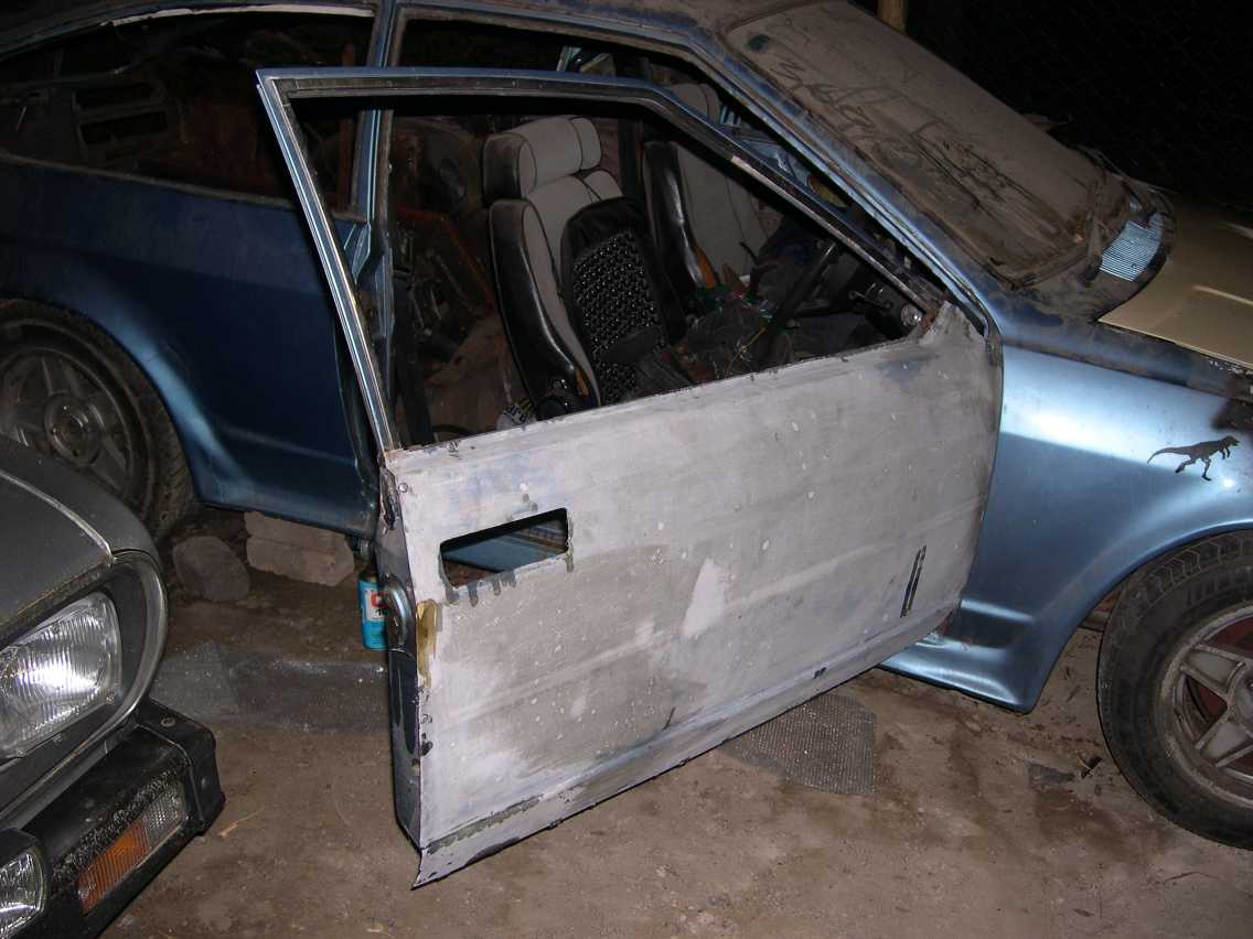

Just got an e-mail from a friend.Got his gtv door down to 8kg`s from 22 kg`s..
