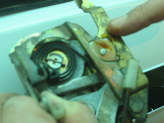

Assembled car yesterday with my oldman(70+yrs). Critical thing for me was the door locks. Nothing worse than coming aroun the corner and the door swings open. This has happened a few times on various GTV's in the past. I always thought it was the striker plate that got worn or needed adjusting when the door wont close but after stripping the lock down , I found it the return latch that stops the door from closing on the first of the two phases. A bit of grease or q20 sorted this out.

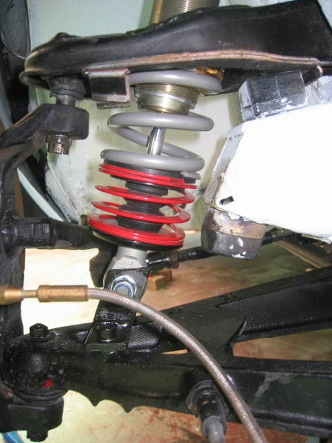

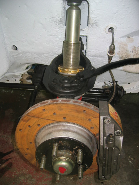

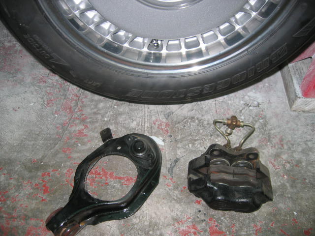

Got some real heavy volvo 4pot "budget ' brakes to use. Probably heavier than three brembo calipers. As Im only running 15' lightish rims Im sure its still lighter than most with their 17' rims.

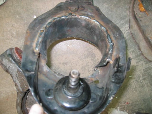

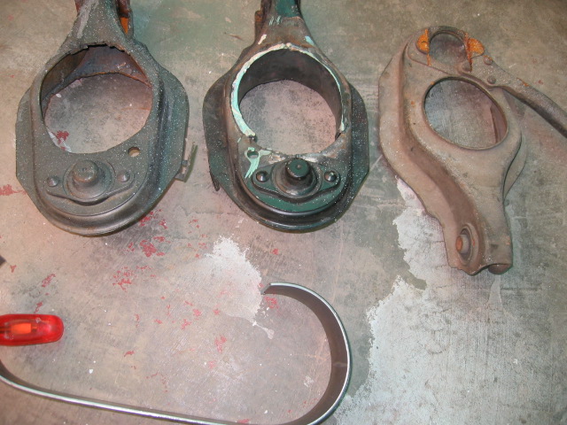

Also cut the upper control arms to give me more room when fitting the coil over. Its not neccessary but I prefer more room and only took an hour. Probably another to weld flat bar back in to get its strenght back.
Will do welding in new year.
Feedback welcome. (yes I know the roll cage should have been done before spraying but the pipe benders are closed)
Off on holiday until new year.

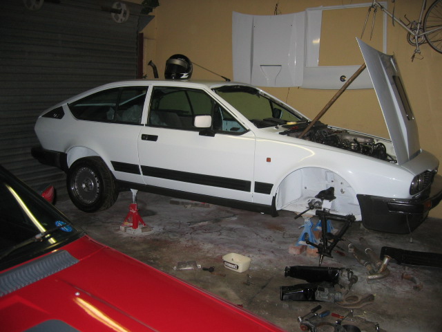

Car is assembled including electrics. This is definately the wrong way to do a budget race car hence i think thats why budget is in inverted commas. All the stress and hard should go first into suspension , brakes, motor and lastly bodywork , which you can slowly do through the season once the car is running correctly and you are having fun.
Pics of assemled car, coil overs , modified upper arms and race seat brackets to follow.

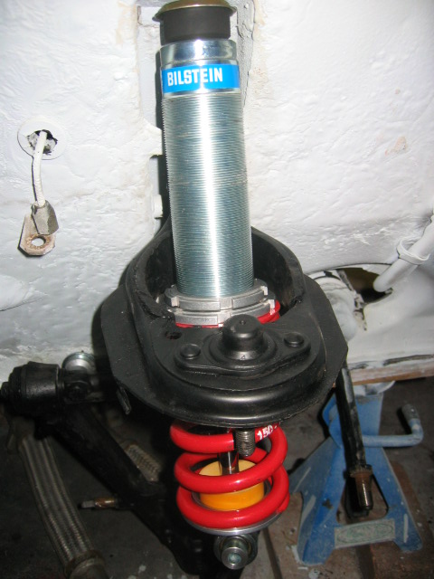

This car will be running with tosion bars in. I had a bad experience a few eeks back in the 116 3.2 GTV when one of the hats of the shocks came loose and the car fell flat onto the wheel. This was not an RS shock. Anyway point being is that our roads here are way to harsh on the coil over set up only( you have seen the road to Baz in the "other'). This car will also be driven to the track and not trailored.

The pics for the front lower arm assembly with Barrys' bearing set up were lost. Im sure Baz might havefew pics on his camera. However this system works well as there will be Zero play and it was far easier to assemble than original bushes.
I used the original bushes in the uppers arms as my polyurethane ones (bought locally kept working themselves out). If I was in Europe I would probably just get from Superflex. Unfortunately post takes forever. Still waiting for Dedion one from them(few weeks now).

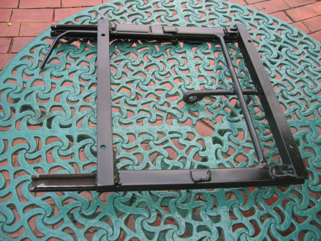

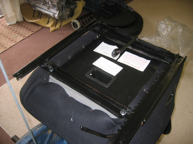

Next part was to get the race seats fitted to the original rails . Barry stepped in here and made a simple frame which does the trick. The rail was split & only the single part was used to give clearance between your head and roof with helmut on. Our regs in this class does not stipulate fixed positions.
- Img_2211.jpg (173.63 KiB) Viewed 11376 times
Pic of seat connected to rail. 3.7 24v in backround taking shape slowly.(not for this car).

A couple of questions if you don't mind.
The front suspension. What size T Bars are you using? Are they the original 23.5mm units? What is the size of the front springs. Is it correct that they are 150kg rated? What's the part number of the of the Bilstein damper and what are its bound and rebound settings?
Tip : Don't listen to everything Bazza says 'cause he'll lead you up the garden path to naked apes and wild women...
MD, The springs are 120kg. the 150 is the lenght. I will show it more clearly on another pic. These shocks are not a standard and they were made as a returned favour from a friend.(have to design a road for him -short one).
The T bars are stock 23.5.
I would have used 115kg front but there were none in the box so will make do with these. My RS set up with 115kg and stock T bars front and 50kg rear (in the3.2 GTV)gives great handling on the track for my level of driving(amateur). This car is very neutral on the track now the T bars are back in and its not to low to use on the road. Does bounce around a bit on bumpy roads but you have to obviously accept that .

As with most projects things chainge along the way. In this case I have put the full RS kit into this car to keep it only RS. The Bilsteins have gone into another GTV. No point in mix and matching. Got lucky with the brakes as the volvo calipers have been chainged with AP's from my Dads car. In exchange the 3.7 will go into to his car for a few months.
