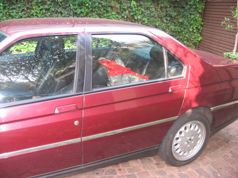

I have also been working hard on this mid engine project. The car is running very well but there is a severe clonking and ripping sound through fast right handers. Got a pic to show my progress.
On a serious note, there is a project on the go here in SA. He is hoping for a 10 sec 1/4 mile. He currently does high 11 sec in a GTV and its not a drag car. I will post pics next week when I see him. The motor is in already.
