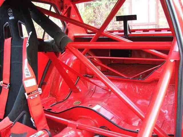

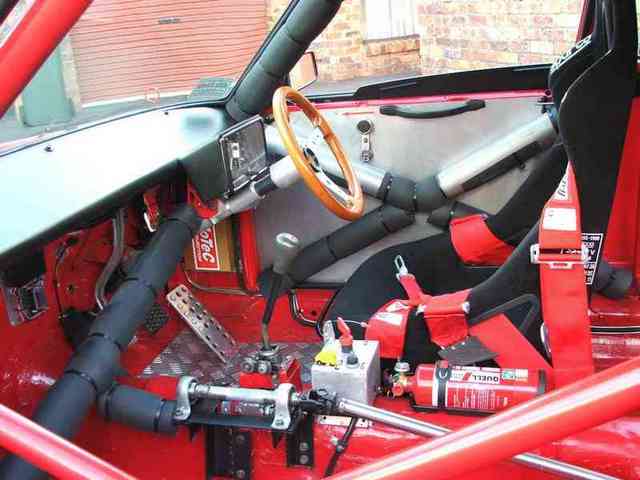

Here's a pic of the office..
- Brick interior layout.jpg (39.56 KiB) Viewed 7578 times
- Brick rear interior.jpg (39.41 KiB) Viewed 7578 times
