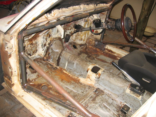

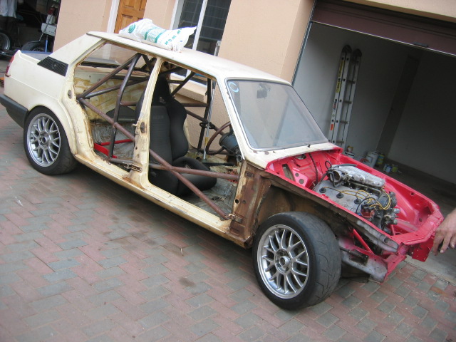

Frosti, here some pics of a Giulietta thats been built at the same time . It belongs to Domingoes brother Paul. Some good ideas for your roll cage.

Wow Kevin,thanks that helps alot VERY similar to what I had in mind to start with I like the fact that the side cross member bar runs tthrough to the rear shock tower point if that makes sense
Who built it for him ?

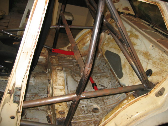

Frosti, how is the car coming on. Dropping another pic of the super lightweight giulietta.
