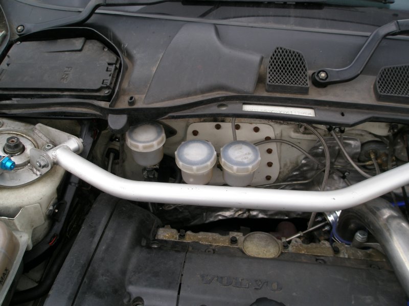

Cheers MD, that is really helpful. As you have driven the car in anger with the set up, that is all I need to know. I had the same with the Volvo, that I needed a servo, but it didn't. I just needed to get the right size MC's to work.
I'll go an find an MC from a Toyota and give it a go. Understand about the resevoirs, I'll sort something out.
This is what I did to my old Volvo

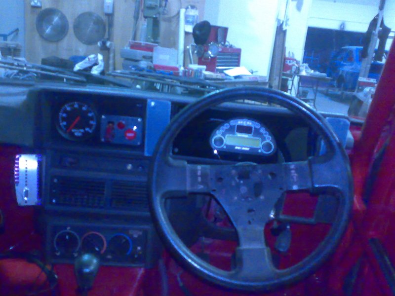

I've rewired the who car, striped the loom and kept only what is required. A Digidash is now install, which takes place of the dials and gauges. The unit has all the info you need, although I have install a normal rev counter.

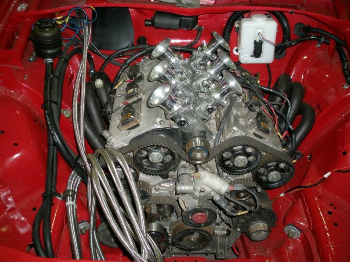

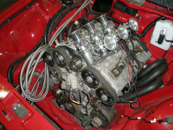

The exhaust and header hare custom, with equal primary's.

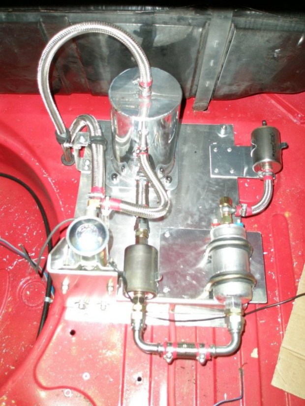

The AHM throttle bodies are in place, I just need to connect the fuel rails and hose. I have installed the fuel pumps and swirl pot in the boot.

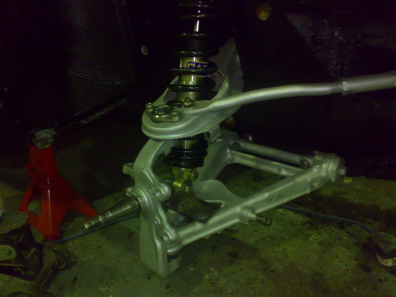

- The Leda front coil over
- Front leg.jpg (53.02 KiB) Viewed 9121 times
- The Digidash
- Dash.jpg (75.4 KiB) Viewed 9118 times

- Swirl.jpg (99.29 KiB) Viewed 9117 times
- Throttle 2.jpg (94.15 KiB) Viewed 9124 times
- Shiny bits
- Throttle 1.jpg (84.55 KiB) Viewed 9121 times

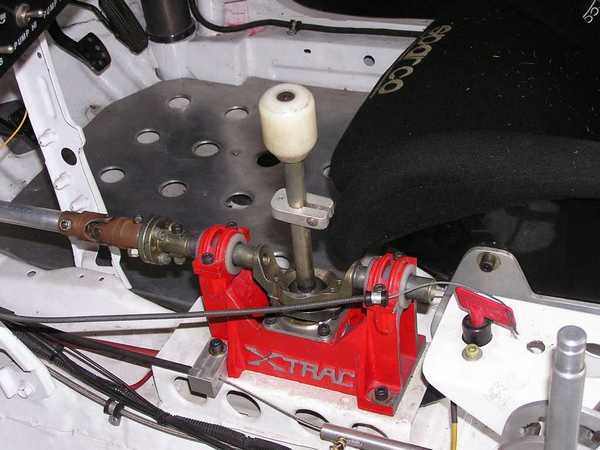

If you are going to this much trouble with modifications, why not install a proper shifter mechanism. I think these are made in the UK anyhow. The photo shows it being used in a front wheel drive set up but it can work in either configuration.
- Xtrac passenger side view 2a.jpg (30.51 KiB) Viewed 9104 times

Those throttle bodies looks always so so cool. Nice headers too.

The gear change does look good, I may have a look at that.

impressive exhaust manifold! Any photos of it when you were fabricating it?
Re: 75 Tarmac Rally Car build
I didn't make the exhaust manifolds / headers. A company called Powerspeed in ashford, Kent, UK made these and the exhaust system for me.
I'll post some more closer photo's if it later today.
Could you let me know how big the primary pipe size is? how much did they charge you?
The primary manifold tube is 45mm dia. and the exhaust system is 63mm dia.
I paid £1,300 for the the lot. The system is tight up against the floor of the car, and fixed rigidly on rubbers, so there is not much movement.
I could have had stainless for an extra £200, but I want mild steel.
