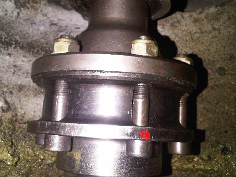

Greg, the guibo doughnut is an alfa part with the same coupling cage i use . The prop is a new addition to the car which means he did have issues in the past. I did get to drive the car and can tell you that it rattles like hell under 1000rpm from the rear cv. After that there is not a sound. The mechanics that came out with the car were worried about this and thought there was something broken. I realised these mechanics were just part of a team that serviced the cotsworth and the porsche 917 from same team so got them to calm down and told them this was normal. All the mechanics do that come out with cars is to change tyres , bleed brakes, put in fuel , change spark plugs. Anything else then its send car back to Netherlands. The car ran a closed loop motec which was bad idea with our fuels. They went through two lamda sensors to get car running properly. Main reason why we dont run closed loop. Our racing fuel here plays havoc with lamdas on aftermarket ecus.
By the way these mechanics could strip and assemble a csl bm in no time , so it all depends what team is sent to manage these cars when they race in foreign countries.

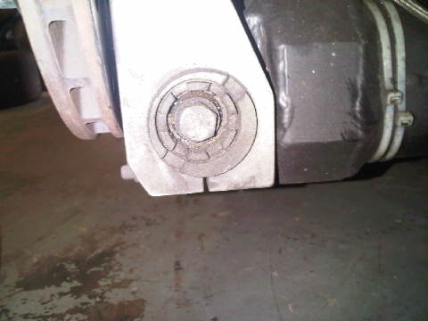

Some more pics
75 rear cam 9.jpg (22.94 KiB) Viewed 4714 times
75 rear cam 10.jpg (31.04 KiB) Viewed 4714 times
75 rear prop coup.jpg (30.53 KiB) Viewed 4714 times
75 rearcam1.jpg (26.06 KiB) Viewed 4714 times
75 rearcam 6.jpg (17.34 KiB) Viewed 4714 times

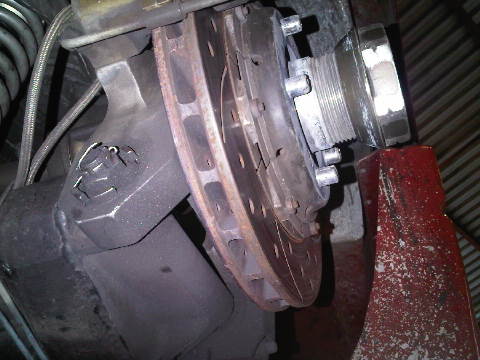

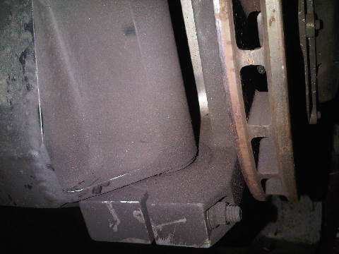

Re: IMSA 75 detailed pics (original factory car) at Swartkop
more pics
75 rear cam 3.jpg (19.05 KiB) Viewed 4714 times
75 rear cam 4.jpg (25.2 KiB) Viewed 4714 times
75 rear cam 5.jpg (24.76 KiB) Viewed 4714 times
75 rear cam 7.jpg (25.13 KiB) Viewed 4714 times
75 rear cam 8.jpg (22.75 KiB) Viewed 4714 times
