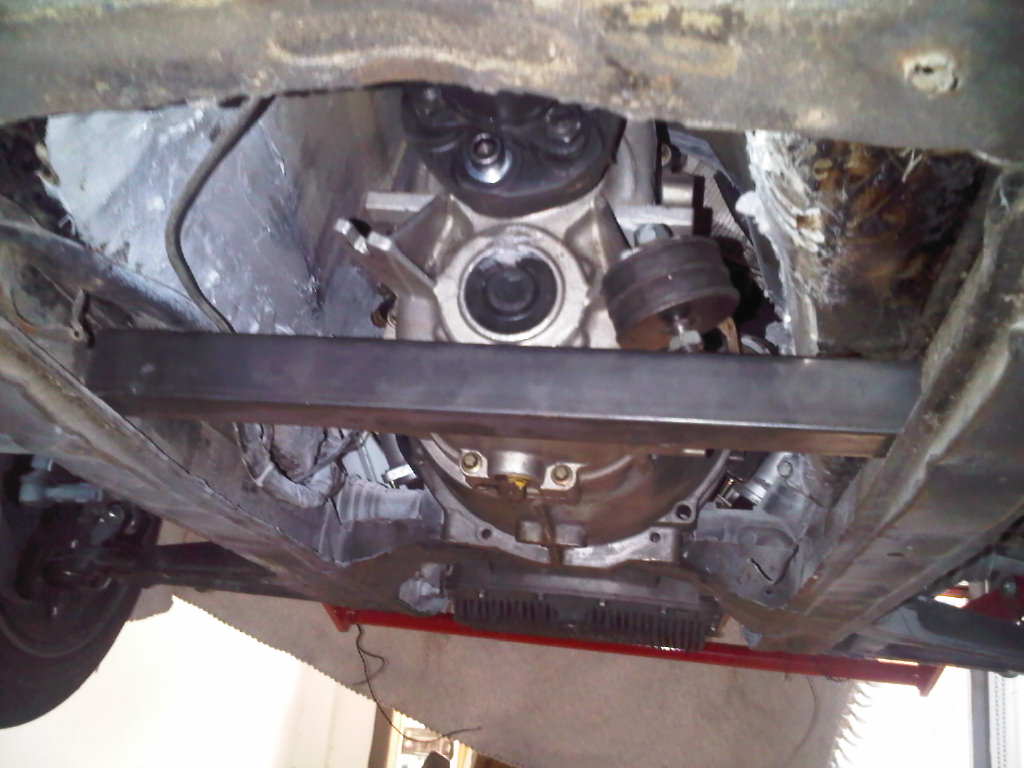

pic of tunnel cut fromE36 into gtv
- nelsontunnel.jpg (47.83 KiB) Viewed 14933 times
Re: Original GTV 3.0l race car build gearbox upfront (Nelso
That fits pretty good.
Thanks for the pic, please keep them coming...
My biggest interest at the moment is the driveshaft. I'm guessing they use a 1 piece shaft as it's only about 80cm long. But what do they do with the Guibo's? Both the beemer box as the Sei diff use a three legged flange for a guibo.
I'm looking into using one of the guibos to keep it's dampening effect for the driveline. The paln is to us the Guibo and the directly after it a U-joint. The part of the axle that slides over the pin that sticks out of the diff will get a solid bronze bushing so it will only turn but not move to the sides. On the gearbox side i'm going to make another u-joint that connects to the gearbox with a new flange. But if you can present me a better way to do this i'm all ears....
That's the tunnel in my GTV. uses the shifter mechanism of an Opel Omega gearbox with an arm adapted to fit to the bmw gearbox.
lot of work to build that tunnel, the E36 option would have been much easier.

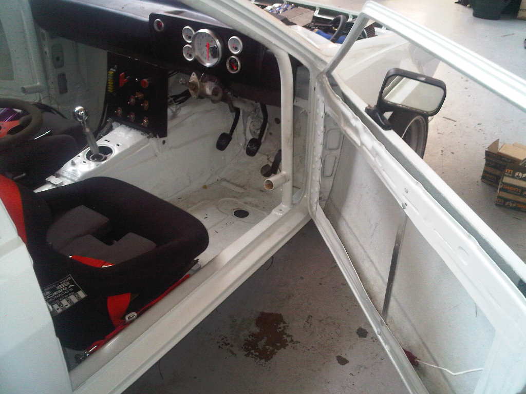

Some more pics as the car progresses. Tunnel neatly finished off. Note the back been rounded.
- nelsrear.jpg (69.06 KiB) Viewed 14809 times
- nelsinterior.jpg (66.87 KiB) Viewed 14809 times
- nelsfront.jpg (74.27 KiB) Viewed 14809 times
- nelsengbay.jpg (84.56 KiB) Viewed 14809 times
I am impressed. That tunnel work looks darn near like it left the factory that way. The whole conversion looks great, engine, diff, etc. The blue couplers look out of place. Red or black would match everything else on the car.
