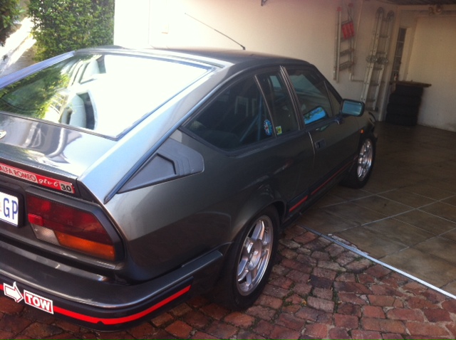

A few more things now completed, the normal ignition,tow, etc, stickers, and bonnet catches fitted AND!!!!! THANKS to Kevin... the PROP is sorted!!!!!!!!!!!
See some "final" pics prior to roundels and race no going on during the weekend..

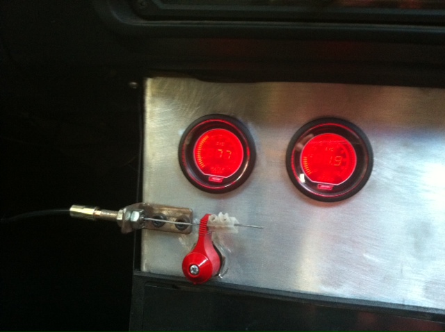

- did not realise that the gauges went RED after dark!!! - normally blue..
- photo32.JPG (89.99 KiB) Viewed 9474 times

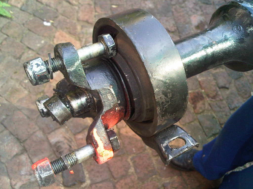

- the cuplrit!!!it WAS the MIDDLE BEARING!!!!!!!!!!!!!!!!!!!
- photo 27.jpg (86.24 KiB) Viewed 9474 times

Yeah that dam prop . It was the locknuts just behind centre bearing . They were tight but not tightening up the yoke so was fraction of play . This only made a noise at very low rpm or when you switched car off . Had to put a small shim then retighten then feel for play by hand . The balance machine could never pick this up or simulate the noise aaaargghh .

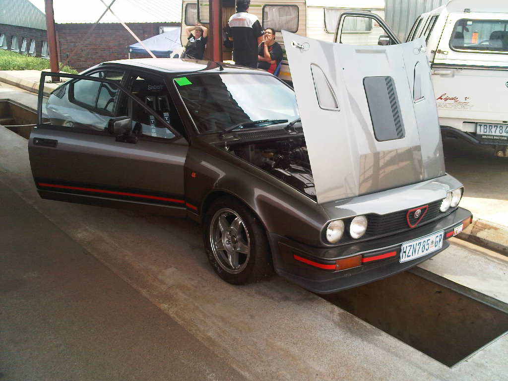

- Going through and PASSING scrutineering
- picture33.jpg (83.77 KiB) Viewed 9416 times

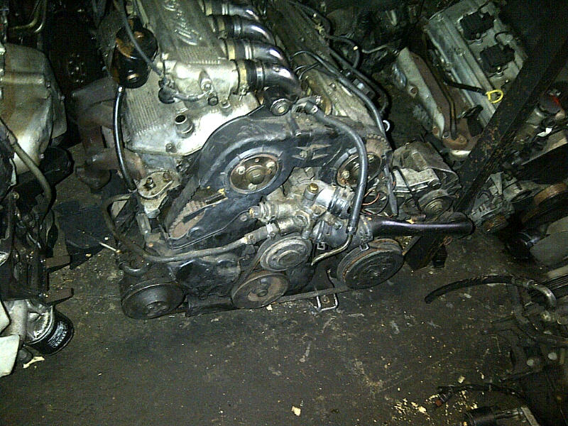

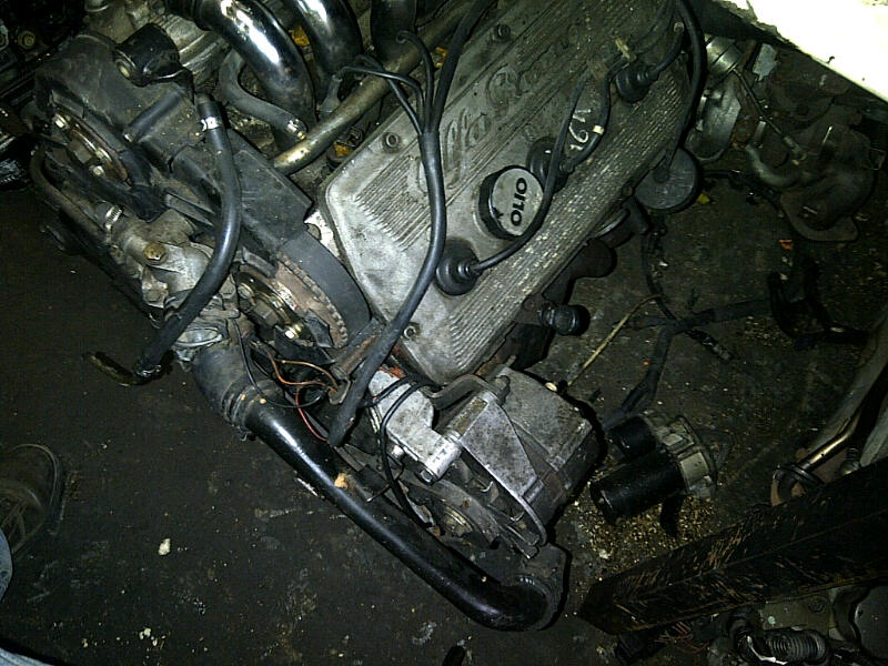

been a while since last post - anyway, have been searching for a 3.0lt motor for the car (as it is one of the original 3.0 South African cars) so I can try get it back as close as I can to spec.....
Thanks to Kevin and Dom, we have found a 3.0lt 12v Motor (unfortunately for now it will have FI) - s
So now starts the next "project" of fitting this motor - Hopefully will gte it done for the next race in 5-6 weeks - Will be posting photos as we move ahead.
In meantime find pics of the "motor'
I am really excited about this, as besides the extra HP, we are starting toi get back to "original" specs..
Tx again to Kevin for all his help and input - appreciate!!!!! - and Dom for the Hard work!!!!!!
- 2nd pic of motor - eeds a good clean!
- motor 3.0 b.JPG (146.44 KiB) Viewed 9054 times
- pic of 3.0lt motor
- motor3.0 a.JPG (121.48 KiB) Viewed 9054 times

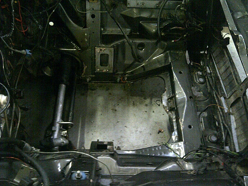

The old motor is out, and we decided we would also do some additional "mods" and clean up...
so here find some pics - the new motor should be in during next week
A small progress update and some pics....

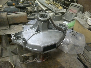

Hi
some more pics of small progress

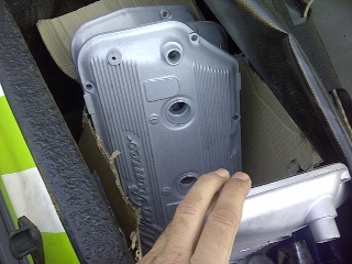

- Modified and strengthened clutch housing
- clutch housing3.JPG (45.78 KiB) Viewed 8950 times
