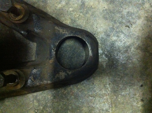

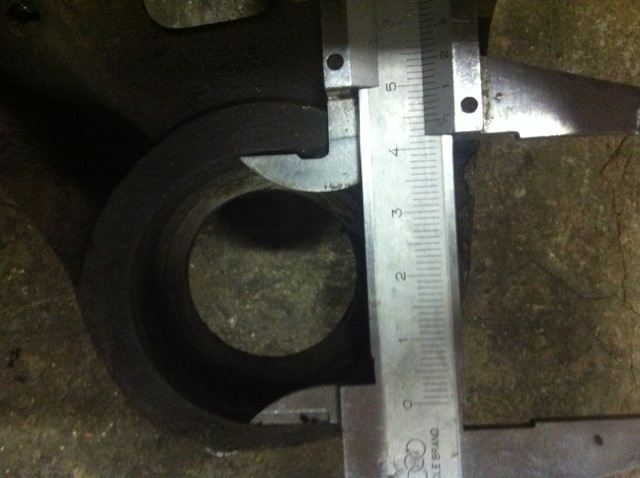

Here are some pics and dimensions of the ball joint. I've removed the rubber boot to give us a better view. It's 44m diametre fit into the LCA. SO it leave enough meat on the LCA.
- Measurement of the LCA bottom view 44mm
- IMG_3817.JPG (84.64 KiB) Viewed 15537 times
- bottom view of the LCA
- IMG_3811.JPG (113.71 KiB) Viewed 15537 times
- ball joint bottom view
- IMG_3810.JPG (70.55 KiB) Viewed 15537 times
- ball joint side view
- IMG_3808.JPG (71.37 KiB) Viewed 15537 times
- ball joint top view
- IMG_3807.JPG (67.9 KiB) Viewed 15537 times

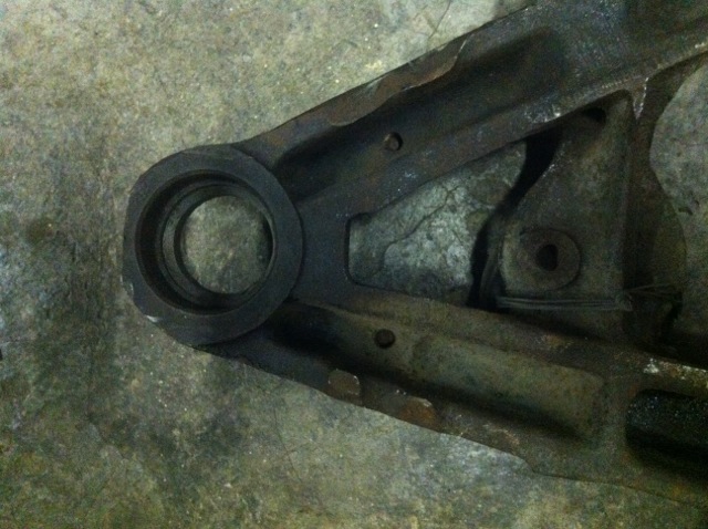

more detail on Ball Joint and LCA
- top view w]of LCA with measurements were its been machined
- IMG_3816.JPG (96.61 KiB) Viewed 15536 times
- top view of LCA
- IMG_3815.JPG (118.99 KiB) Viewed 15536 times

That's exactly how i pictured making it..
Now w ejust need to know where the balljoint came from.
44mm is almost stock size, strengthwise that should not be a problem.
I must say my Volvo balljoint looks alot stronger due to its size.
To bad the LCA won't accept it.
