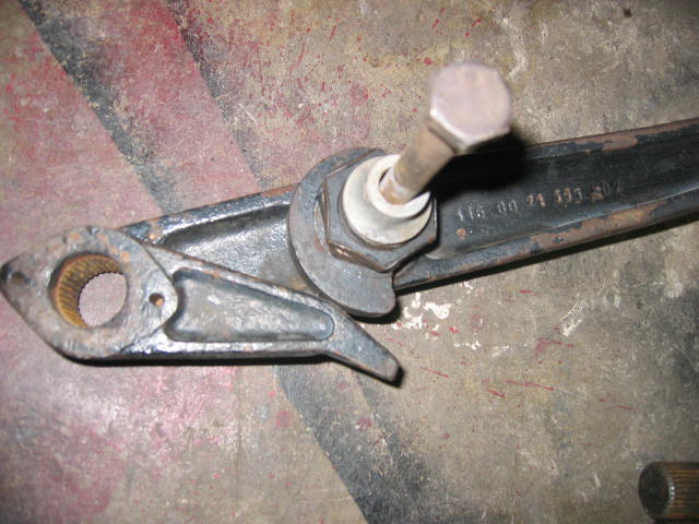

top view. This part is nearly 100% identical to the ones on the scuderia del biscione site.

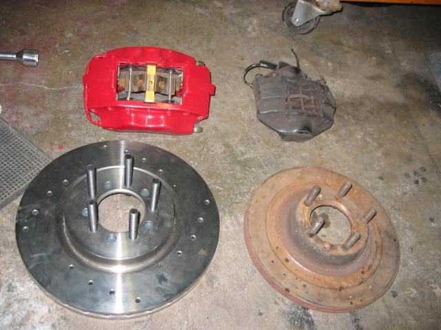

The front brake upgrade has a difference of 4kg each side.
Does anyone recognise this part. Its definately a cast factory part.
Cool, adjustable bars!
Yeap, definitely recognize that part. Forgot the website address, but it costs a lot of money, something bianchi . com or whatever.
Found it:
http://www.bianchi-kopp.de/BK-041001/bk ... 50607.html
But the adjustment method is not exactly the same as yours. The Bianchi Kopp uses the thread of a bolt to hold the adjuster in place while yours uses what looks to be a cam. You lock down the "cam" and hopefully the bar stays in place.
Looking at the stamp it's probably not a copy but the original Autodelta part.
I heard it was an origional autodelta bar but most people here dont recognise it . Cam realy works well and cannot slip. Worked well in a friends track only car for many years until he upgraded to coil overs. Anyway thanks for response. Was there ever an old catalogue from Autodelta ?

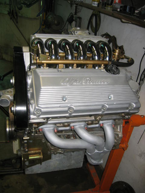

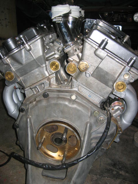

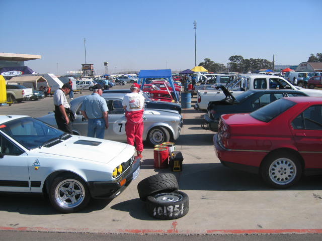

So far the 'budget race' has done very well this season. I have not upgraded with bigger brakes yet but that will come when i put the 24v motor(not budget car any more). The changes coming into todays race was AP600 brake fluid and special race pads that a supplier made for me here. Definately to noisy for road but absolutely brilliant on the track(just incase anyone wanted them for road as well.) Bottom line , the car is really competitive and precise to drive. Two pics to follow, one of the pits today and the of the new transplant engine.
The new transplant motor. Barry check out the oil filler cap.
