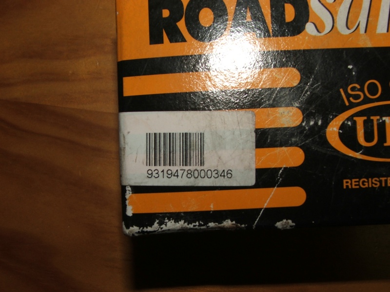

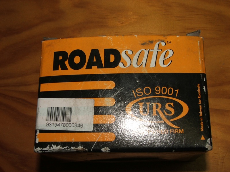

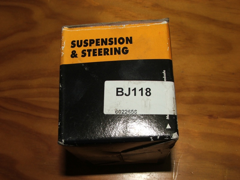

OK Guys, here's some info but you will have to do some digging yourselves regarding the dimensions. I suggest you contact the vending company and ask them for the dimensions of this ball joint (specifications) quoting the part number I have supplied in the photo.
Website : http://www.roadsafe.com.au/products.html
- Roadsafe brand ball joint 1.jpg (137.88 KiB) Viewed 8564 times
- Roadsafe brand ball joint 2.jpg (135.34 KiB) Viewed 8564 times
- Roadsafe brand ball joint 3.jpg (142.36 KiB) Viewed 8564 times
Hey Remco and others interested,
I just talked to a buddy of mine who is a huge classic opel freak, and he confirmed that holden gemini, and kadett c share the same platform suspension etc. I also had a look personally at the lower joint - the pressed part is plenty enough, after all that's what MD has. Also I don't really see how to mate it with LCA without any sort of sleeve, but that's no problem, really. What I'm interested Mike how have you modified the spindles to accept different joint? Any pictures from the build would be awesome

Hey Pete,
i just emailed that Aussie firm to confirm it but they couldn't say if the kadett was the european equivalent...
They had the balljoints in stock and were willing to ship them. I mailed them back asking for the dimensions but haven't got an aswer just yet.
Will let you know what they say.
The Opel joint is some 2 mm smaller. I happen to have a friend who owns a few, including one with 2.0 16v turbo engine from Opel Calibra.
