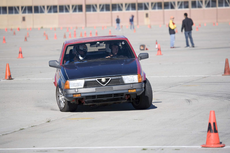

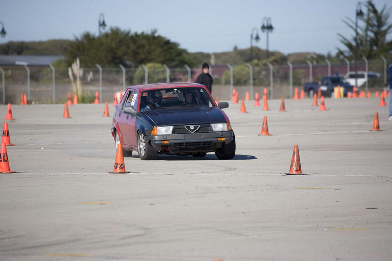

If you look in the introduction forum, I posted a picture of my car going around a medium hairpin. It's obvious I have positive camber and am probably losing grip here. It makes sense, because for this turn, the understeer was greater and my grip felt less than on the other turns.
I only have 27mm torsion bars so my chassis rolls a lot. My camber settings most liekly won't work for you. You really should buy an infared pyrometer (like $40 US?) and take a look at the temps. If it is more than 15 degrees hotter on the outside overall all than the inside of the edge of the tire, there isn't enough camber and you could be gaining some grip here.
The caveat is, as you know, that sometimes the best tire temperatures don't = the best lap times because you need to have a flat tire on the road to get the most braking force.
Similar thinking works for the rear tires in the case of acceleration. My hunch is that for me, I should be running around 3.5-3.8 degrees of camber for the best lap times on a medium speed road course, but my car is a daily driver so the tires have to last.

Nope. I say this because in the pictures I've seen of my car cornering hard, I could be benefitting from more camber with my SOFT setup. Obviously 30mm T-bars/RS Kit will change this.
Also, stickier tires will make my roll even worse. I can't say for sure, but I think optimal for me would be greater than 3 degrees.
What do you think? I think Jes is on the right track too, but pyrometer blah blah blah.

Ben: I don't see how there is even a remote way to compare slicks to "R" compound tires, the carcass is completely different. But I sort of see your point anyway.
grant: Infrared pyrometer suck and should not be used on tires, you need a probe type meter or you won't get accurate readings.
Also you need more caster for a start, as much as you can get, this will give you quite a bit of camber change in those hairpin turns.
