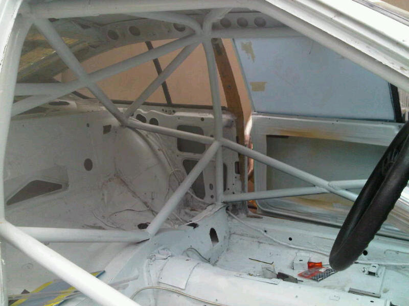

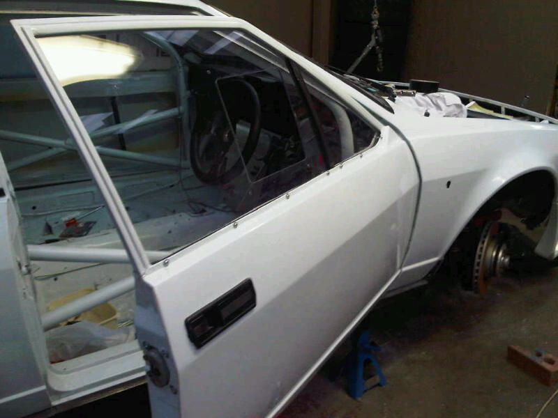

Another of cage finished. I have welded cage to body and roof at six points as well.
- racecageA.jpg (63.29 KiB) Viewed 7980 times
Got drivers window in today and finally got fiberglass doors right. The only problem with the fiberglass doors is the polycarbonate windows tend to pull the window frame straight which they are not. I used to have one pice windows but made it into two piece with stifner from origional which seperates main window from side window.

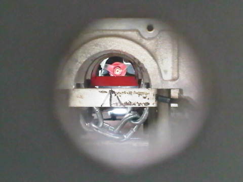

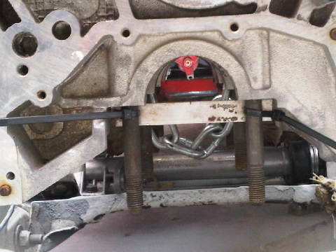

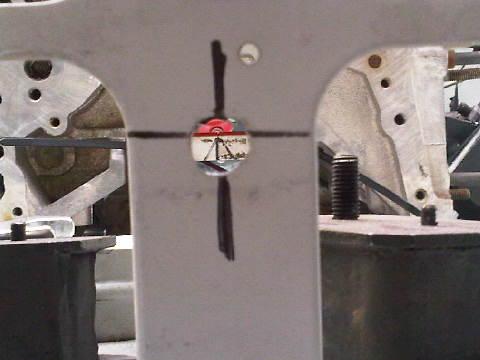

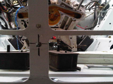

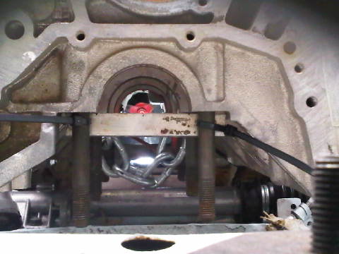

As mentioned earlier I have made new engine mounts to make the engine sit straight in the body. I got an empty block put my new trial mounts on. I them made two sighters like a rifle or in building (boning rod) which i attached to block through the center. I removed prop and made sure gearbox was mounted in its correct position. I put luminoous paint on center of yoke on box with a torch under neath it. I then made a whole in center of front valence with which i could sight right through to gearbox. Apart from lining it up I also determinined what angle the engine sits in the engine bay.
This probably all sounds confusing but it did work. ps i did try a laser at the end to double check
I have also completed an engine stay along with realining bell housing rubber bush and center bearing mount.
The IMSA 75 bellhousing mounts has given me some ideas but I think that was mainly done to allow one piece prop out.

- centreline1.jpg (28.57 KiB) Viewed 7915 times
- centreline3.jpg (28.62 KiB) Viewed 7915 times
- centerline2.jpg (25.87 KiB) Viewed 7915 times
- centreline4.jpg (20.47 KiB) Viewed 7915 times
- center line5.jpg (14.82 KiB) Viewed 7915 times

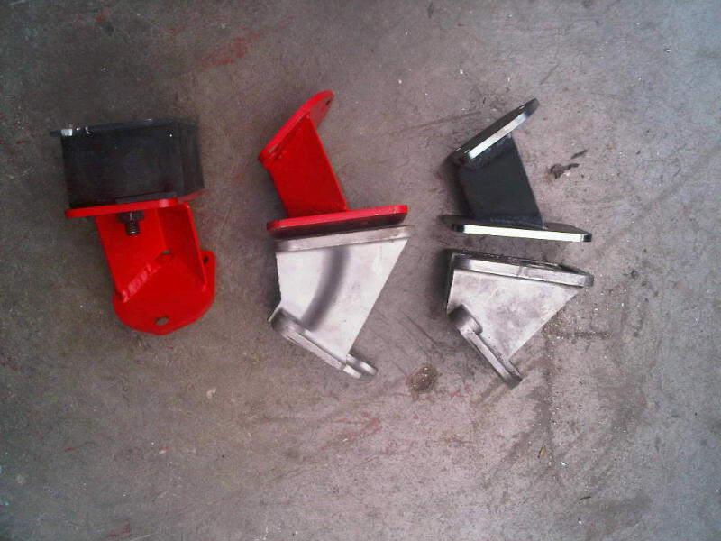

Z if you take two old mounts of you can see how far out they are. I will post some pics and measurements
You only need a laser and some way to fasten it to the flywheels, then when you spin them it will draw a circle that is concentric with the crank/clutch shaft.

Md, mats is was pretty easy to get the engine horizontal. As from pic i had two sighting plates attached to the block. An aluminium one on journal one and a red one on journal four. If you line up these two and while sighting on the centre of gearbox you can get the engine vertical. But at same time using a square on a gearbox you can see if the line from engine is square to the yoke. Its not that difficult. Probably more difficult to explain. Rear of gear box then can be adjusted if neccesary. My first priority was to get engine straight to protect prop .
All the chassis pickup points are perfect . The engine is off 15 degress . The bellhousing bush is offsett 10mm.

Zamani, a pic of the mounts. There is still a left and a right mount. The offset across the mount is 8mm and the and angle is still the same as the original mounts. The new lenght of the is the average of the original two mounts.
- enginemounts1.jpg (73.75 KiB) Viewed 7810 times

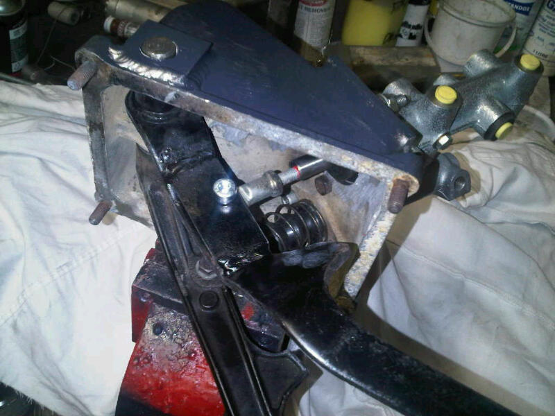

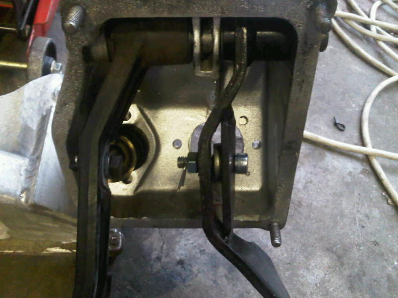

My pedal box using another clutch pedal for the brake pedal. Using a 21mm master which works for my large calipers.
- pedalboxback2.jpg (69.87 KiB) Viewed 7810 times
- pedalboxside1.jpg (76.61 KiB) Viewed 7810 times

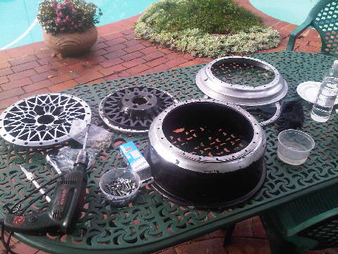

Even rebuilding my rims. The siliconing had to be redone.
- rebuildingcomps.jpg (46.17 KiB) Viewed 7809 times
