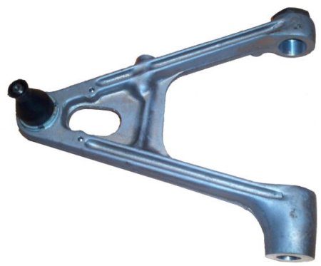

In case you feel like doing the expensive thing: http://www.subitocorse.com/index.php?op ... pathway=21
- img_0739_3.jpg (16.54 KiB) Viewed 9108 times
Nice find Duk but the price resembles a telephone number...it's off the planet !

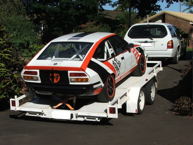

Here we are getting ready to go to the dyno shop again to finalise the tuning.Hope the Cab stays in one piece.
- Final dyno trip.jpg (144.44 KiB) Viewed 8963 times
Md , that's alfa art deco at it's finest. You actually have to look it the car for a while to get it. Rather bold . Any budding architects in your house.
Geez only you could cross brace your tie down straps
Haha, thanks Kevin. Yes I had the trailer built so it can be tied down with a cross configuration front and rear. I have also installed tied down points on th car itself to facilitate that. The orange tie down straps ad the final picture!
As far as the graphics go, well, I figured if we can't get attention from being at the front, we may as well get some for presentation so the appearance is to get some fun value. Being a 1978 model, the Cab is an old girl but somehow the graphics make it relevant to today so I am happy with that. The graphics certaily look "busy" and I think that lends itself to position the car visually as ready to do the business (if you know what I mean). I had a lot of fun doing it. Given enough development and improved driving skills, it could be at the pointy end one day but for now , reliability with all my changes is the first priority.
After secondary education, architecure was my first university choice but I got side tracked. Nevertheless, if and when I build a new home for myself I still design, build, and do the fit outs so your presumptions show great insight.
