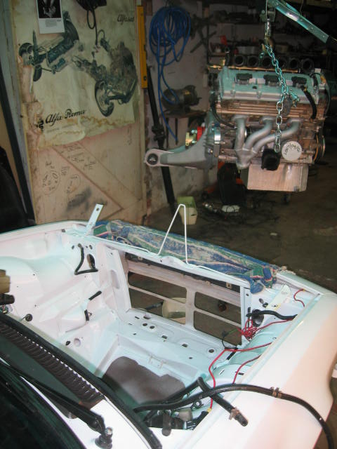

Decided on Friday to take the 2.5 motor out. Its been a brilliant engine the whole season and not missed a beat apart from water getting into the computer box down the harness. Once engine was out I steam cleaned the whole bay as this the only part of the car that never got painted. Started tp prime early Saturday morning and put on final coat at mid day. Good thing it was a hot day as we(pops and me) managed to get engine in. Paint was still a bit sticky but we only have this weekend to finish it as there is a race next Saturday. Some pics to follow.

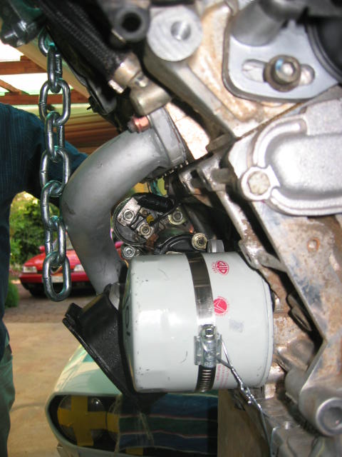

This is the 166 3.0 motor going in.

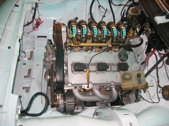

More progress to day.

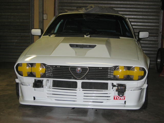

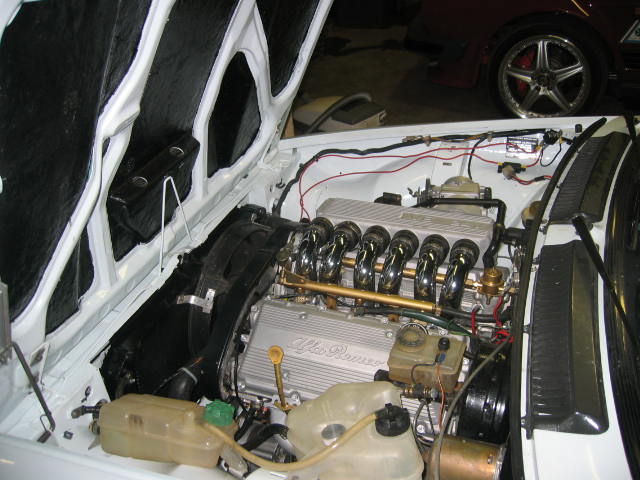

The double water bottle is for overflow(in our regs). Decided to put an origional GTV3.0l bonnet(hood) with spoiler on. Pic not so clear as sun is down and car is complete except for mapping which will start on Tuesday. Who knows if this will all come together for Saturdays race if not there is plan B. Front bumper still to be put on.
Close up view of sump wiring and oil filter.
