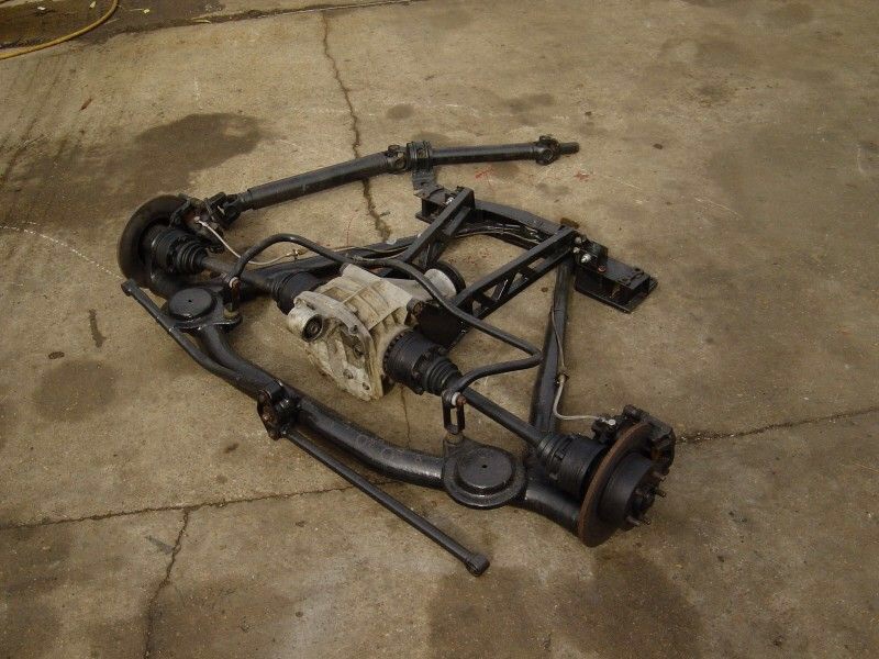

Some pics of another front mount set up using Cosworth diff and box . Thanks again to Nick for sharing pics with me .
I think this cradle set up is the best way to go if some one is going to do this conversion . I would then use the BMW 7 series diff as they are many ratios to choose from and cheap .

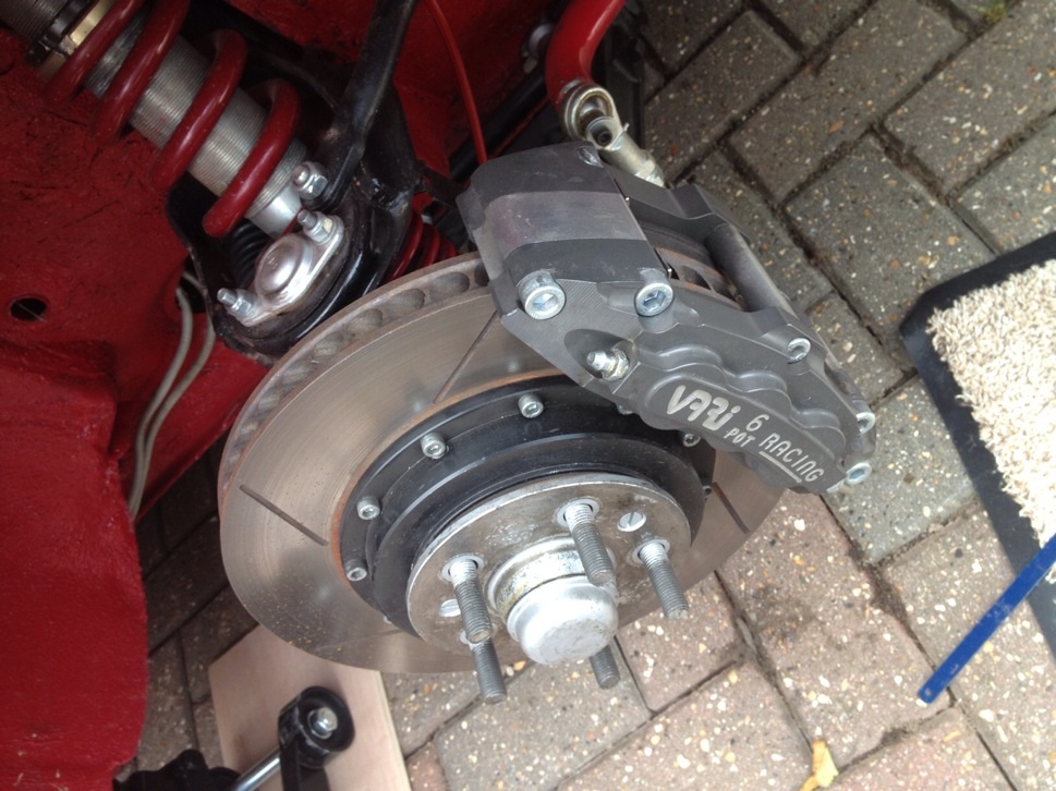

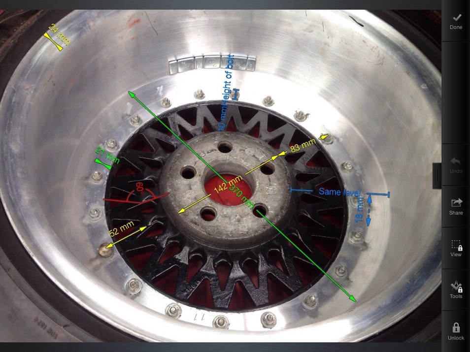

Even though my race set up brake design 290mmx28mm disc with six pots fit perfectly in the 15 " compomotive rim as in pic I have found someone to remake this compomotive design for me in a 16 " rim . I will then run a 225/45/16 semi on a 8J which will suit my ratios and the wider wheel arches .
The replica centre hub will be identical to the 15 " but just with bigger in and outer dishes .
Their had been interest from a few of my friends to make a perfect replica 15" set as second hand rims have got so thin a actually are dangerous . Plus import costs from SA are pretty horrendous .
I did not realise that this compomotive design was so sought after but then it was a genuine Alfa Romeo Part number in the SA factory and was specifically commissioned with that offset for racing when they designed the gtv3.0 back in early 1983 .
If anyone is interested drop me a pm as this is not a place to put pricing . Also no profit is being made but just to help spread costs of the CNc work . The wheels will be made by a reputable manufacturer as well who make a huge amount of rims for racing .

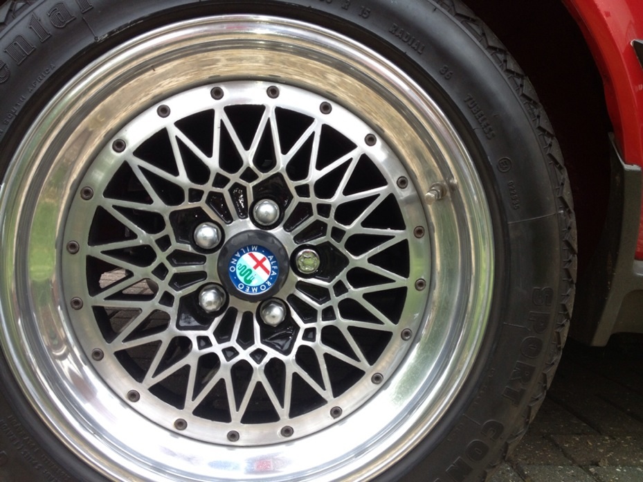

Pic is of Ewen at my place with his awesome 3.5 parked inbetween the carbi and the race car . He was checking how much clearance their was between three caliper and the bolts inside the rim .

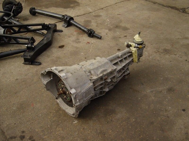

I have another automatic 119 diff with me which I will put . Here are some pics of the Alfa Sei diff ratios for those who are wanting to use one of these . I have also included the BMW ZF ratios which are common through the range including the E36 M3 and the E46 328i

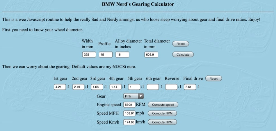

I found this site a for quick calculations but just change the info in the blocks
http://www.unixnerd.demon.co.uk/revs.html
And with my tyre size of 225/45/16
Note I'm using 5500rpm benchmark as its a 3.7 and no need to really rev more on the road .
My speeds are at 5500rpm in each gear give me with the 4.27:1 ratio
1st -35km/h
2nd - 59.37 km/h
3rd - 89.05 km/h
4th - 119km/h
5th - 147km/h
And the automatic box of 13/47 ( 3.61:1)
1st -41.53 km/h
2nd - 70.26 km/h
3rd - 105.34 km/h
4th - 153.39km/h
5th - 174.86 km/h

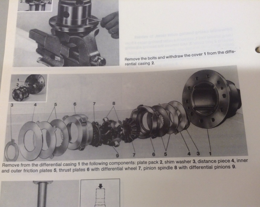

I'm going to pull out the LSD on my Alfa 6 Diff . From the the manual pics it looks like 45degree ramp angles for accelerate and coast which I'm happy with as its a road track car and will be doing quite a bit of wet weather driving .
Now I need to service or change clutches but I can't find any info on the the preload setting . Only once I take out the inner and outer friction plates I will be able to measure them and then search if these parts are avaliable or try match similiar .
If I can't get exact friction plates what preload setting should I look at if I must change the shim washer ?
Secondly if I can only get friction plates with with same internal diameter but slightly smaller outer diameter . This will probably bring the percentage lock up or bias down a bit .
Lastly is there away I can check without stripping and micing up the friction plates to see if they are worn ? Note the diff is out on the table already .

Don't be afraid of opening the diff, it's very straight forward. Check the parts, then you will know.
Preload will give you understeer but a more predictable behaviour in the transition between coast-drive and the opposite, passing "neutral". More preload means more wear -> more service.
